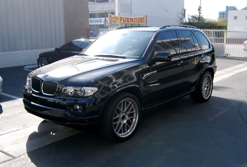

I have BBS RXii's on my CTT. They are all 21x10.5 and all running 285/35/21 Michelin Diamaris Tires. My question is, can I run the 325/30/21 on the rear with the same wheels? Will it mess anything up? I will keep the 285/35's up front on the 10.5's and run the 325/30's on the rear with the 10.5's. If possile, and safe, I am going to order the tires.

not the best option but yes u can do it.

same exact set up on the X5.
285/35-21 & 325/30-21 on 10.5''s

i didn't say it's bad, but we do things for a reason. if the look is ur main concern then go for it! my take was u're running 4 same size wheel there is no need to go with different size tires. good thing is the Michelin Diamaris 285/35-21 & 325/30-21 have the same overall diameter of 28.9, that's one most important thing u need to watch out but seems like u'll be perfectly fine.
i have some pics but don't have a direct shot. hope u can get the idea.

one more~
