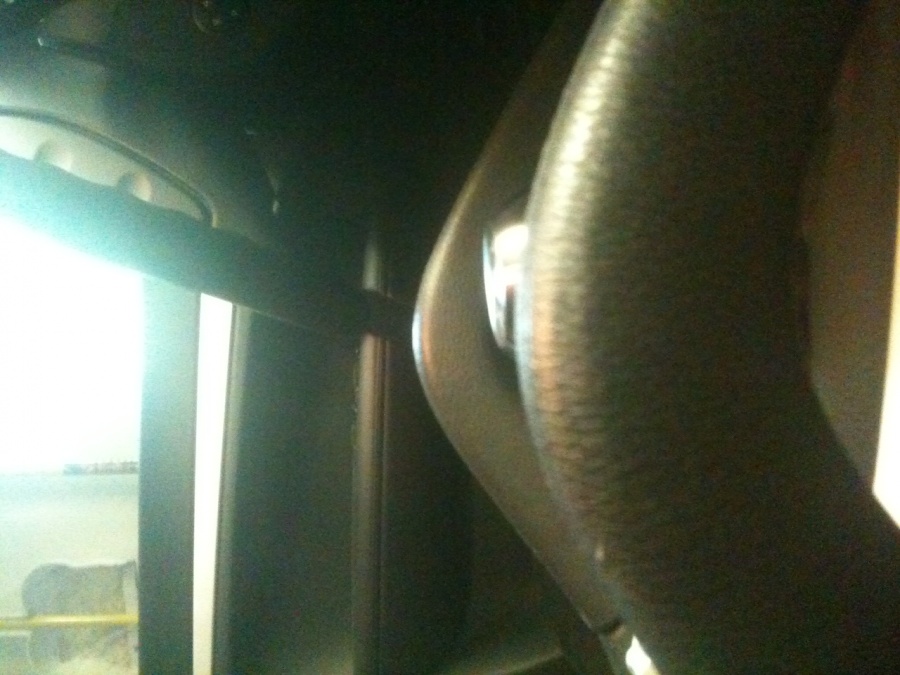

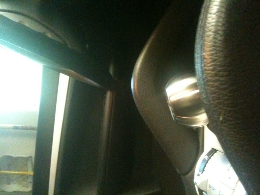

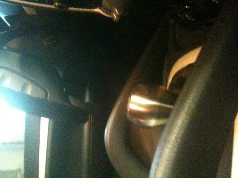

I made my own, I thought the factory shifter was both to high and to long, so I had a custom clamp fit shift **** made (Audi Clamp style works) and cut 2 inches from the shift leveler then ground off the wings. It now shifts smother then before an is a perfect fit. I did use a 2lbs weights **** though.
I can go into details and since in final pics if your interested.
Robert

Paul,
Sorry for the delay, i managed to get sick last week.
So first I want to say I like short, really short/low shifters, so you might not want to go this low, and second shortening the shifter make the useless cup holders even more useless.
I am assuming, that the top of the center counsel is removed. The shift **** was stuck so I had to cut off the shift ****, so i can't speak to how to correctly remove it, but it requires a lot of pulling an from what i hear a catches mask to protect the face.
Once the shift **** is remove everything else is ease.
  1. Ensure the parking brake is on.
  2. Determine the height you want the shift **** to be, the shorter the height the shorter the throw, but the notchier it will feel.
  3. Remove the 4 bolts holding the shifter assembly in place.
  4. Place shifter in neutral
  5. Lift out the assembly and unclip the 2 connectors attached to the shifting cables, the assembly will com out but its a tight fit and requires twisting and turning.
  6. Determine where to cut off shifter shaft, rememeber to remove extra to account for the height added by the shift ****. I use a hacksaw to do this step.
  7. Now to remove what is left of the wings, I did this with a bentch grinder. To ensure that nothing is damaged i did the following:
    1. Wrapped the assembly in a plastic trash bad an taped it closed. I wanted to ensure no filings got into the housing.
    2. I then got a 5 gallon pail and filled it with water so that I could cool the shifter's shaft.
    3. While grinding I kept my hand on the shaft at all times, so that i would know as it started to get warm, i did not want to damage the plastic housing so i cooled it often.
  8. Once the wings are removed, I tested the fit of the shift know and continued grinding until the shift **** fit.
  9. I then smoothed things out with a file
Here is a link tot he shift know I purchased, but any Audi clamp style should work:
http://jhmotorsports.com/shop/catalo...340369c5159c8b
