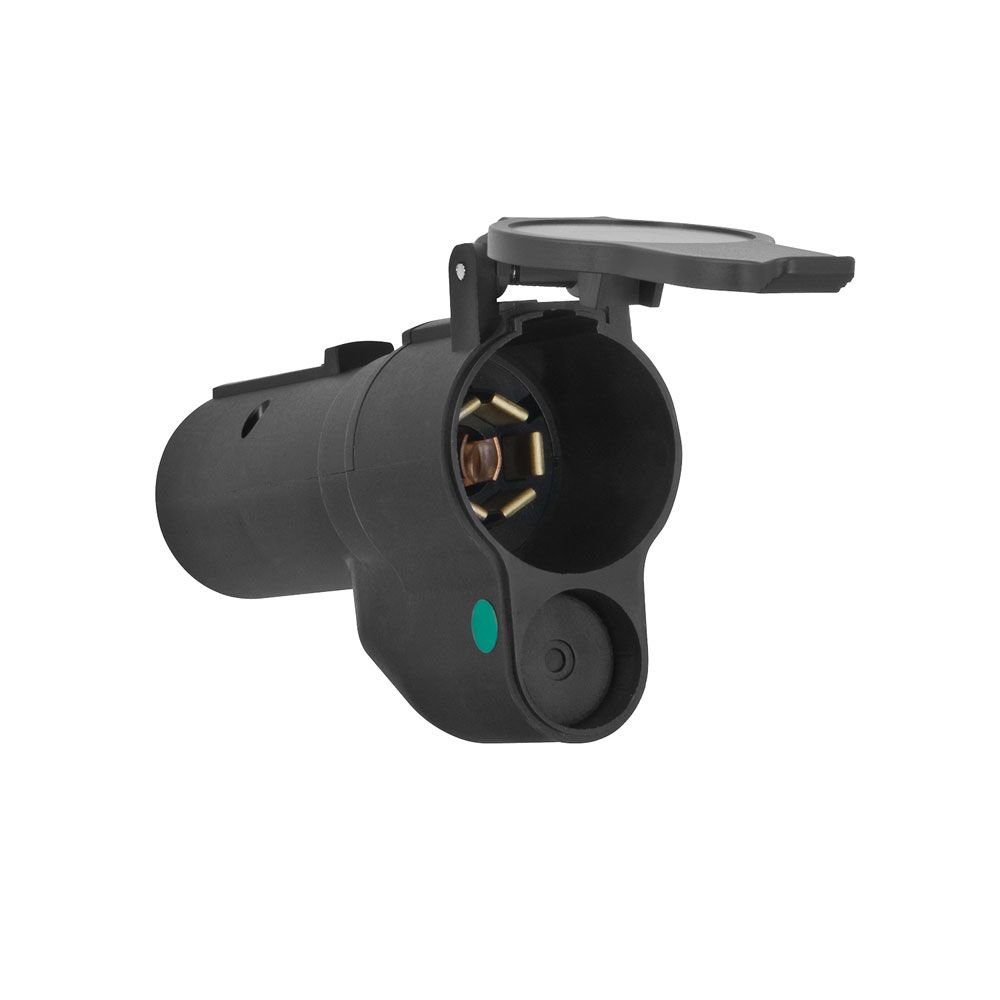

However old the thread is, the problem persists with Cayennes, Macans & most other Euro & Brit tow vehicles with the light out software.
For the USA & Canada they usually need to use a regular 7-pin connector with a 7-pin Bypass Adapter like this Reese:
https://www.reeseprod.com/product/20142_trailer-connector-adapter-7-to-7-way
Just in case someone else reads this now that GT3 Chuck has reopened it with his post.
