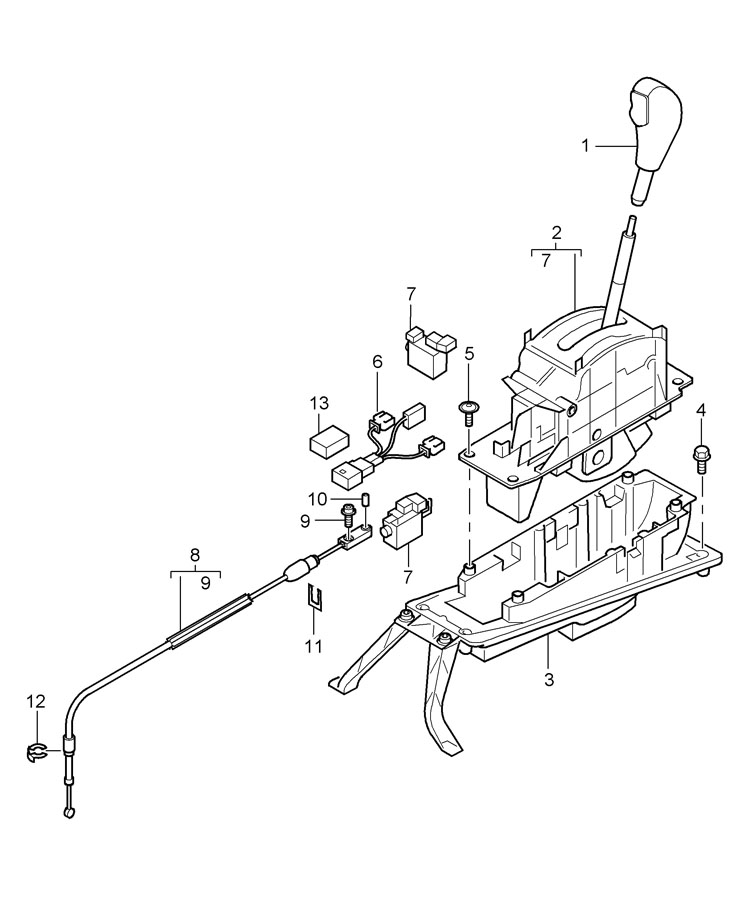

The dealer called to tell me that the cable on the image below is what broke. Now I need to find the part number that corresponds with it and see if their asking price of $228 is in line. Now, the $338 installation, well, I may have a solution.
So, anyone know the part number for the cable pictured below?
Update: that cable currently costs $160.62 @ Suncoast. The ex Porsche head mechanic has his own shop and charges $250 in labor to replace the cable.

$138 at porscheoemparts.com
part number is 95542603311

On either this forum, or another Cayenne forum - both symptoms you described were described by someone else.. and apparently the cause is some magnets in the lever mechanism that change proximity switches come loose, and can jam the movement, or cause it not to respond correctly, or both.
Dealers say to replace it - the other chap who had the problem glued them back on and all was well. Might be worth taking the cover off the shifter area and looking yourself.
I suspect the only purpose of the cable going to the transmission is to engage the parking pawl.. all the shifting is done electronically.

I am preparing a "case" against the dealer now to see if they can remedy the situation by taking it apart again and re looking at the magnets (part number 95562417001).

Update: case solved. The dealer in fact made a mistake when putting my truck back together and somehow missed one of the electromagnets. They have corrected their mistake and are now bringing my truck back to my house.
I will make a separate thread as their original diagnostic (cable mentioned above) is questionable too since I now have the one they took out of the truck, but it seems perfectly fine to me. That said, the truck had an issue with selecting gears through the gear lever, but now all works fine.
