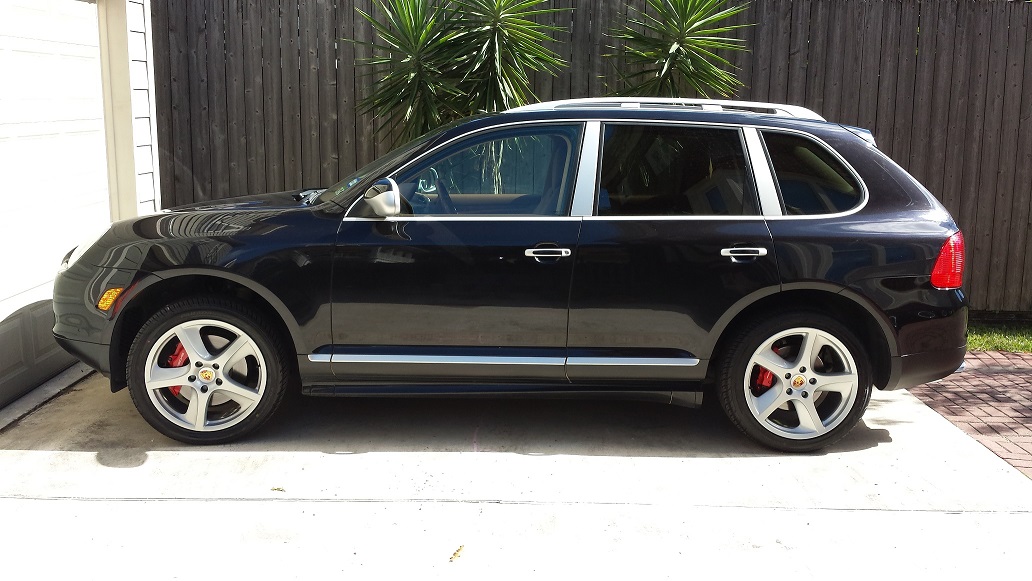

- Car came with 18” factory Cayenne Turbo wheels with Pirelli Scorpion Ice Snow tires. I was actually really impressedwith this tire. Seemed very grippy/stable for ice/snow rated tire. I’m in Houston and wanted 20” Sport Technos, mostly for looks. Found a used rim set and mounted with Yokohama Parada Spec-X tires. I was goingto buy Conti Extreme Contact DWS based on others’ reviews, but the Yokohamas were dirt-cheap from Discount Tire and similarly highly rated. So far, so good. Has increased steering and handling response a bit, but the low profile tires don’t seem nearly as bullet proof as the 18s. Not a huge issue as I’m in Houston, but I’d have kept the 18s if I lived anywhere with snow or dirt roads. BTW, the 18” wheels are now for sale (low miles ontires) – PM me if interested.

Nice post, and nice looking CTT.
Two minor suggestions: 1) Do the clear front sidemarkets, they'll improve the appearance dramatically; and 2) do the secondary cat bypass pipes before you do an ECU flash - you may decide the latter isn't necessary. They really do make that much difference. Improvement was very noticeable on mine.
