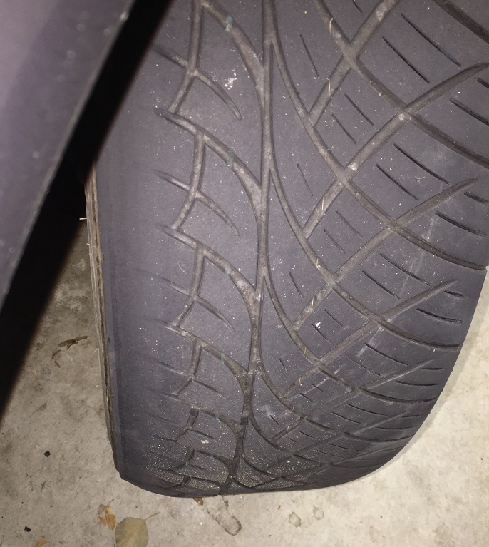

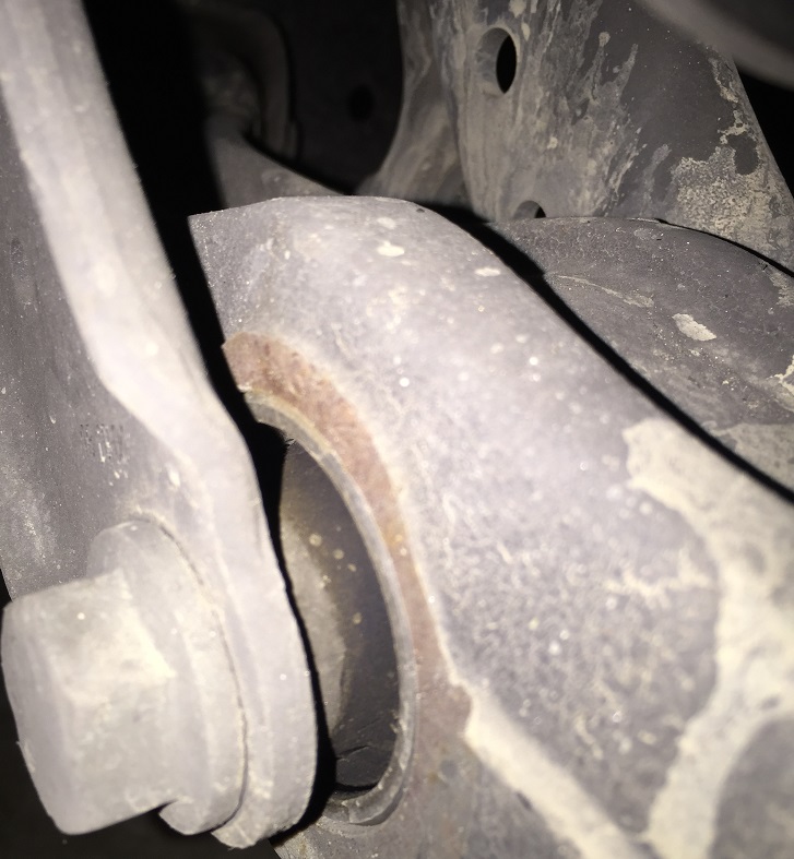

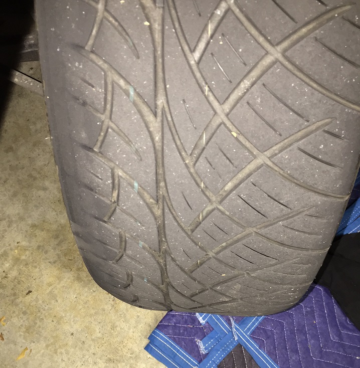

its an 05 and control arms were replaced at about 50K. Approaching 100K (imminent).
Got a chance to look closer and found the front tires wearing much more on inside edges. Rest of tire wear looks even.
Would that explain the squeaky and clunking sound?
If you look at the pics, does it look like the control arm bushings?
Is the CTT S control arm with bushing better in some way? What way?
Trying to get causes/remedies narrowed down so I can do myself if possible.
Anyone replace control arms themselves? tricks?
Thanks.

Hmm, I would guess you have an alignment needed but if you replace the control arms you always need updated alignment.
Maybe get the tires balanced first, then check alignment, then go with the Turbo S arms, they fit all models of Cayenne and are the most Robust of all of them...

The main thing I am trying to solve is the clinking when going over bumps.
Looked in there over the weekend but did not see anything that would cause alarm. All ball joints seem tight and together, no rusting at all.
The tires I noticed wearing on inside must have been happening for a while since my rears seem to have similar pattern (and I have rotated tires a few times so looks like was going on for a while).
Have been reading that if you drive aggressively it will wear more on that side too (I have on occasion but not every day).

Well for that bashing feeling and weak arm, its the rubber housing that tears away and it can be tough to see.

Are you talking about the rubber bushing on the a arm? The one which is close to the wheel? The one in middle pic I posted? There are other bushings too do I wanted to narrow it down. Thanks.
