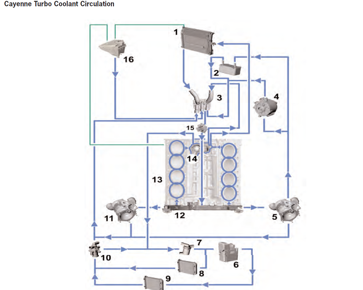

I don't think you will have problems with air pockets. Follow the FSM instructions. Bring it up to operating temp while filling until the thermostat opens. Make sure that you fill up the expansion tank and after the first heat cycle it will bleed itself to a point while cooling. IMHO you don't need to reinvent the wheel on this one.
Name:	coolant diagram 955.png
No, I do not think it will work the way you are thinking. You cannot control the path the fluid follows.
