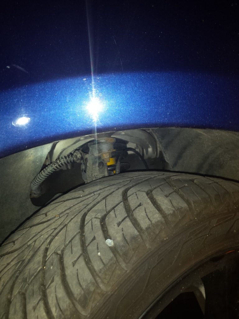

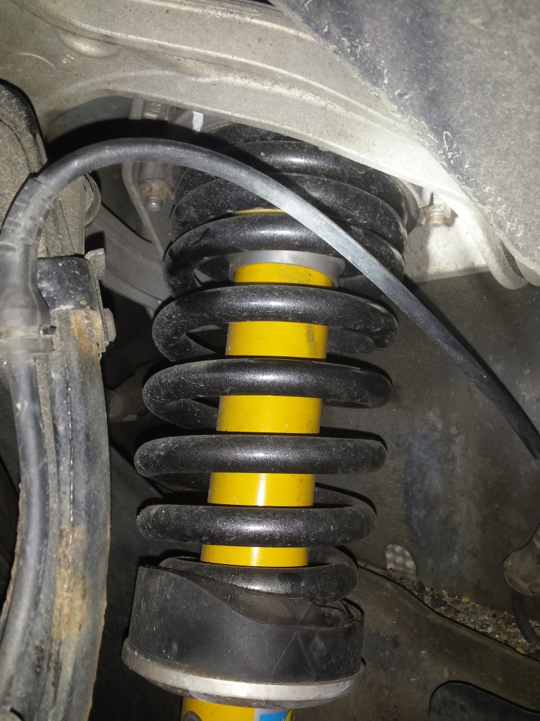

I picked up a 2008 base in the fall and have been working on a few things, 20 inch wheel, set of B8 Bilsteins and H&R springs. I had the B8s and the springs put in about 2 months ago and the one on the drivers side has, for lack of a better word, collapsed. So much so the whole thing leans, its eating the tire (I have stopped driving it) and its wrecked the bumpstop and cap before I realized it.
has anyone else had any issues like this? Ive had H&R springs in the past and never had any issues, with any aftermarket springs.
The worst part is H&R is giving me the run around on warrantying it out. I purchased from an authorized dealer and sent about 50 pics of both sides, the latest reply thru the dealer was that they want me to check to make sure the pass side spring is seated correctly, there is no issue on that side and they want to make sure I have the correct spring part numbers installed, and asked for a pic of the spring part number on the vehicle, which I had already sent. This has been going on for almost 2 weeks now. I understand the need to make sure there is a legit issue however I have never had this much run around from a company.
or am I missing something and something else could cause this?
sorry I didn't really want my first post to be a bash on a part supplier, just trying to see if this is par for the course with H&R, as I'm close to replacing them and never buying another H&R product again.

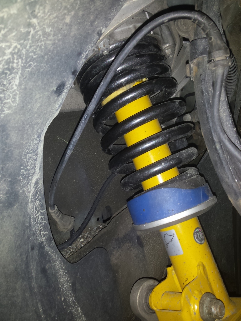

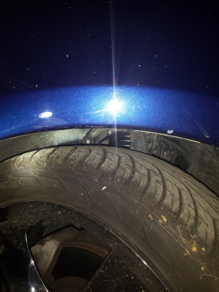

blue seat is the low side, first pic was just after is was done and is normal

Unfortunately its H&R that's giving me and the dealer the run around. I've contacted H&R and they say the pics and descriptions are normal procedure, which is fine however whey they tell me the good side looks installed incorrectly, I wonder either what I'm missing or they are (or are not) seeing?
Yes I believe the blue seat (compensator) is thinner than the black one however its only MM difference, I've lost inches since installation

Can you find anything else that's broken? To me the driver's side in your pic looks like it's compressed more at the top than the other one but that could be how the spring is rotated.
Did you take it in to the shop to see if they can figure it out? How is the lower perch attached to the shock? Is the ride height adjustable (it doesn't look like it with not threads on the body of the shock)? Dunno, just spitballin some other ideas?!?

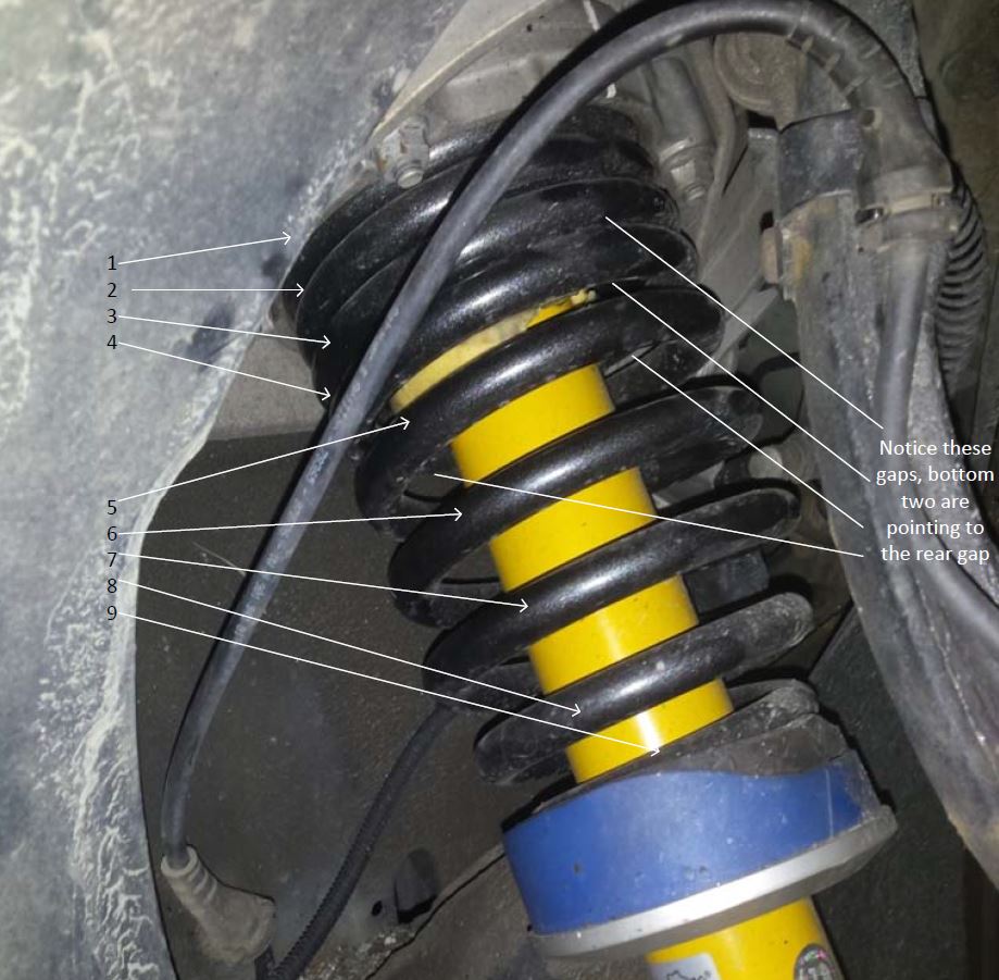

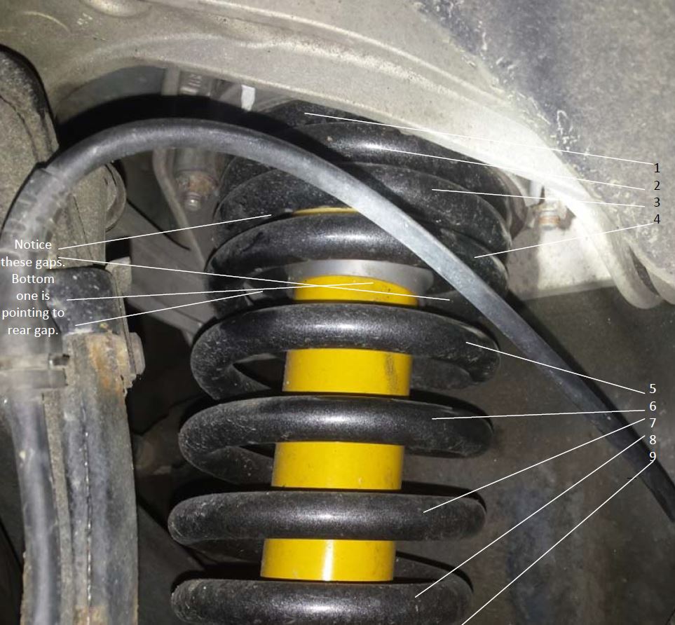

I've been doing the same on the ideas. I sat down last night and pulled the wheel off and looked again, then analyzed the pics I had taken. Nothing seem out of place, broken, bent or otherwise out of order. I did notice in the pics below and am now convinced its the spring, sent this to the dealer this morning.
'The bad side (blue seat), you can see 4 coils at the top touching, good side(black seat) only 3 for most of the turn. The gap between coils 4 and 5 is very small on the bad side and much larger on the good side, even on the back side, this coil is the biggest difference. And there is visible a gap between coil 3 and 4 on the good side and very little on the bad.'

I ordered the Eibach springs and they showed up during vacation. I replaced them myself yesterday. I get the front 2 swapped and am looking at the H&Rs and notice that the side that is collapsed has a rear spring installed! I knew there was a reason I didn't trust this shop (there was also a Bilstein strut warranty issue, which I now and sure was them as well) as a major DIY person, this is what I get for not doing it myself.
After I have swapped out 3 of the springs, and found the front one on the pass rear I get a message from my dealer, another relay from H&R - mind you we are now at 1 month since I reported the issue and H&R has had the pics for over 3 weeks:
"Looks like i've found out your customers issue, Him or the shop has installed a rear spring on the passenger front. The driver side (the one that is dropped) is actually the CORRECT amount of lowering that is with this kit, the passenger front should match the driver front. Please have your customer check the back two springs and make sure that a front spring is not installed with a rear shock. You can note a front or rear spring by a (F) or (R) on the spring right after the 29286-2 part number on the spring!"
What concerns me more that anything is that they tell me that the drop is 'CORRECT' on the incorrectly installed spring that is over 1.5mm smaller in diameter and intended for the rear. Just on this fact alone I'm glad these are off the pepper...and they told me the pass side spring is seated incorrectly, which it was not, I have pics.
