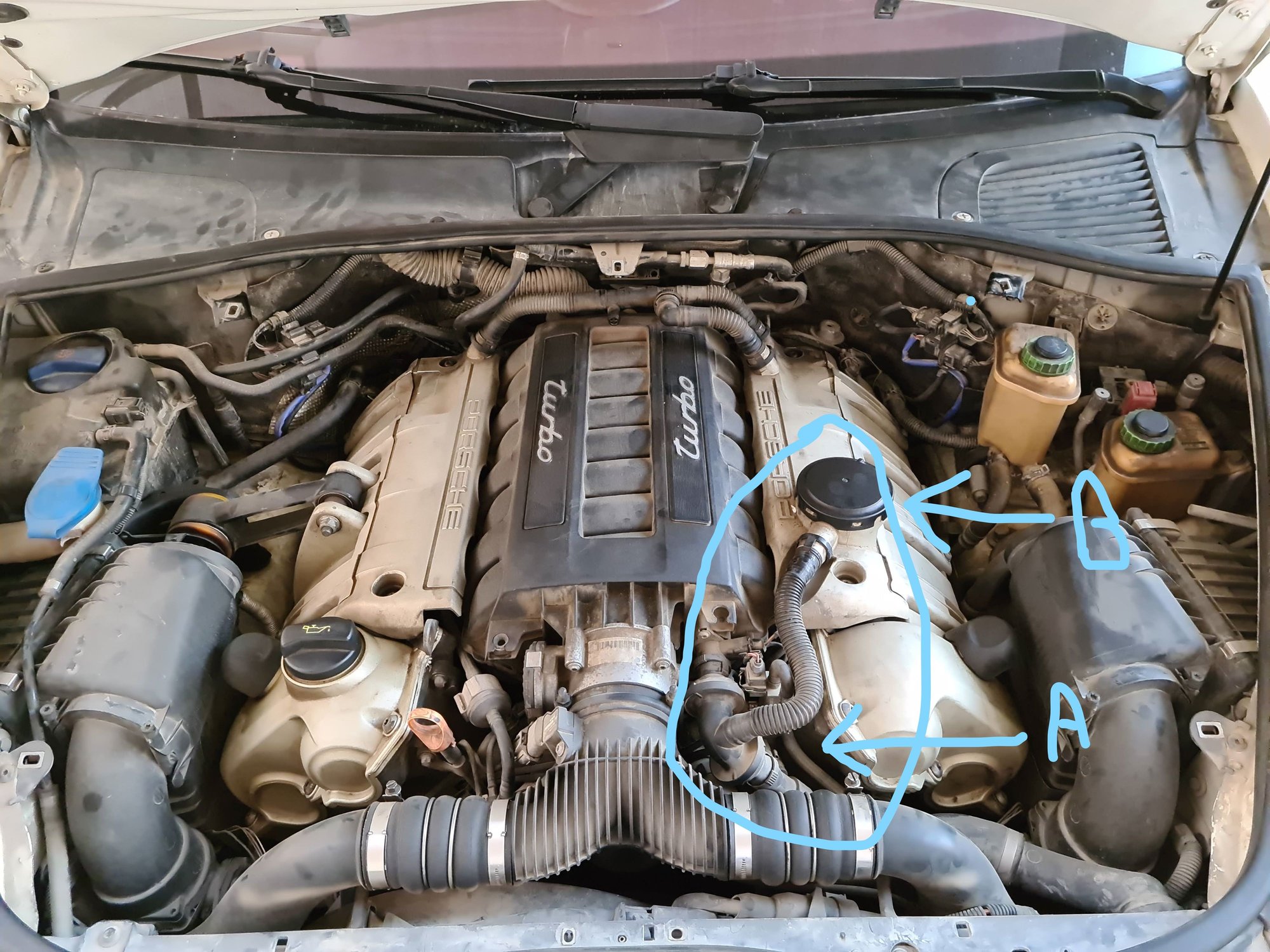

About the underboost try the one way valve which is positioned on the left side of the intake manifold, connecting the PCV system (if you need a photo I could provide).
Soon I will be ready with the upgrade and there will be a replaced torque converter. I will share the outcome!

p.s. left side = driver's side?

Yes, left side is driver side

Thanks SRT...I'm guessing it's item 'A', on my picture below - the vent line check valve? If so, any tests that can be done to determine if the component is functioning correctly, before I get the credit card out?
