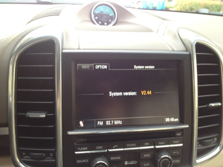

Your dealer can update the PCM so you will have the "time" on the screen. I just had mine done last week. There was a TSB for the Satellite Radio now remembering presets. That is how I got mine updated under warranty.

I also just had my 2011 Cayenne PCM software updated at the dealer. The version shows as V2.44

That is strange they told you that. If you notice in the picture, it no longer has the temp and the date is in that place. I would talk to someone else at your dealer.

Thanks Bluelodge400 for posting the jpegs of the upgrade to 2.44 by your dealer.
I took prints into my dealer today since my '11 C6 was due for the annual service. They were a bit surprised, but did find the s/w update and applied it. My '11 now has v.2.44 (with the clock).
But, it must have had more than just a clock as the car has a different feel to it as well. Gone is the slight hesitation through some of the gears. It's a nice change and takes away the only issue I've had with the 6 vs. the 8.
Suggest folks print those pictures out for your dealer if they have an issue about upgrading the PCM software. So when you go in to get the headlight fix, they can update you software as well.
