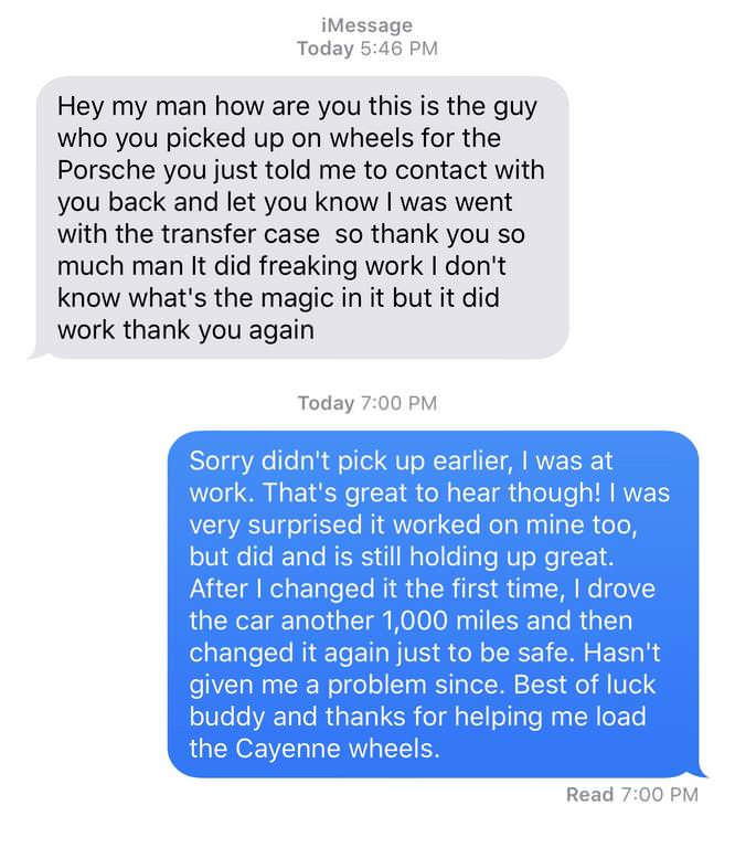

I mentioned in my build thread that earlier this week I went to Georgia to pick up some new wheels. The guy I'd been in contact with had the wheels/tires at his mechanic's shop. When he was helping me load the wheels, I noticed he had what seemed to be a 2011 or 2012 Cayenne Base. I inquired what problems it was having and if it was transfer case related. He explained that the truck was awaiting a transfer case replacement and the owner was deciding whether or not to incur the cost. The car had 70,000 miles and had the "clunk" sound throughout 3rd/4th gear.
I immediately let him on our fluid change secret as a remedy. He was skeptical, but took note of the exact Ravenol fluid that I used. I told him to get my number from the owner of the wheels if he had any questions. English was not his first language, so excuse the grammar, but last night I received this text message:
Add another quick fix to the list!
