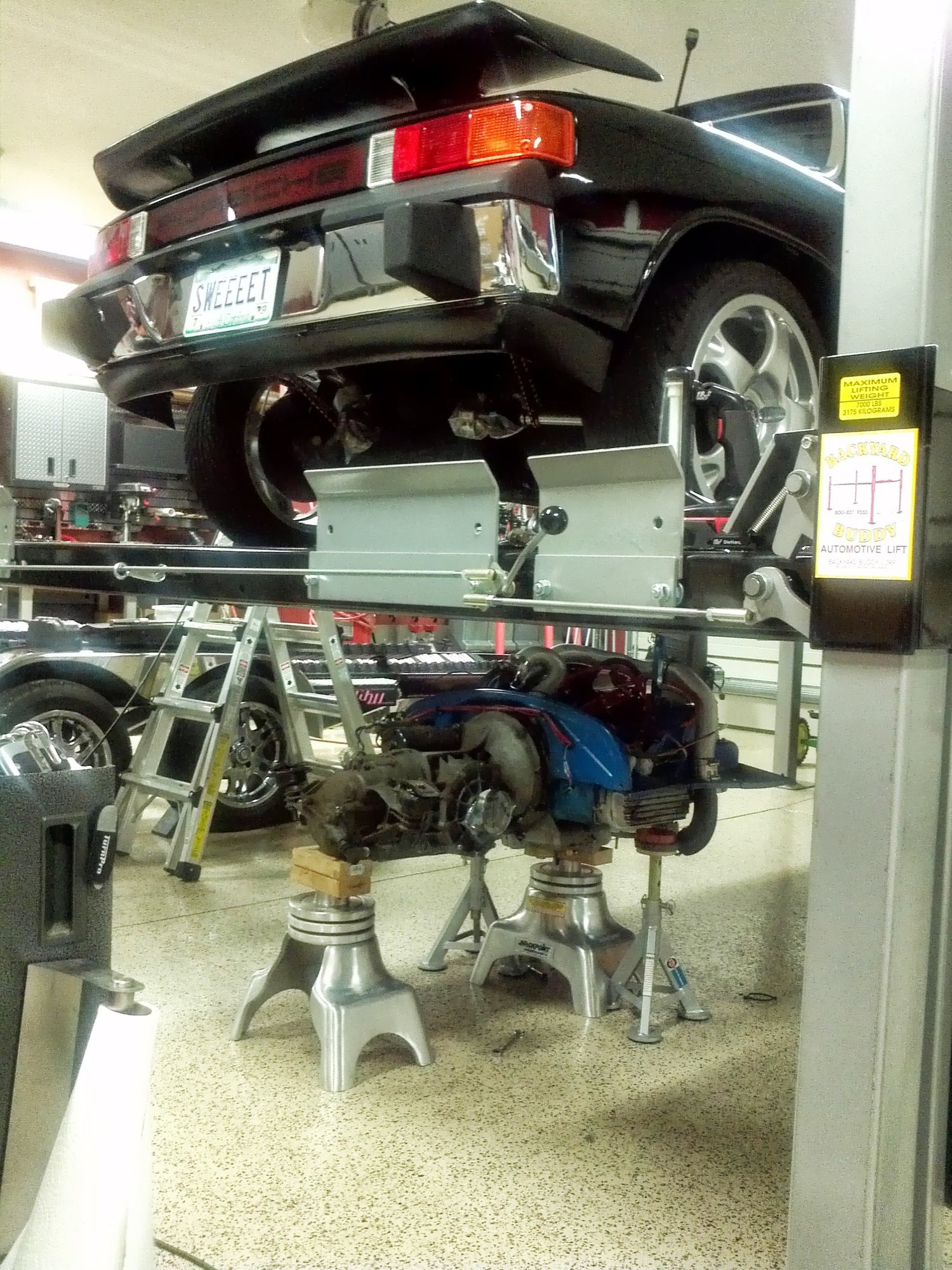

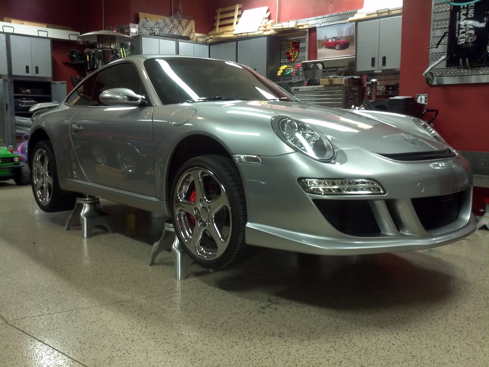

when I'm not using my lift, I use either Jackpoint stands, which are awesome as they allow you to Jack and support from the same point (but are sometimes a little low), or esco stands which use the pin through the post method and can go really high. I'm not sure of the weight rating on the escort stands but would check that before using them on a Cayenne.
Escos are the tall ones supporting the sides of the motor
