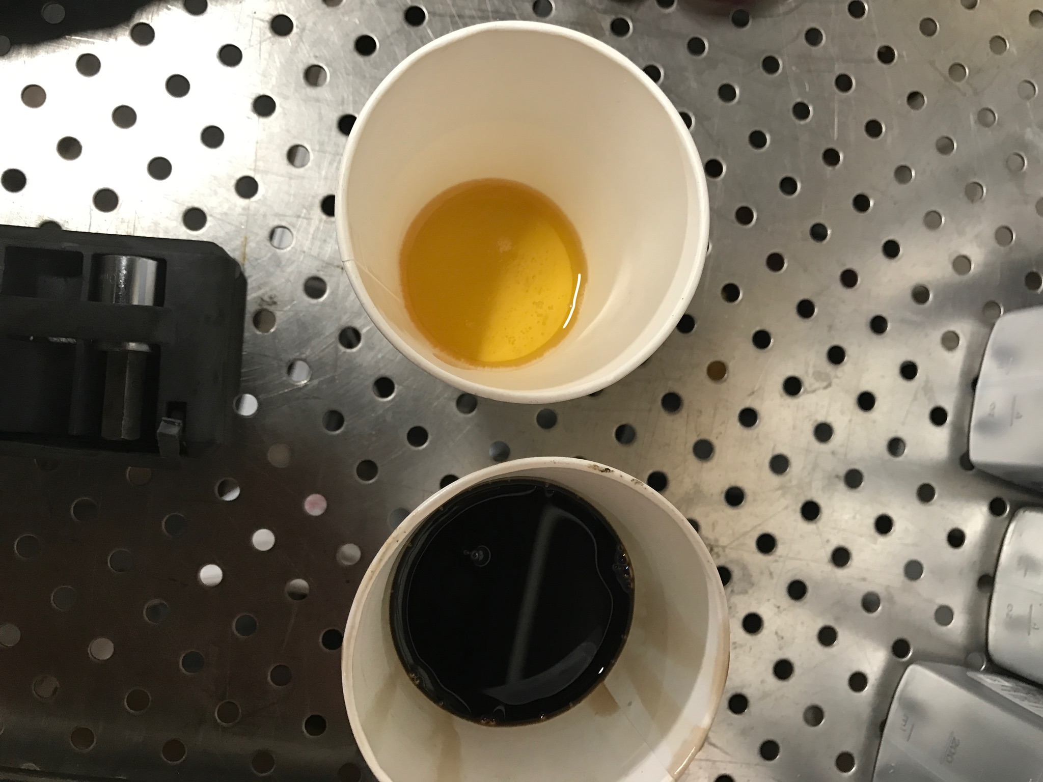

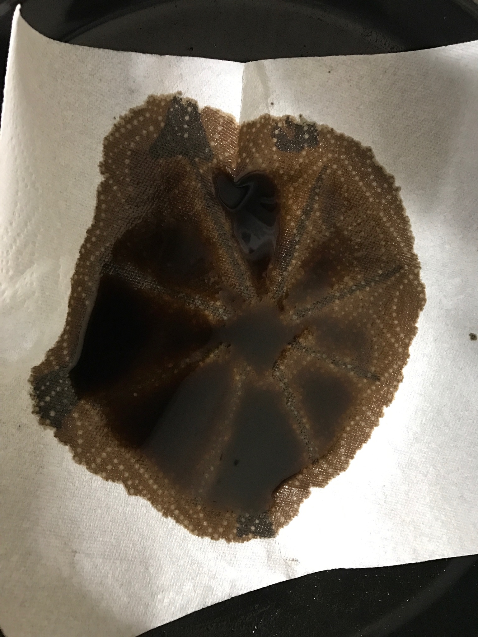

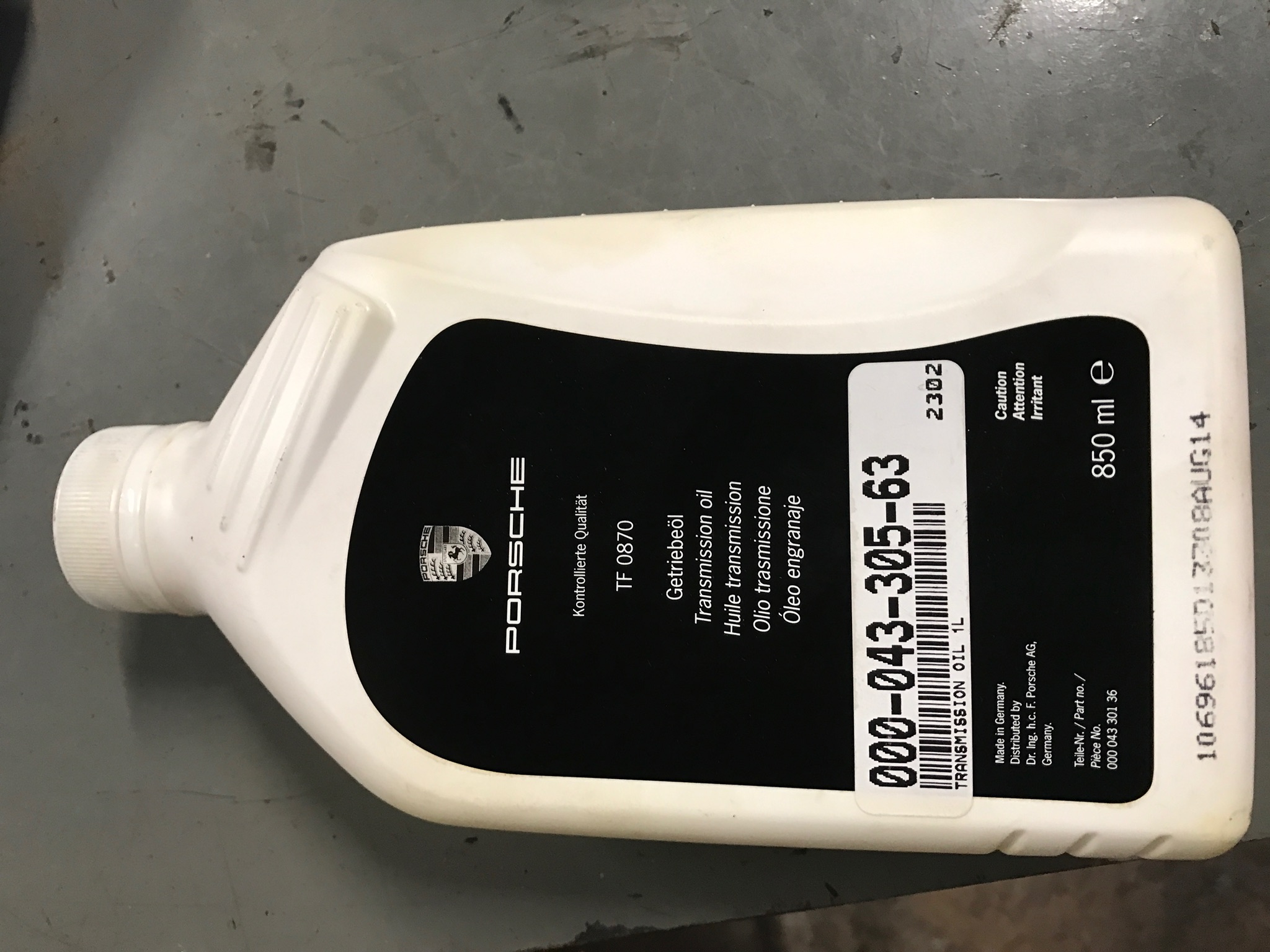

Old Apr 2, 2017 | 11:22 AM
  #140
texas993's Avatar
Joined: May 2011
Posts: 27
From: Dallas
texas993 is infamous around these parts
I changed the fluid on my 11 CTT with 88k miles. Pictures say it all.
And it does drive much better. Definitely a routine maintenance item.
The fluid I purchased from the dealer is 850 ml. Exactly enough to fill it, but no extra.
That's exactly what mine looked like at 72k miles.. and as yours - mine runs better now. Smoother. One of those "oh wow!" sort of things where I didn't realize it wasn't really smooth until it suddenly became really smooth..
Thanks for your passion on this issue (and the cam bolts). You are helping a lot of folks.
I planned to change the fluid as routine maintenance, but your comments on the before/after made me do it sooner. Glad I did. I was worried a bit about my xfer case due to those weird moments. Those are gone now. Dealer told me the case was fine (before I changed the fluid).
