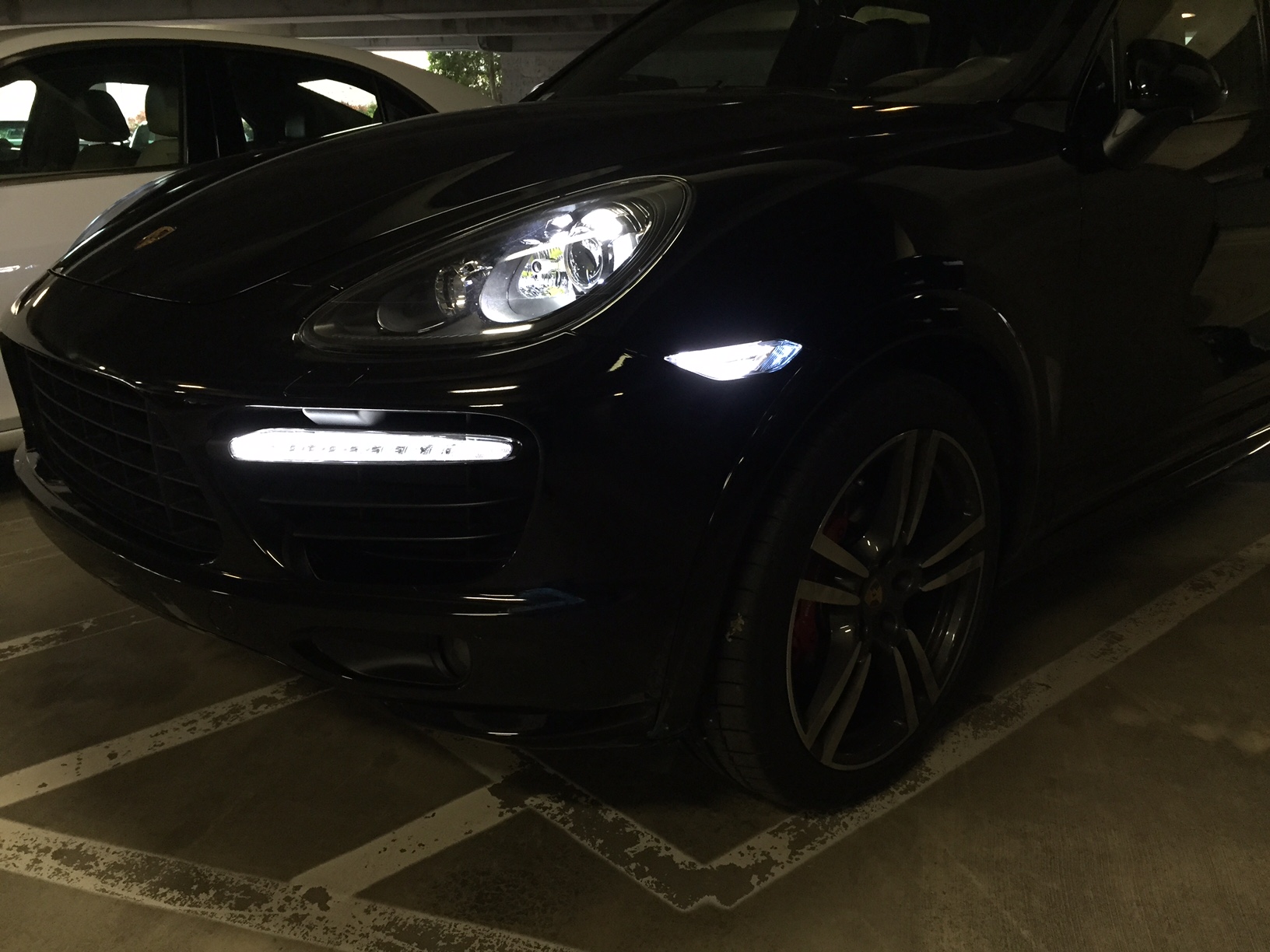

Sidemarkers:
Also from Maxspeed

Any photos of the side markers on you car? They look awesome on Maxspeed!

+1. I do like those clear w/ white side markers.

Not the best pic but best I could do! I really like how it looks, especially after driving by a few Cayennes with the stock housing and bulb.

They look great, so much more fitting than the standard clear markers. Thanks for posting
