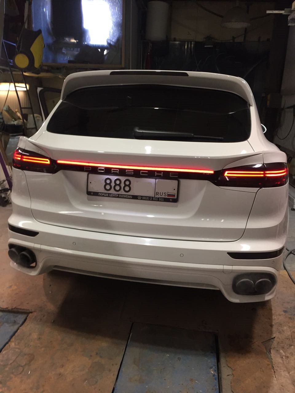

Originally Posted by lawr
looks ok. But honestly i don't like it. If you choose to put some money into it, why to do it ordinary?
100%%))
Name:	rest tail.jpeg
ID:	525727   Click image for larger version
Name:	pana tail.jpeg

Is that 2019 Cayenne rear end into 955/957 one ?

white - 958 to new style, black - panamera tail lights in 957.
That is an incredible job. Looks totally OEM.
You can only do it in coutries like Russia, where prices of cars (both new and used) are much higher and labor costs are much lower.
