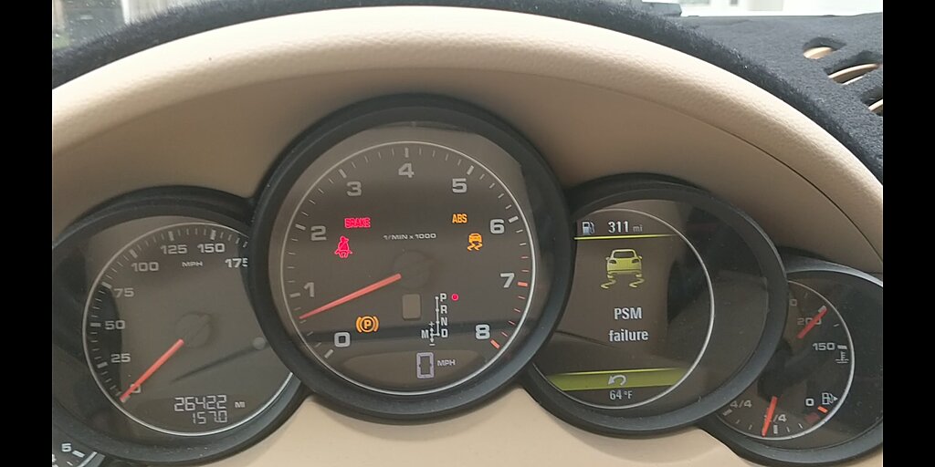

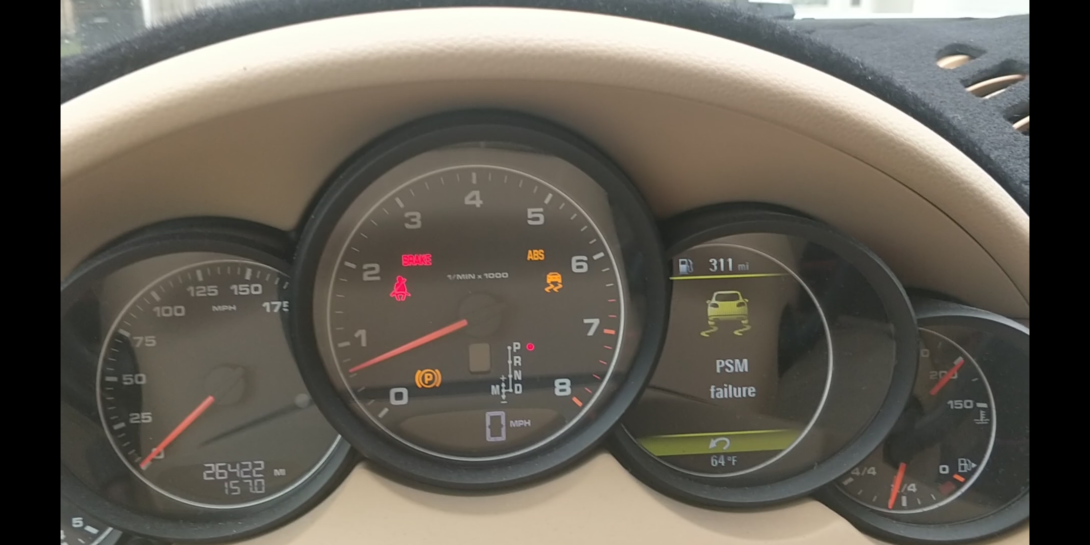

Symptoms: Driving along at city speeds and then BOOM...lock up of passenger side rear wheel, followed by every system known to man going into fault mode.
PSM failure, Electronic brake failure, AWD system failure, ABS light flickering

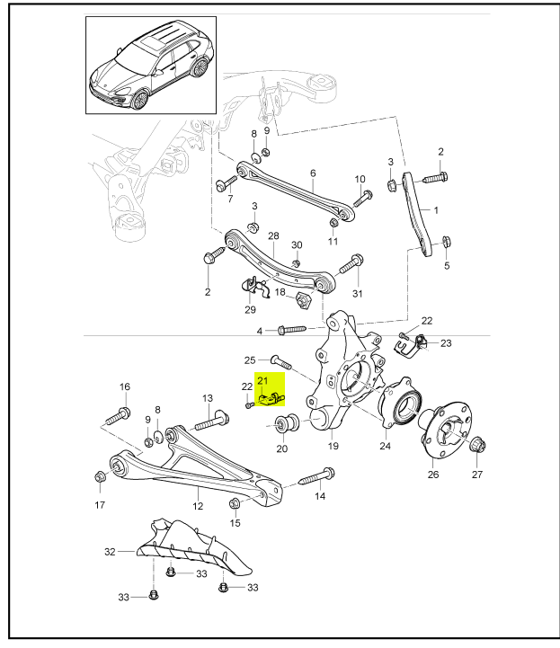

Solution: replaced part number: 958-606-405-10

Just found your thread. I experienced the same problem on Monday. My new sensor arrives today. Will report back with the result. BTW. the new revision for the sensor is 958-606-405-02.

your part number pulls back ABS sensor...my part number pulls back speed sensor.
Not sure if two separate things...there is a price difference so I would be careful.

They are the same sensor.

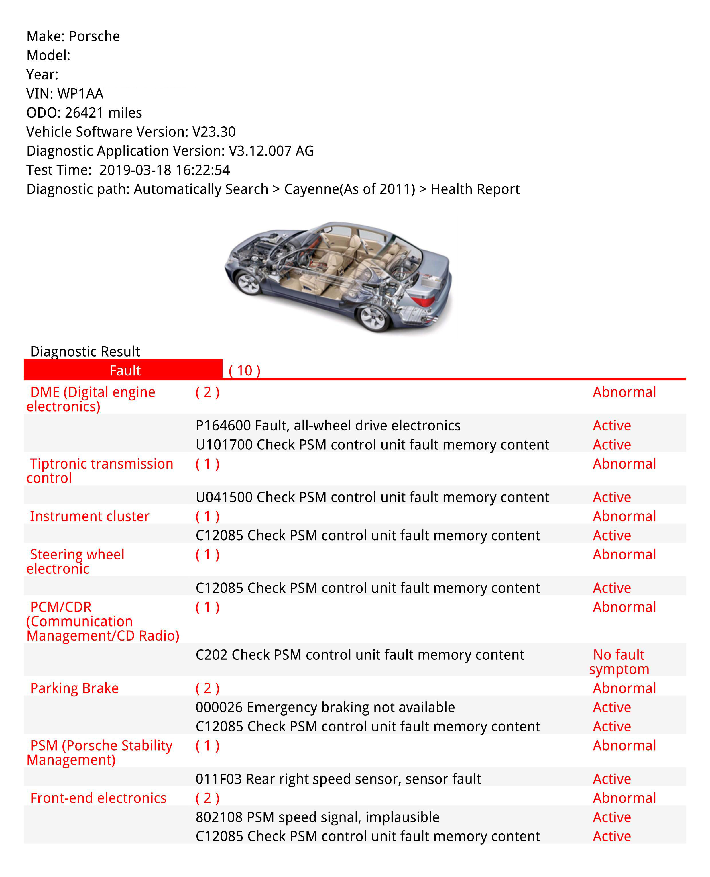

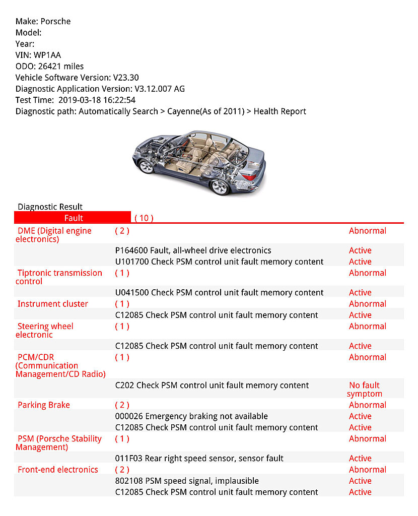

I had this happen to my 2012 Cayenne Turbo yesterday scanner pulled right rear sensor even though it threw multiple errors like PSM failure, suspension, AWD, ABS and all sorts. I swapped it out and all errors cleared. I used a $20 part exact same part number as the sensor for other VW cars like the Q7 and the Touareg, exact part match

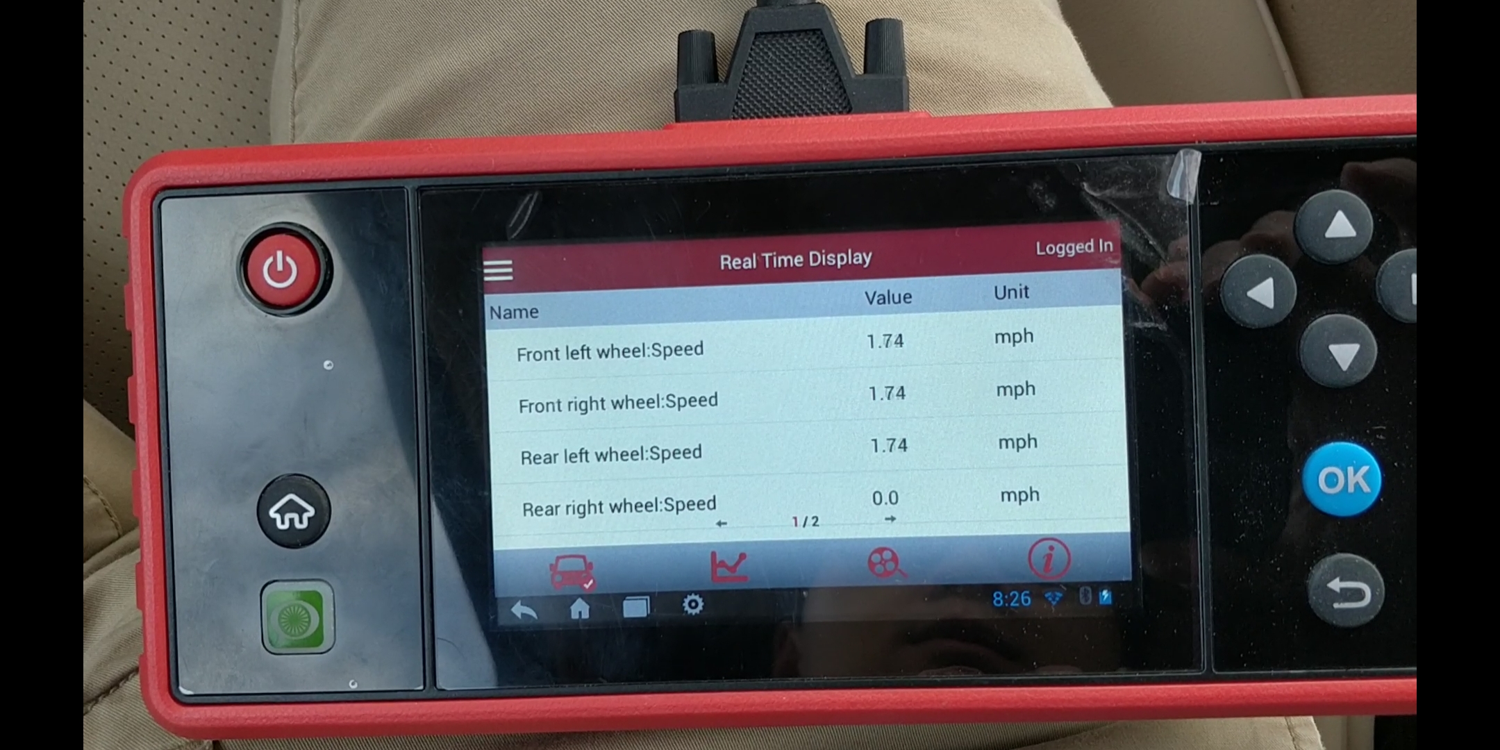

You need to scan it to know which one of the 4 is causing the error. It uses the same parts is a Q7 and Touareg of the same year

My sensor just arrived (the inexpensive one); I've been having the Christmas tree of warning lights. I had AAA replace the battery of my 2016 Cayenne (date on the battery was 2016. apparently, the original battery). That didn't solve anything as apparently the battery didn't take. Had a Porsche battery and 2 right sensors replaced (I got lucky. under $700 beans. It's good to know people (Porsche wholesales the battery to body shops for around $500, $400 if you talk nice to the parts department and they will even give you the code to enter)), and it was OK for 3 weeks then BAM!!! The Christmas tree came back. Scanned with a proper scanner that identified the right rear sensor as defective. will replace tomorrow and let ya'll know.
