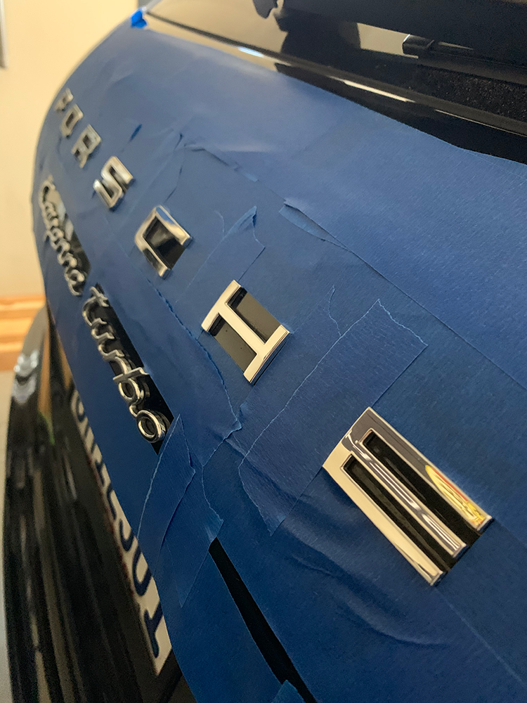

For the emblems, I ended up completely removing all the badging. I would definitely NOT paint on the car. I basically taped up the whole back to make sure I knew exactly where the emblems would go after I removed them. I used dental floss to "cut" through the adhesive to remove the emblems.
Clean everything up with Goo-gone (emblems and from the trunk). Just soak the glue with the goo-gone every 10-15min for about an hour. The adhesive should have dissolved enough to easily remove with an exact-o knife or even a toothpick.
Below is the final gloss black wet coat. I did 2 light coats of primer, 15 min apart, then one "wet coat" of primer and let it sit for about 2hrs. I sanded it lightly with ultra fine grit sand paper. Then I repeated the process for the actual gloss paint. 2 light gloss black coats 15 min apart, then one "wet coat", but I let that sit overnight. Come the morning, I was able to polish them. They came out perfect. Just some tips:
1. Put the double-sided tape you plan on using before you primer and paint (makes everything easier to handle)
2. Try to paint in a clean area. One of the letters got some dust so I actually sanded it back to the chrome and redid it.
