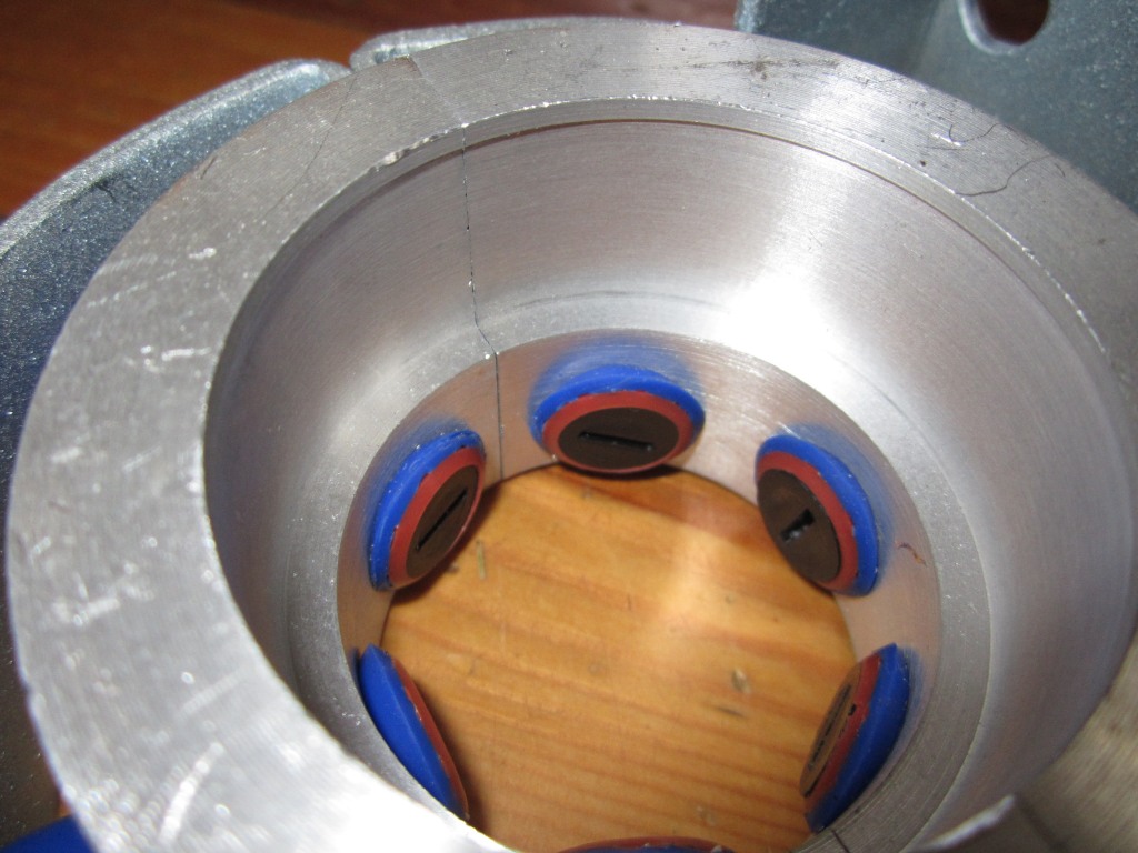

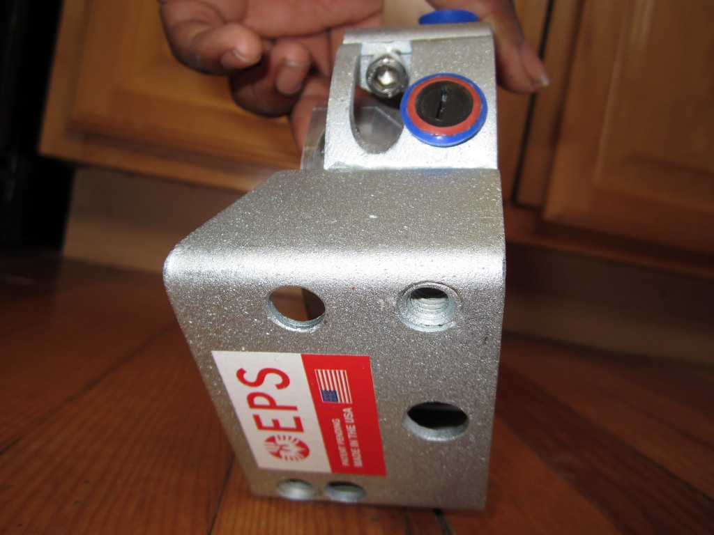

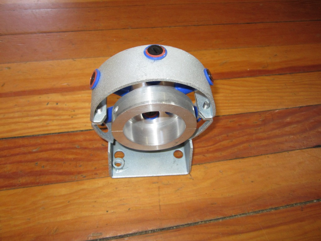

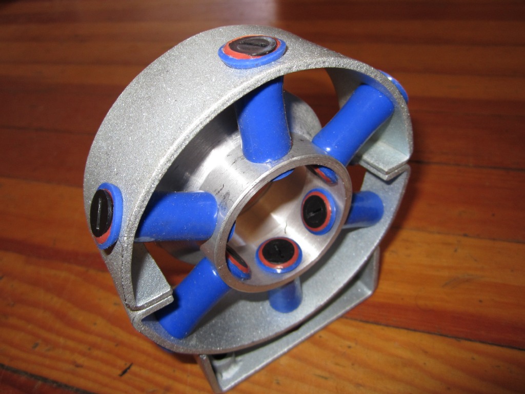

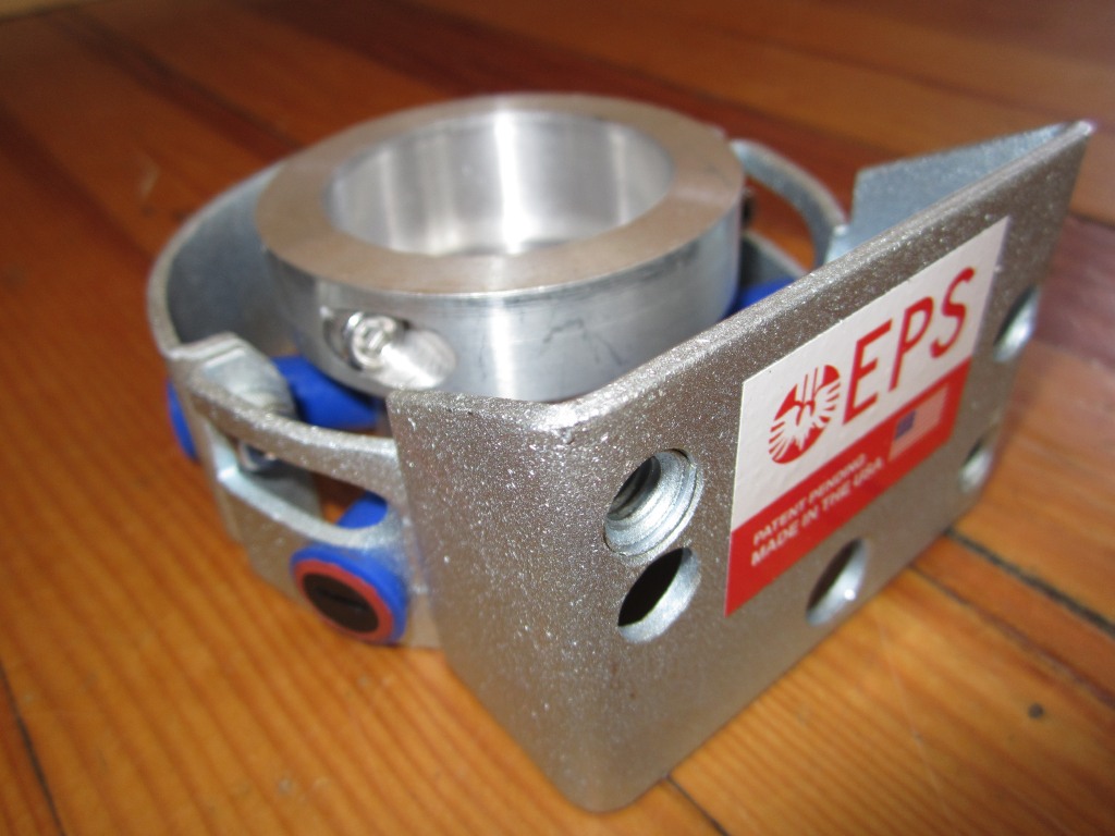

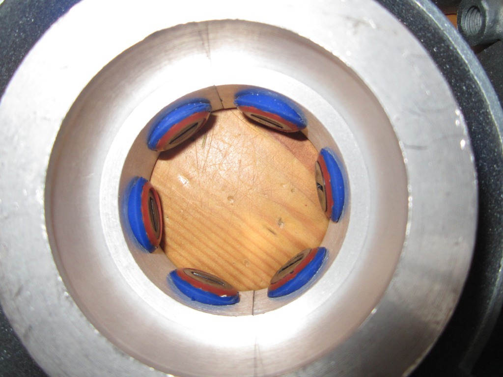

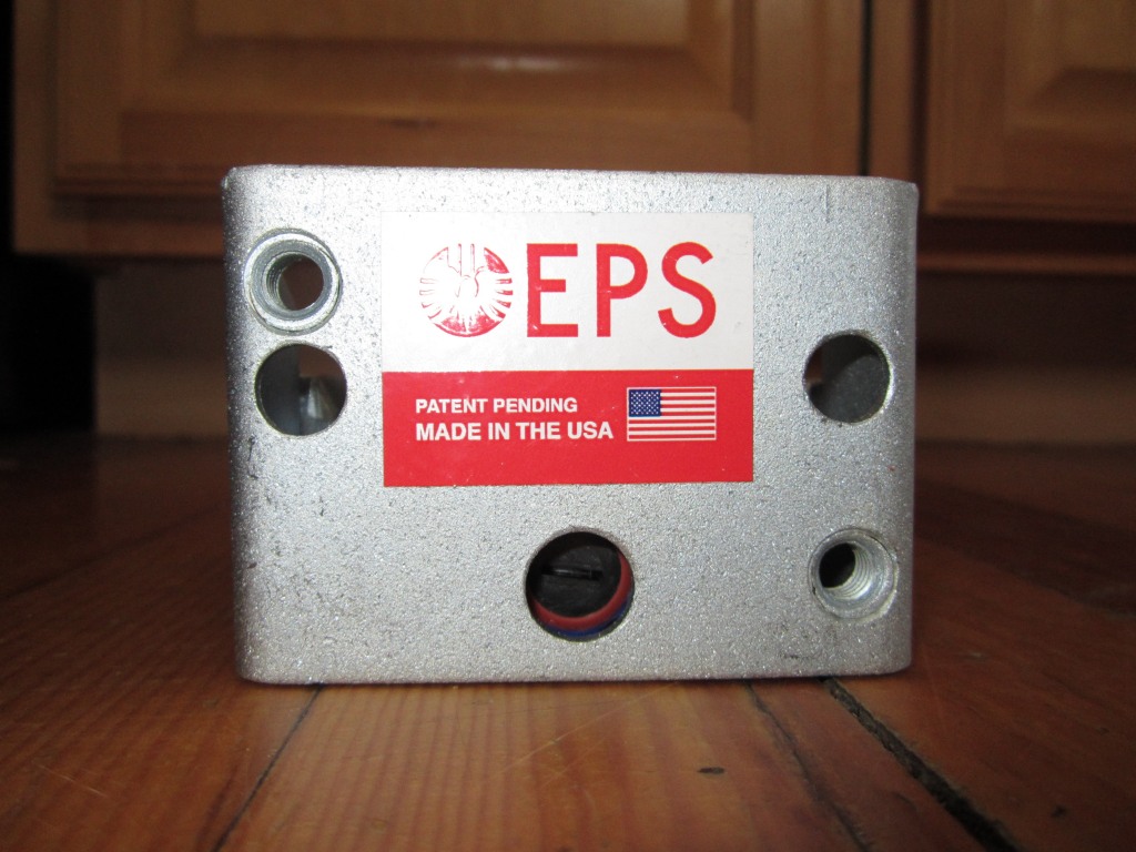

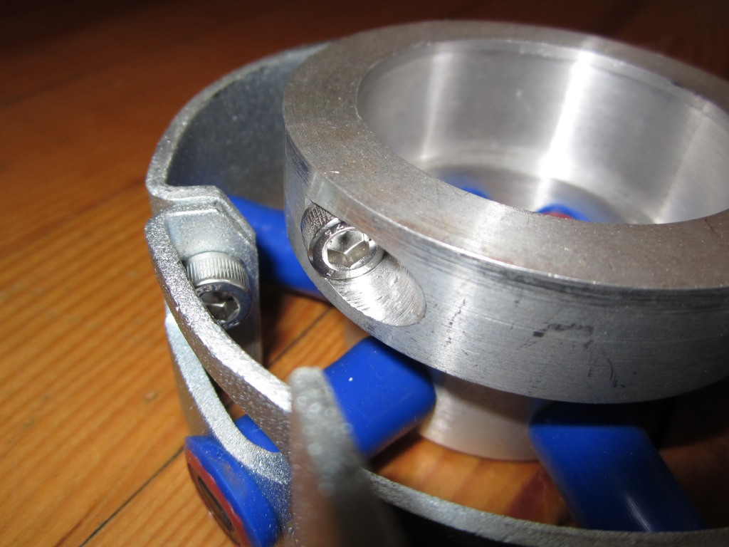

If you read my recent autocross thread, then you would know that I just ruined a good OEM center driveshaft support bearing bushing in just one day of track use. I repeat, one single day. Even though I probably could have had it replaced under warranty, I wanted to look for a more permanent solution.
I have known about the Vertex Auto replacement center driveshaft support bearing bushing (what a long name!) for about a year now and spoke to them over the phone around last May. They are extremely confident about this product, have a pending patent, where I was told they sell "hundreds" of them each month for the Touareg, Q7, and Cayenne crowd.
From an engineering perspective, the design looks solid whereas the internal section is CNC machined out of aluminum where it clamps around the existing DS bearing. I could not find any online complaints so I ordered this part and a replacement damper (flex disc). Additionally, the design is modular and allows you to install and remove the bushing without needing to drop the driveshaft and exhaust. So, it should prove easy to service, if need be, in the future. Moreover, they are also marketing that this is a permanent solution.
I installed it in about half a day and very happy with it so far. FWIW, I made sure to replace the mild steel allen screw that came with it, with stainless steel allen screws (M6 x 1.0) from the local hardware store and applied anti-seize to protect against corrosion. No more KNOCK KNOCK KNOCK KNOCK!. In fact, it seems better able to handle my higher levels of torque. When turning 90 deg. and applying WOT (cause fun, clearly) the stock unit, even when brand new, would slightly knock until throttle lift. The vertex unit does not complain at all. All tire chirps and chassis flex.
Here are pics of the unit itself and the install procedure:

Sweet. It looks like the hardest part is cleaning the rubber off of the bearing.
Yes, for sure, that is the hardest part. I spent about 30 minutes trying to get it as close as possible. It took a few razor blades since it dulls them within about 10 minutes of use.
After that, I used a flap disk to get it down to bare metal without gouging the outside of the bearing. Which was my biggest issue with the video, they gouge the crap out of the bearing with a right-angle die grinder / cutoff wheel combination.
