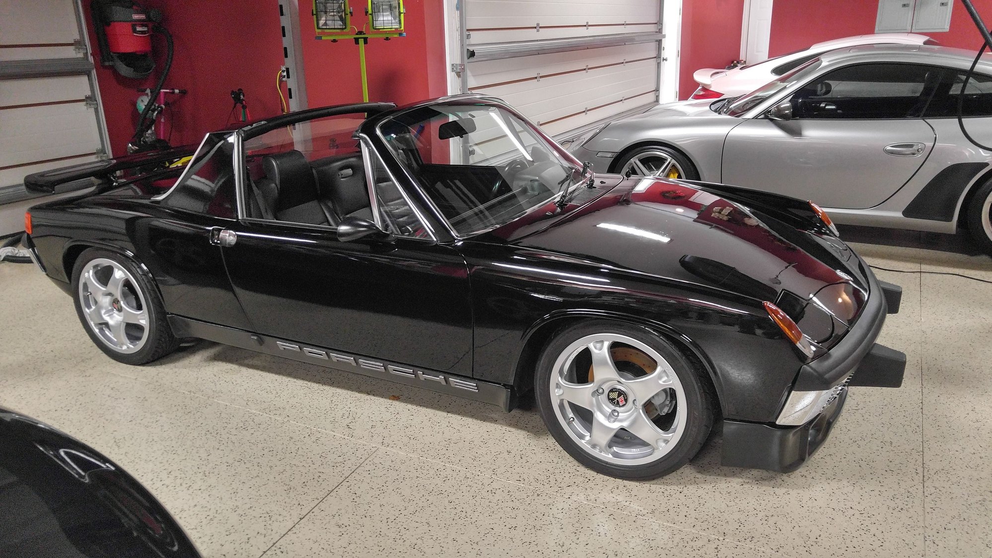

Thanks, great information! Nice 914, BTW!! Any chance you get over to Knoxville for Dragon. Devil's Triangle and other TN drives?

Love the 914 - was the one that started it all for me.
