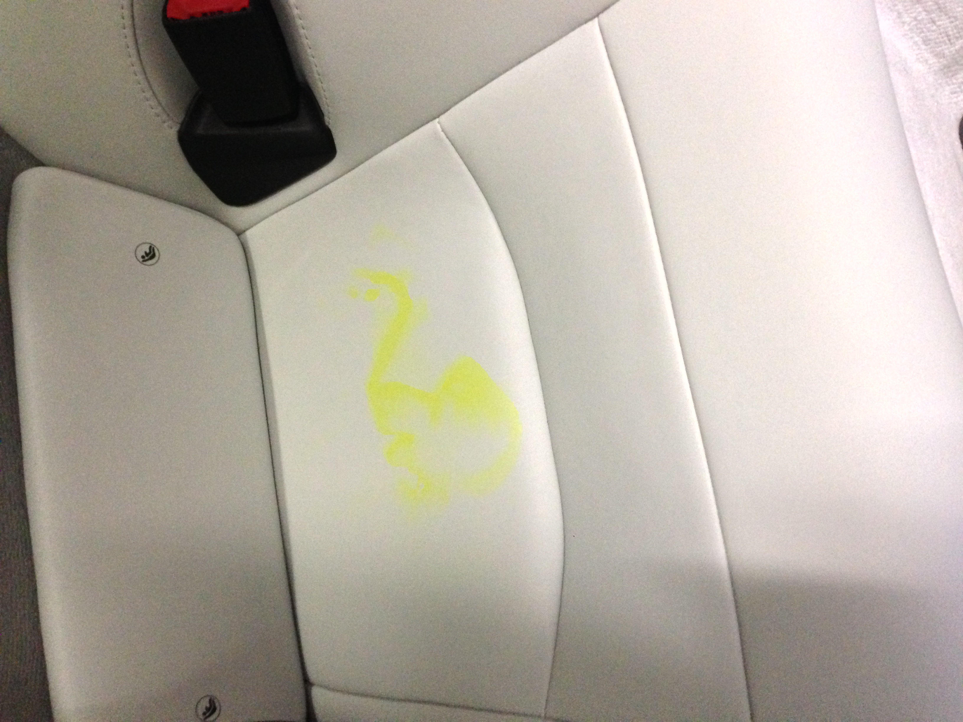

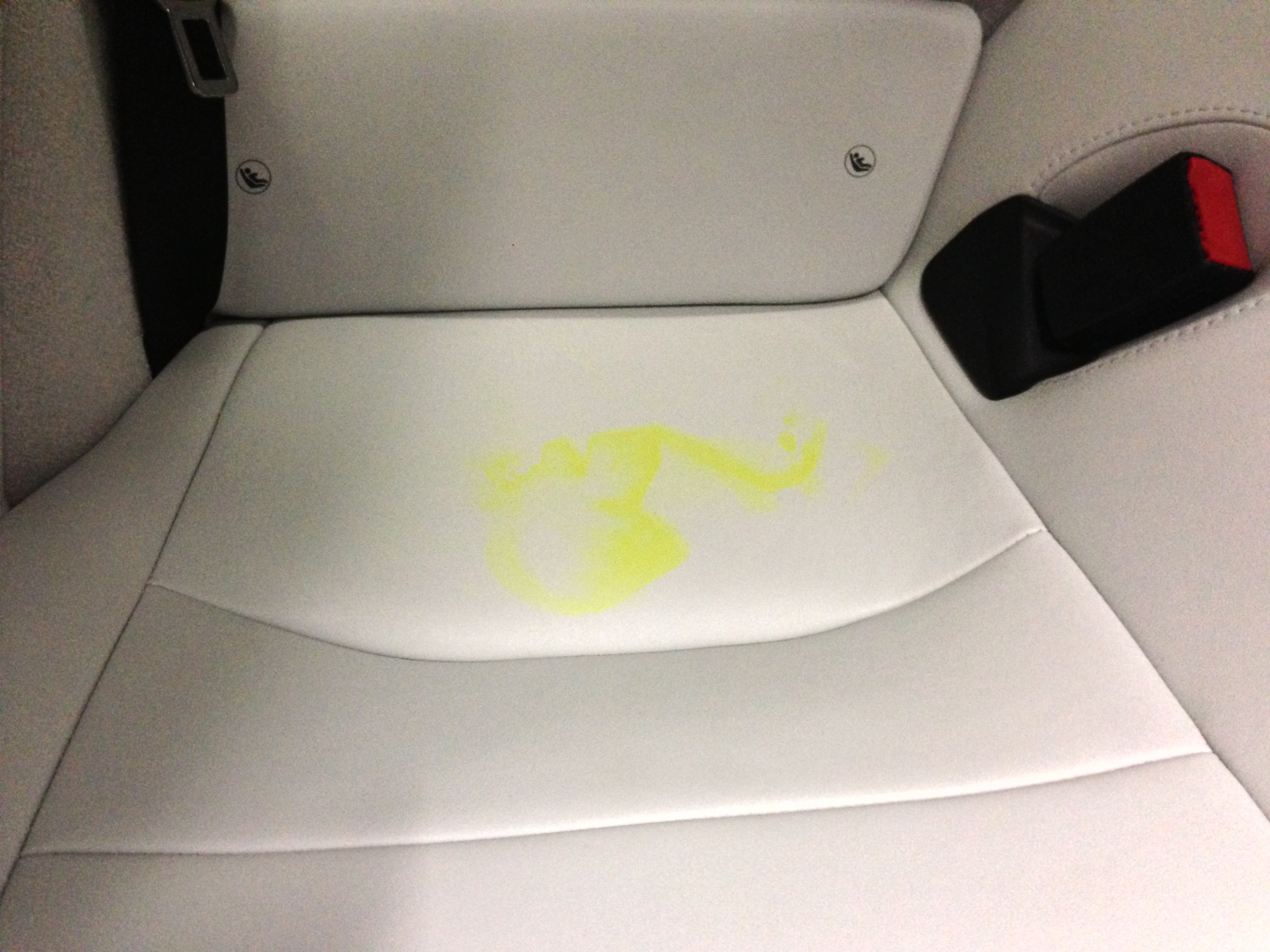

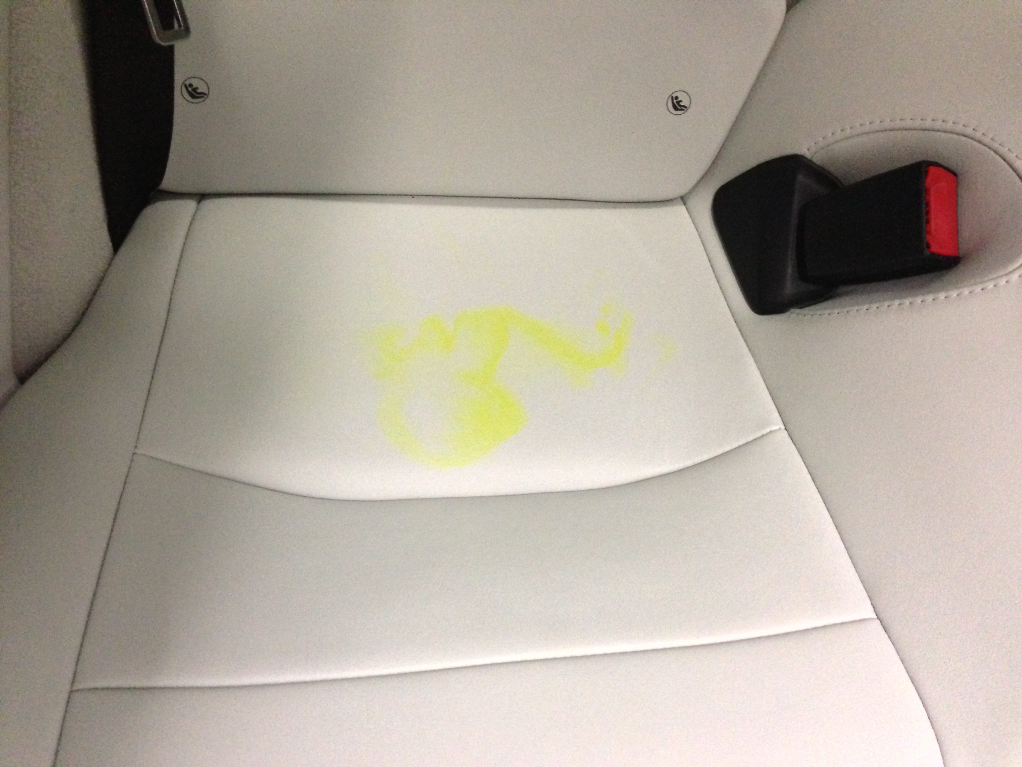

tumeric stain on pebble leather
Hi Moe,
This just happened a couple hours ago. I spilled some food on the back seat of my 991 and it had tumeric in it. It appears to have dyed the leather neon yellow.
Any way I can remove it safely?
Please let me know!

Well, that's a new one for me. Did a little research and here's what I found:
According to foodrepublic.com, The compound responsible for turmeric's fierce pigmentation, curcumin, isn't water soluble, so forget the old dab-it-out or even the club soda and salt trick. You'll need to break out the heavy-duty artillery AND harness the power of the sun.
Check out this video:
In a nutshell, I'd try the following to a small area first:
1. Rub with warm towel and hand soap
2. Rub with a stain remover paste that's enzyme based...I don't know if oxyclean or something like it would be a good choice. Allow it to do its thing for a few minutes
3. Wipe with warm towel and water
4. Hopefully it might have turned a pale pink, so let the sun do the rest
If above doesn't work, a good leather repair guy should be able to color match that small area and fix the issue. Just make sure the stain is neutralized so it doesn't bleed through the repair
It goes without saying, but use caution with what I suggested above as I've never tried this before. This would be what I'd try on my own car, so, may the force be with you.

Thanks for the detailed reply Moe. I watched the video and it seems like it's worth a shot. I was doing some research last night as well and I ordered this:
http://www.autogeek.net/leather-mast...r-remover.html
I got one day shipping, so it should be here tomorrow. I'm just not sure if I should wait until the dye transfer gets here or try the enzyme approach.

Not familiar with that product as I've never used it. The brand is a good one though. Let us know how it goes

Any update as to how leather masters dye removal worked? When a product doesn't fully remove a stain, the use of that product in conjunction with steam greatly improves the effectiveness. Steam will open up the pores of the leather and allow the stains to be extracted easier. A cheap steam machine can be found at Harbor Freights such as the McCulloch Steamer. Let us know how it went!

Update:
So I tried the approach from the youtube video Moe linked me, but it didn't work.
I tried another method I looked up which included baking powder followed by vaseline, but that was also unsuccessful.
I also had a professional detailer take a stab at it with some methods he thought would work, but he didn't even make a dent.
The leather masters dye transfer was the best thing tried so far, but it did not remove the stain (just brought out some of the neon yellow color).
That's a good idea to use the steam with the conjunction of the leather masters product. I will try that and let you know how it goes.
My brother-in-law currently has the car since he took it to a detailer he knew in SD. On a positive note after trying all the methods, he told me that he has noticed the color is not as neon anymore and about 50% better.
As a last resort, I hope to find someone who can color match the leather and dye it. I got a quote for the leather from Porsche and they only sell the backseat as a whole, which is $1,800 and special order of course.
The only other option is to have an upholstery place change the square leather piece affected, but it would not be original Porsche leather so I am skeptical of doing it.
