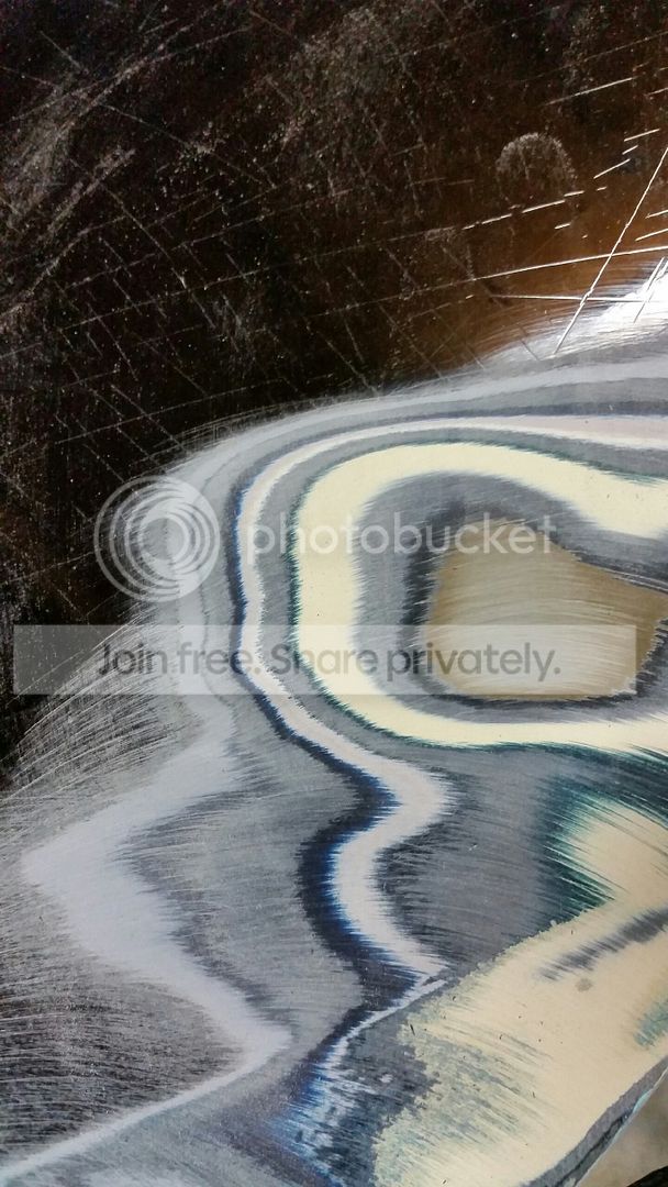

From the hatch. John said it had 5 independent coats of paint in some places!!!
More of the hatch getting stripped

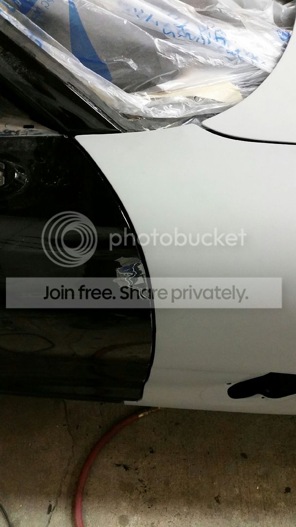

Yesterday's (Tuesday's) progress:
John said the fender's weren't that bad. They only had 2 coats of paint on them.
Unfortunately, we ran into a little snag Tuesday night. John found that when the last shop reinstalled my rear window they ignored some rust around the window support / seal area and simply caulked over it with eurothane. The plan is to cut out the window again and repair the rust before reinstalling the window.

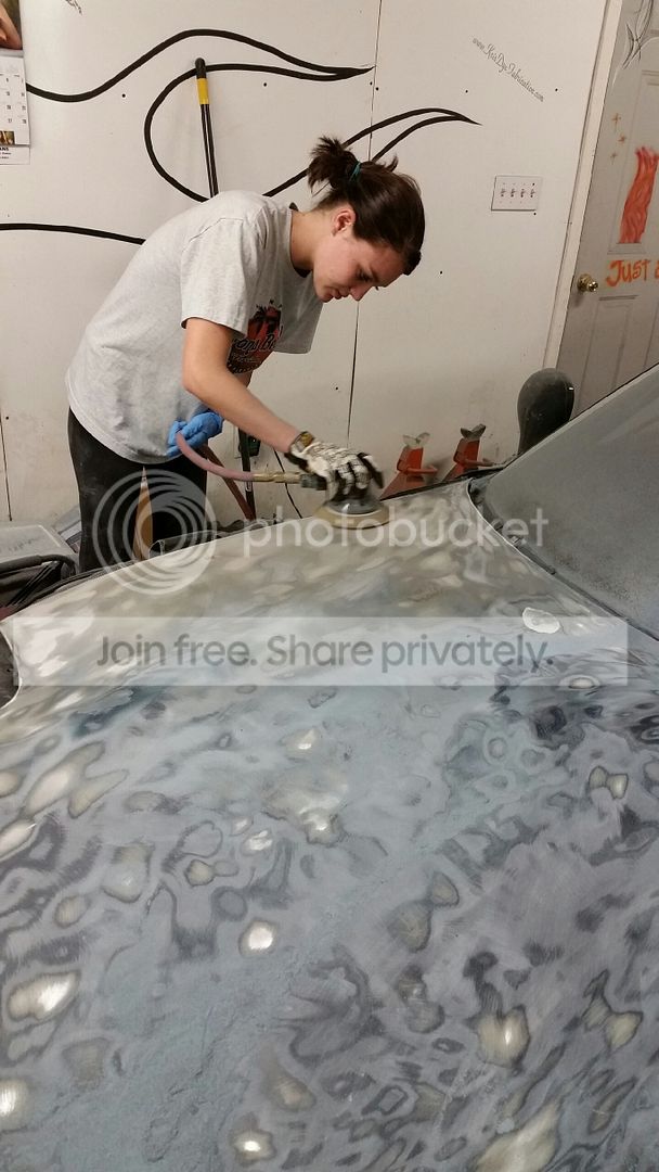

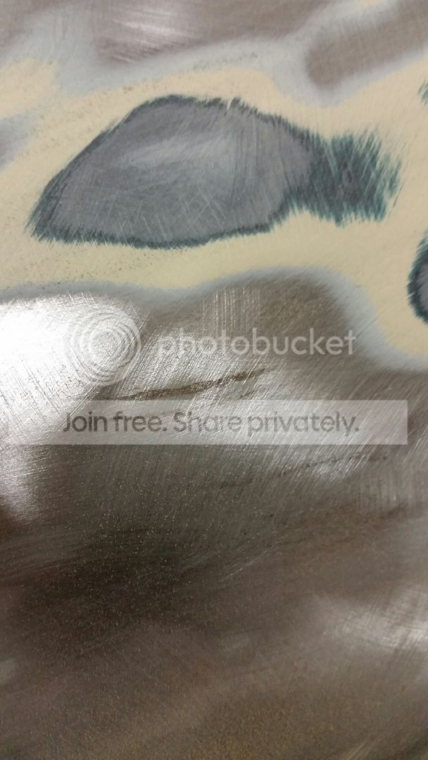

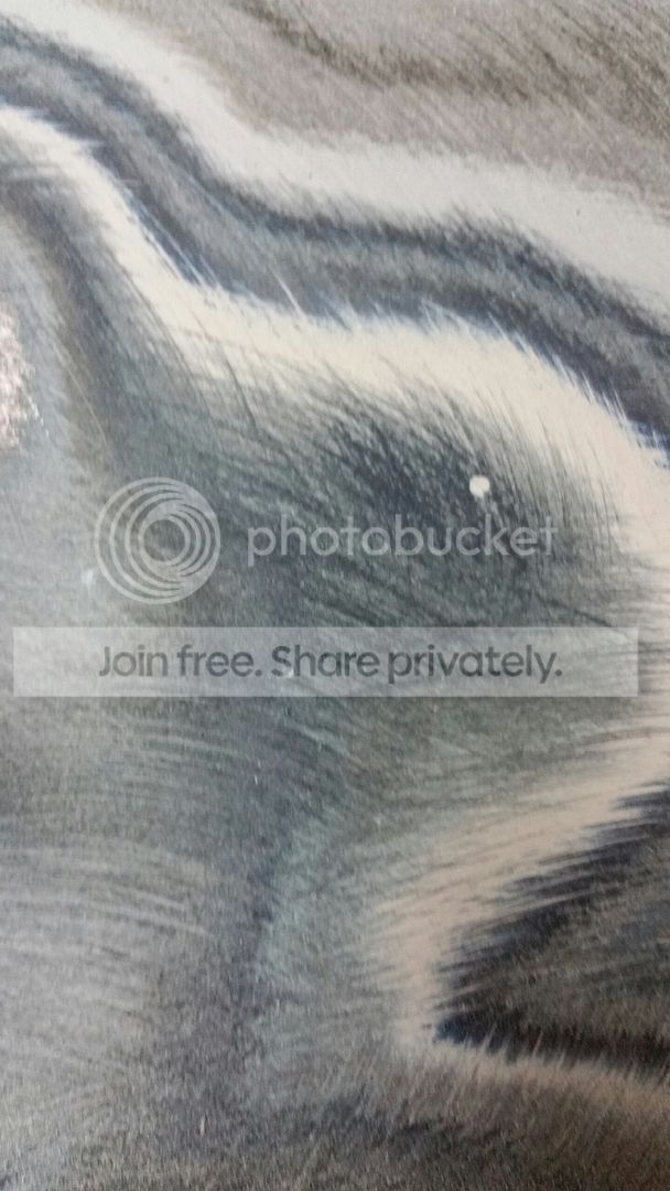

July 17, 2014, 01:22:06 PM »

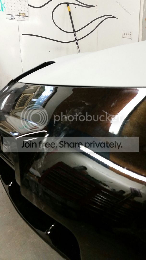

Got some good news from John. His paint prep supplier let him know that his sandpaper is around 70% off so I'm paying ~$15 for packs of sandpaper that would normally cost $40/$50!

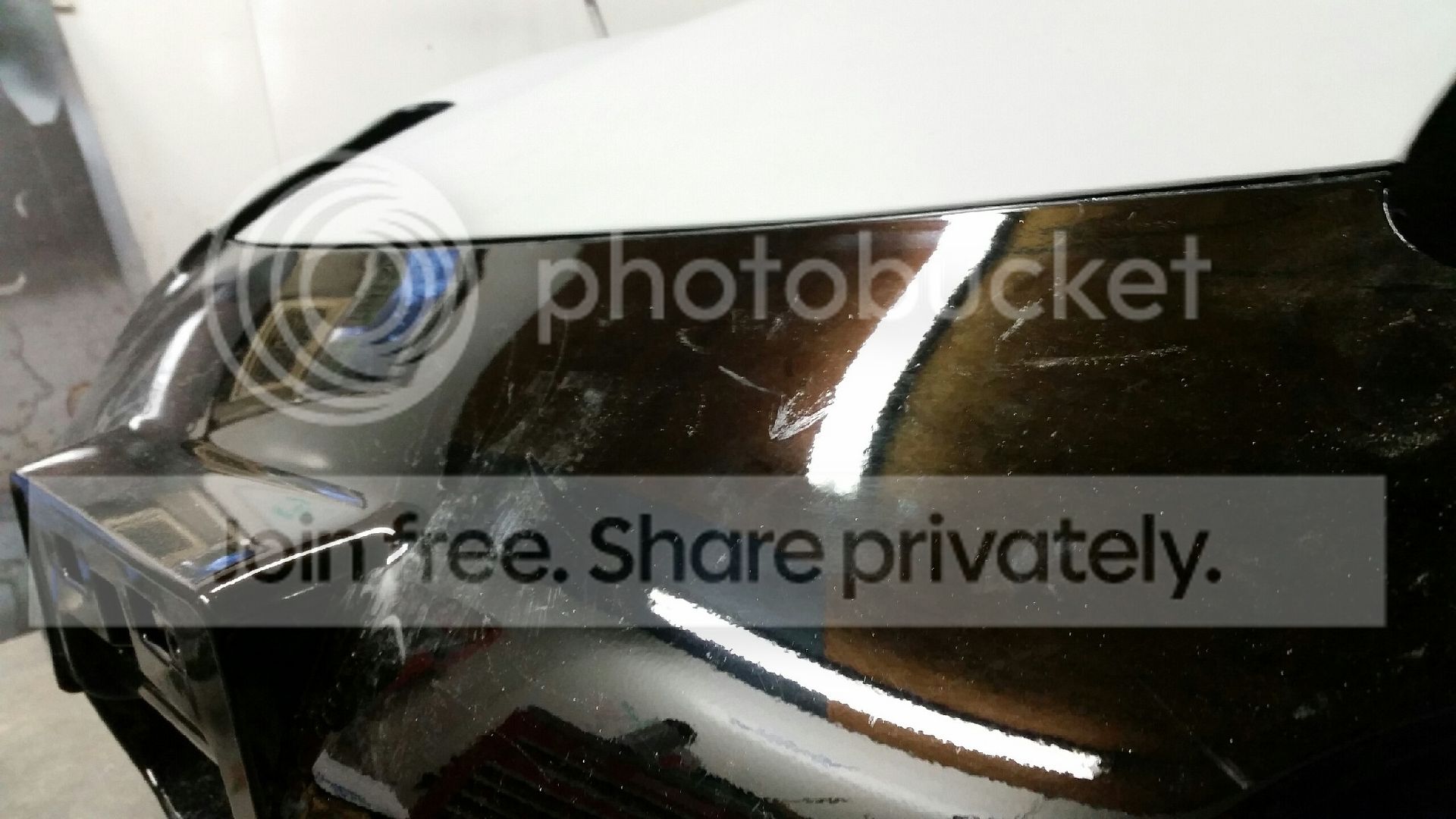

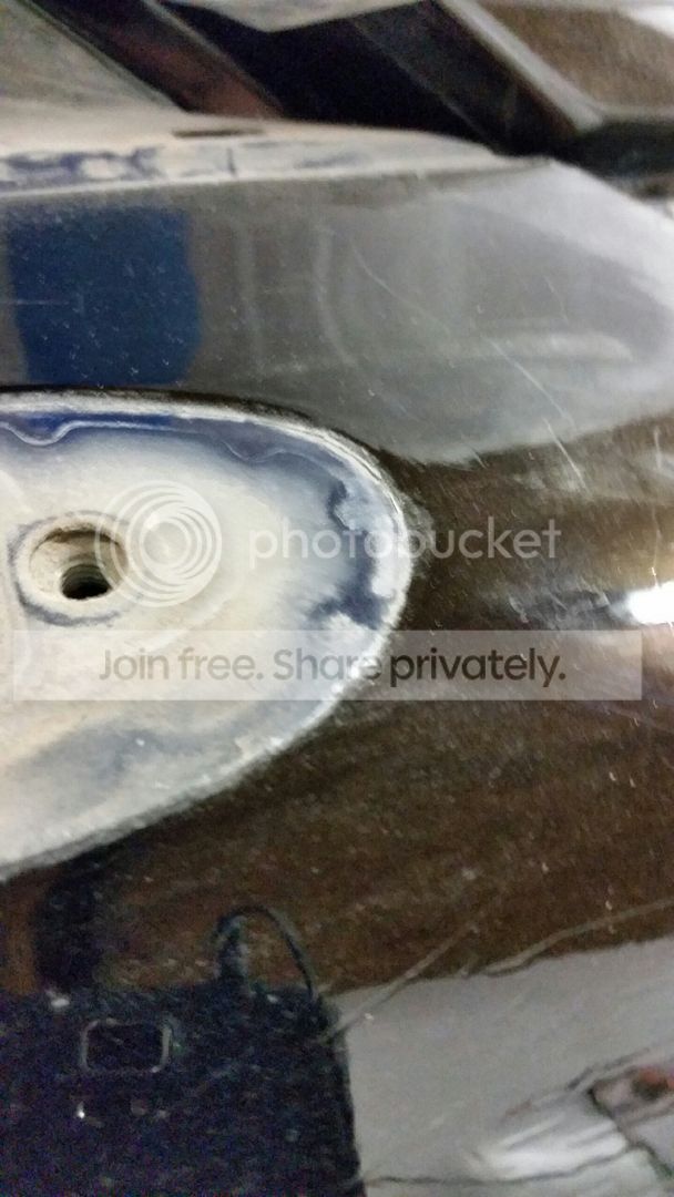

John also sent me the pic above showing how the front of my hood originally had rock chips in it and the chips were simply filled-in instead of being repaired properly.

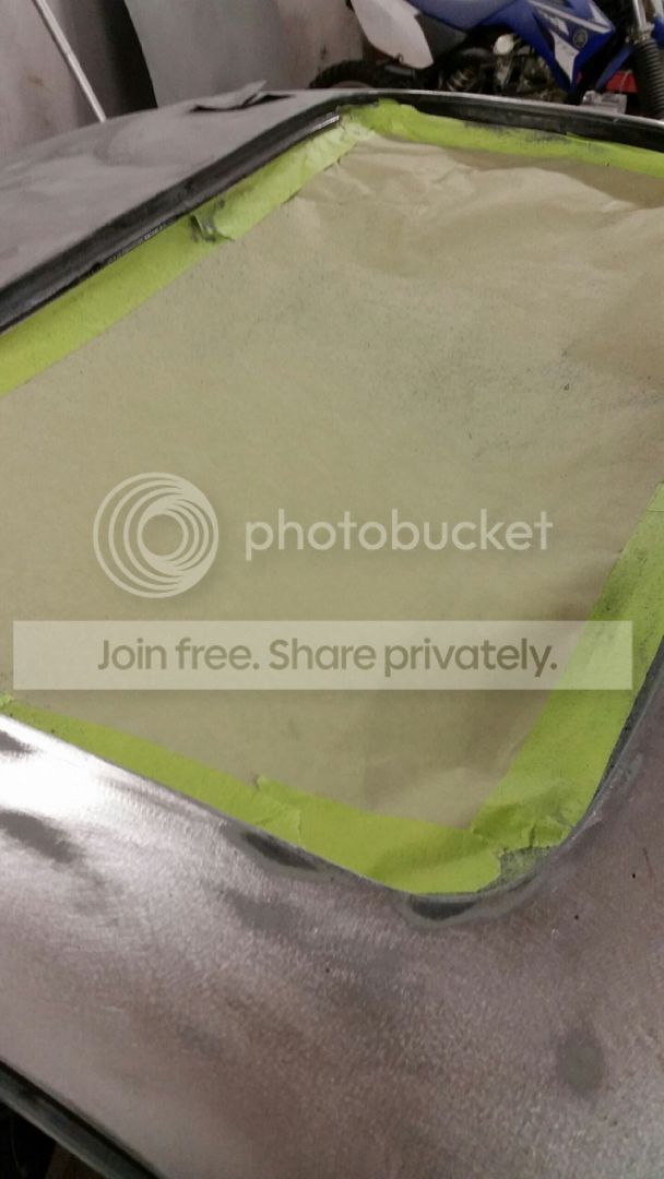

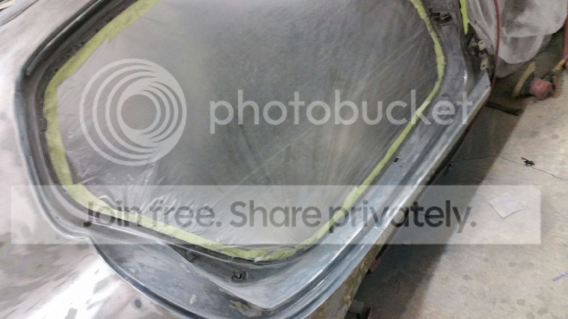

Since the last post we've decided that we definitely need to pull the rear glass for the work that needs to be done on the hatch. Among the work already scheduled, John talked to me earlier today recommending that he remove the "glue" the previous body shop used to fill my spoiler holes and weld the holes shut. I had noticed that the filled holes could be seen through the paint at the right angle and it was one of the things I mentioned when dropping off the car. Of course, I'm all about getting this done the right way and I know that filling the holes with metal will allow for seamless fill so I told John to go for it.
Today John ordered supplies so he can really get to work. By my count he's using 3 different primers. One is an epoxy primer that dries ultra hard and is more difficult to work with but he says its worth it as it doesn't shrink and helps battle sand scratches coming back after the paint cures. He also ordered high build primer as well as primer with a flex agent added for painting the bumpers. He also got a ton of sandpaper and a lot of masking supplies.

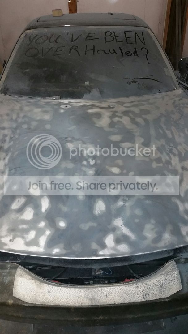

July 18, 2014, 08:20:45 AM
Supplies from yesterday

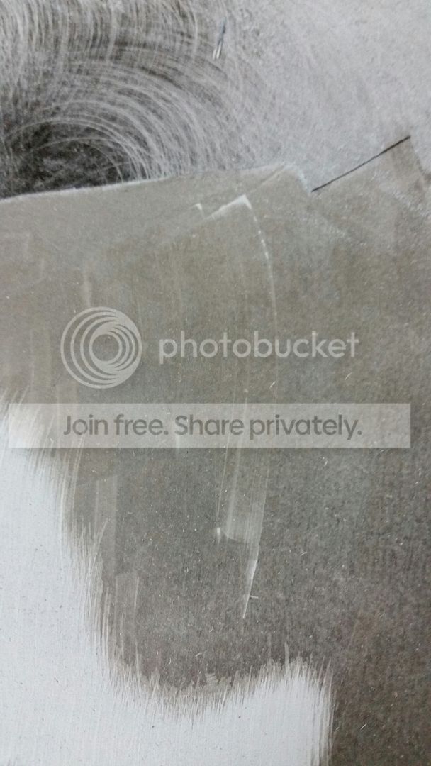

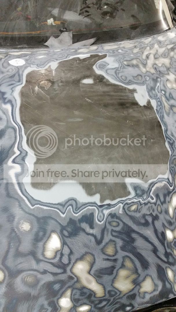

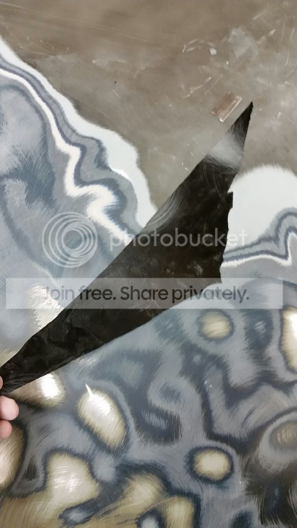

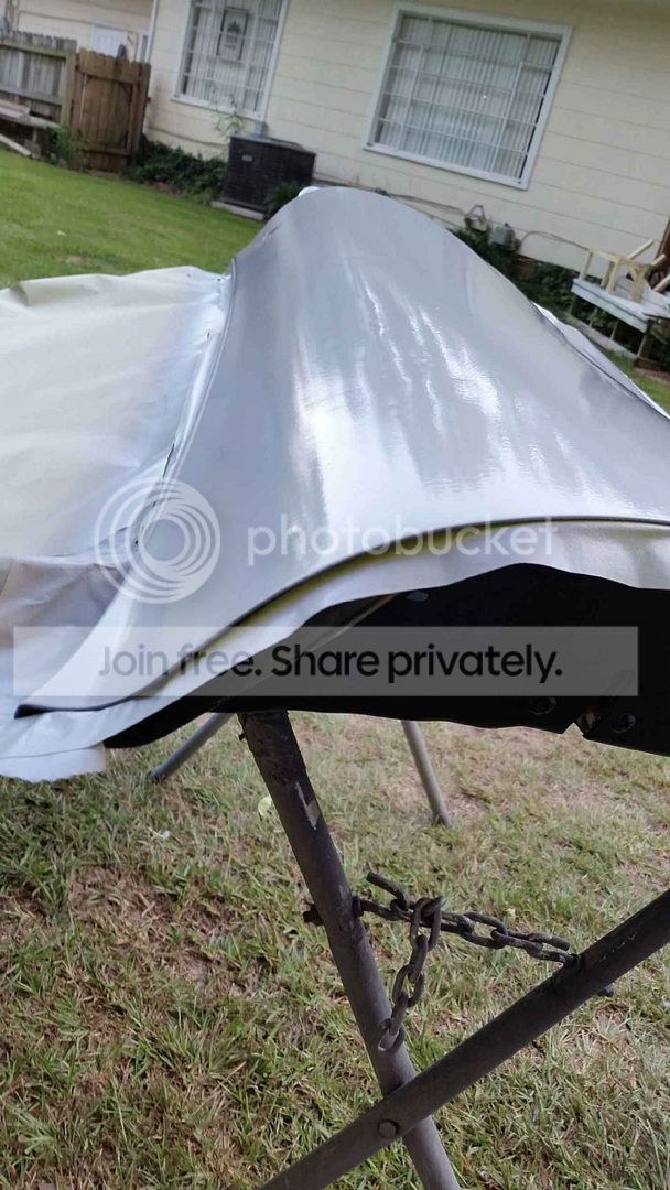

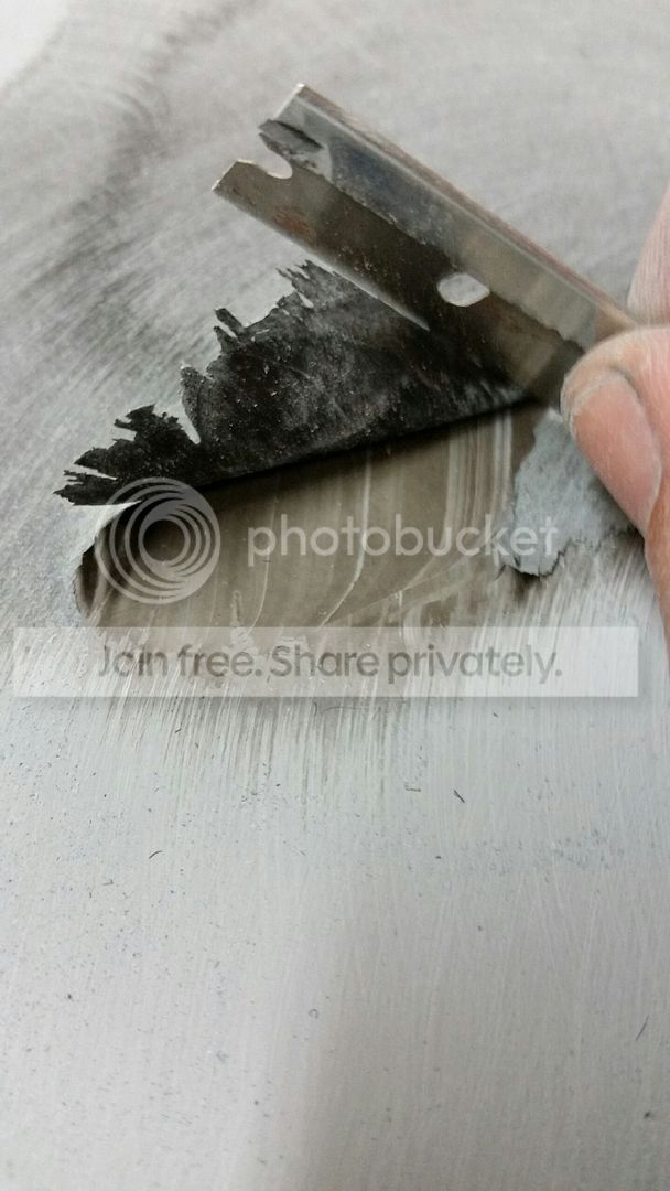

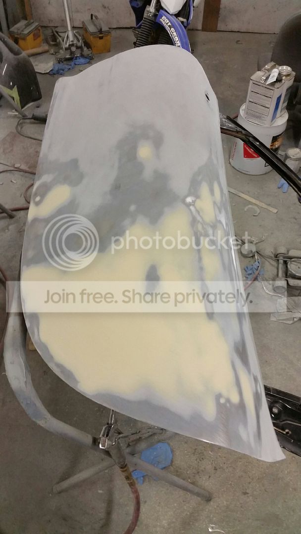

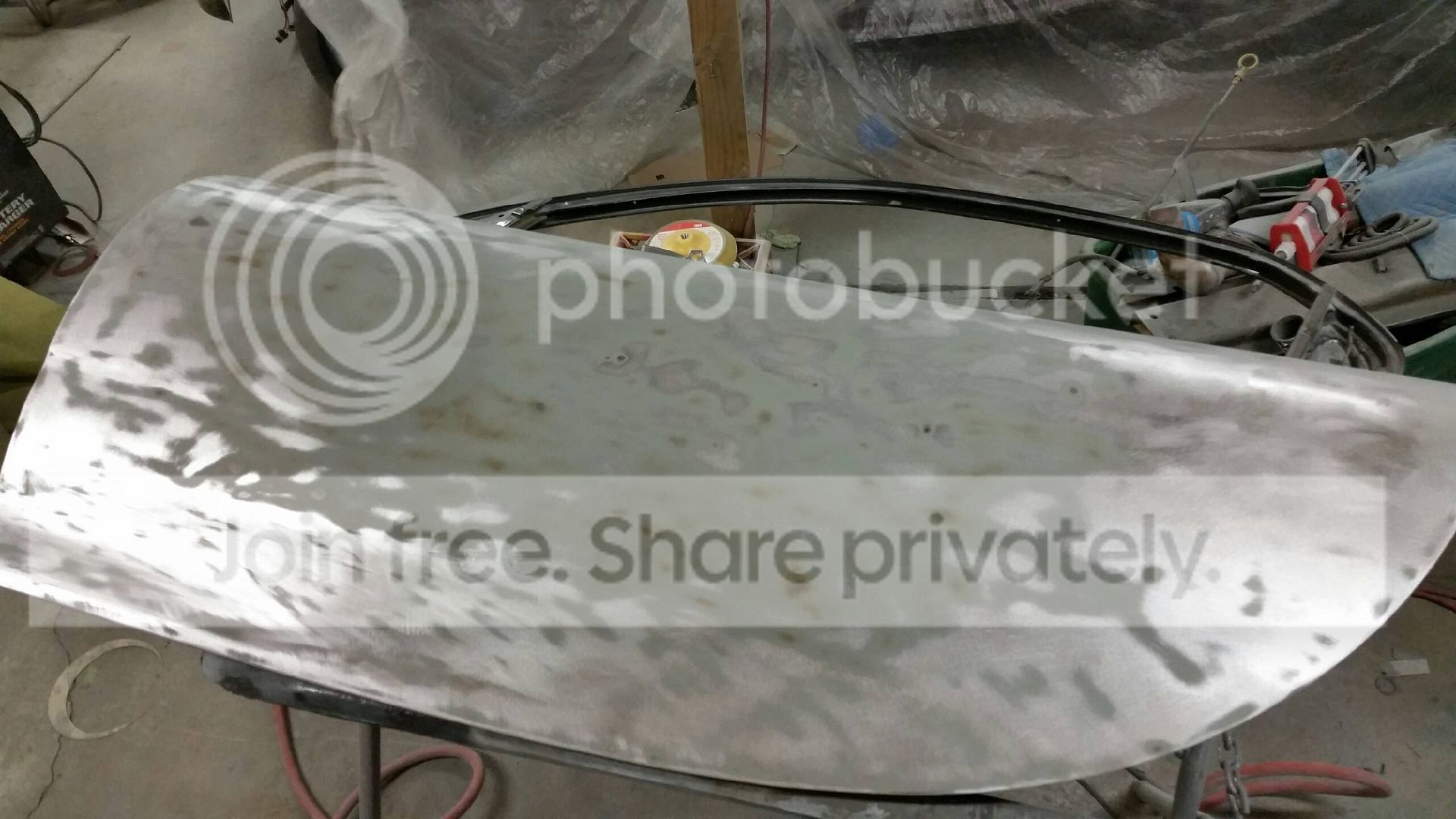

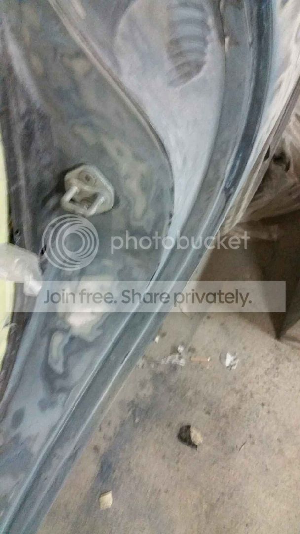

Uh oh! Started work on the hood and found adhesion problems with the newer layers of paint. It was bad enough that they were peeling off!
Picking it off in flakes
Was able to peel the center of the hood off in ~5minutes.
John's theory for the adhesion problems is that the last shop primed the hood then painted it with a thin base coat apparently with the intention of laying down a heavier coat later. Well the heavier coat didn't come quick enough (we estimate a couple of days) and it missed its window to chemically bond to the other layer of paint. In fact, the first layer seems to have cured well enough that the orange peel could be seen when peeling off the top layer.

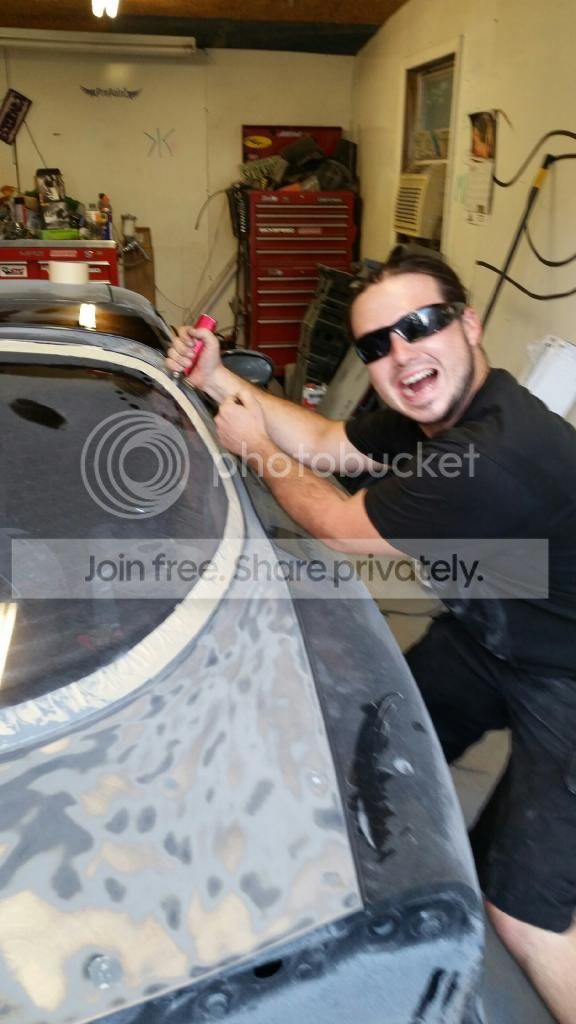

Muhahaha! Slaaave labor
Nekked
Yes sir! I am definitely feeling overhauled at the moment

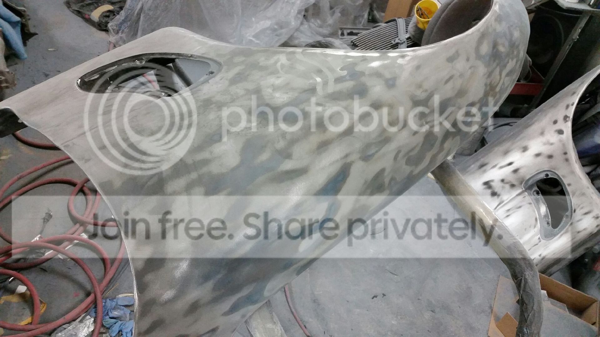

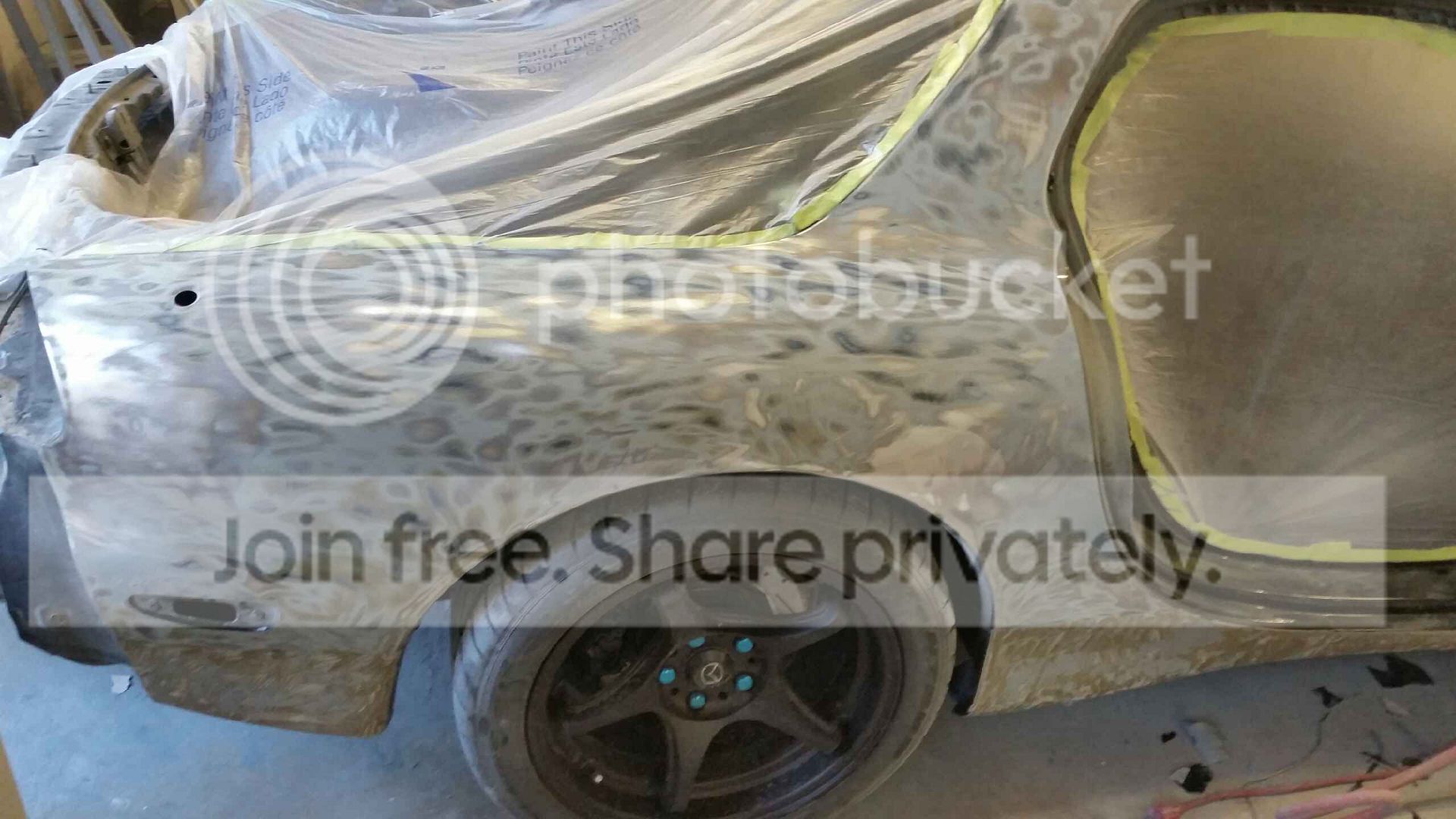

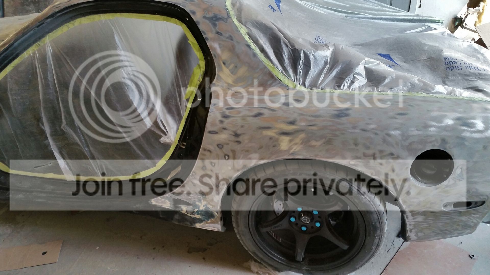

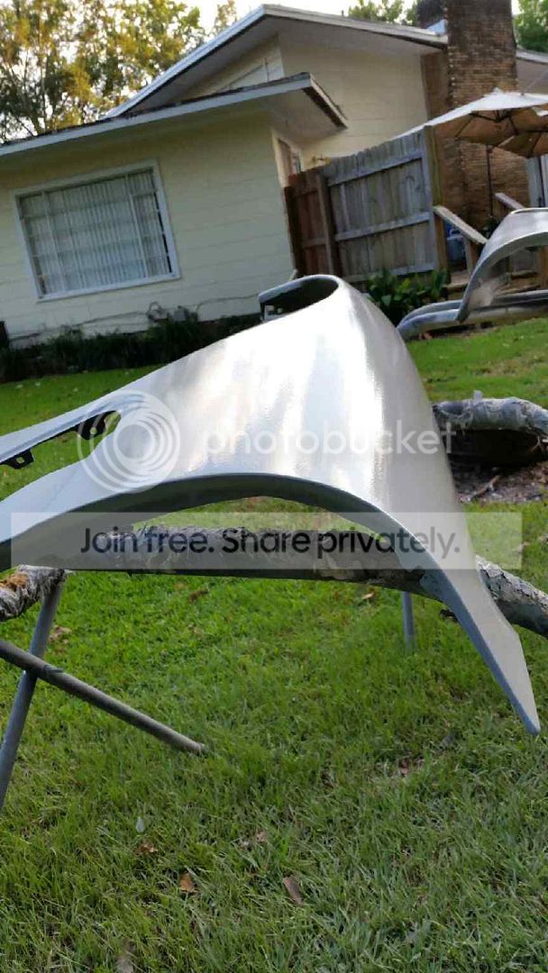

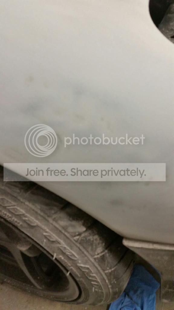

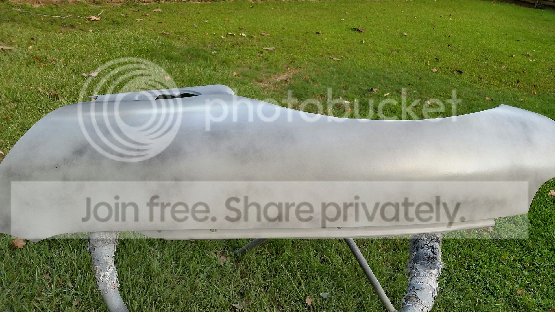

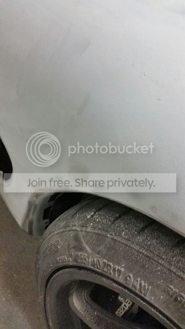

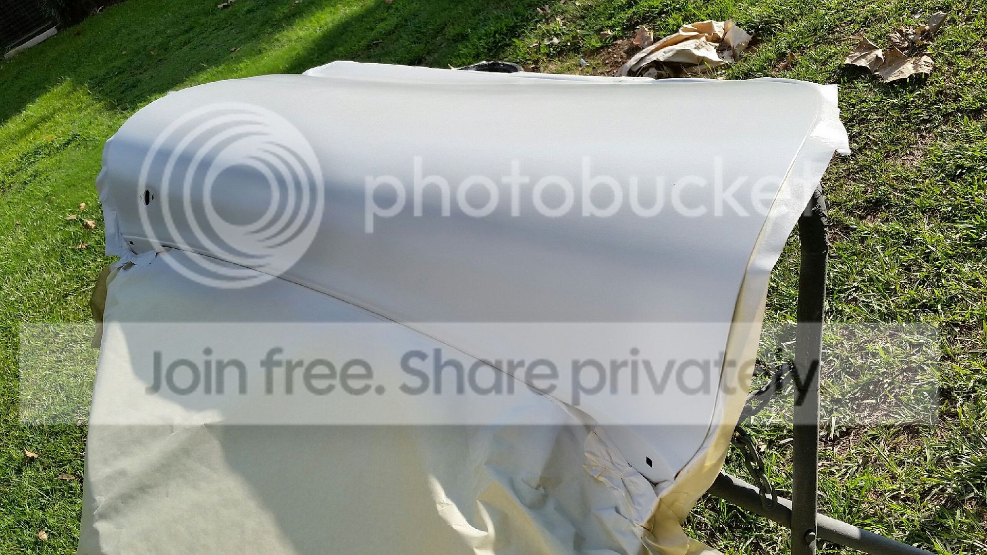

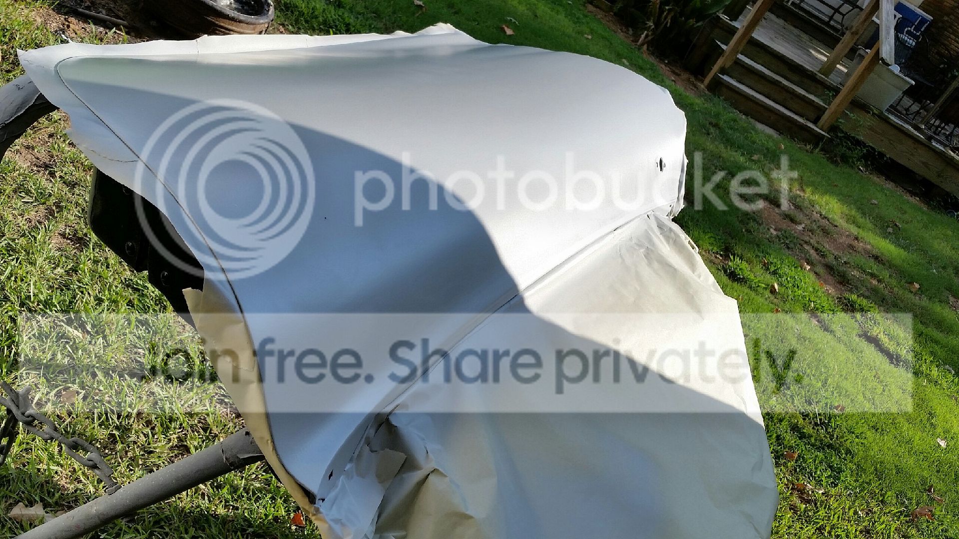

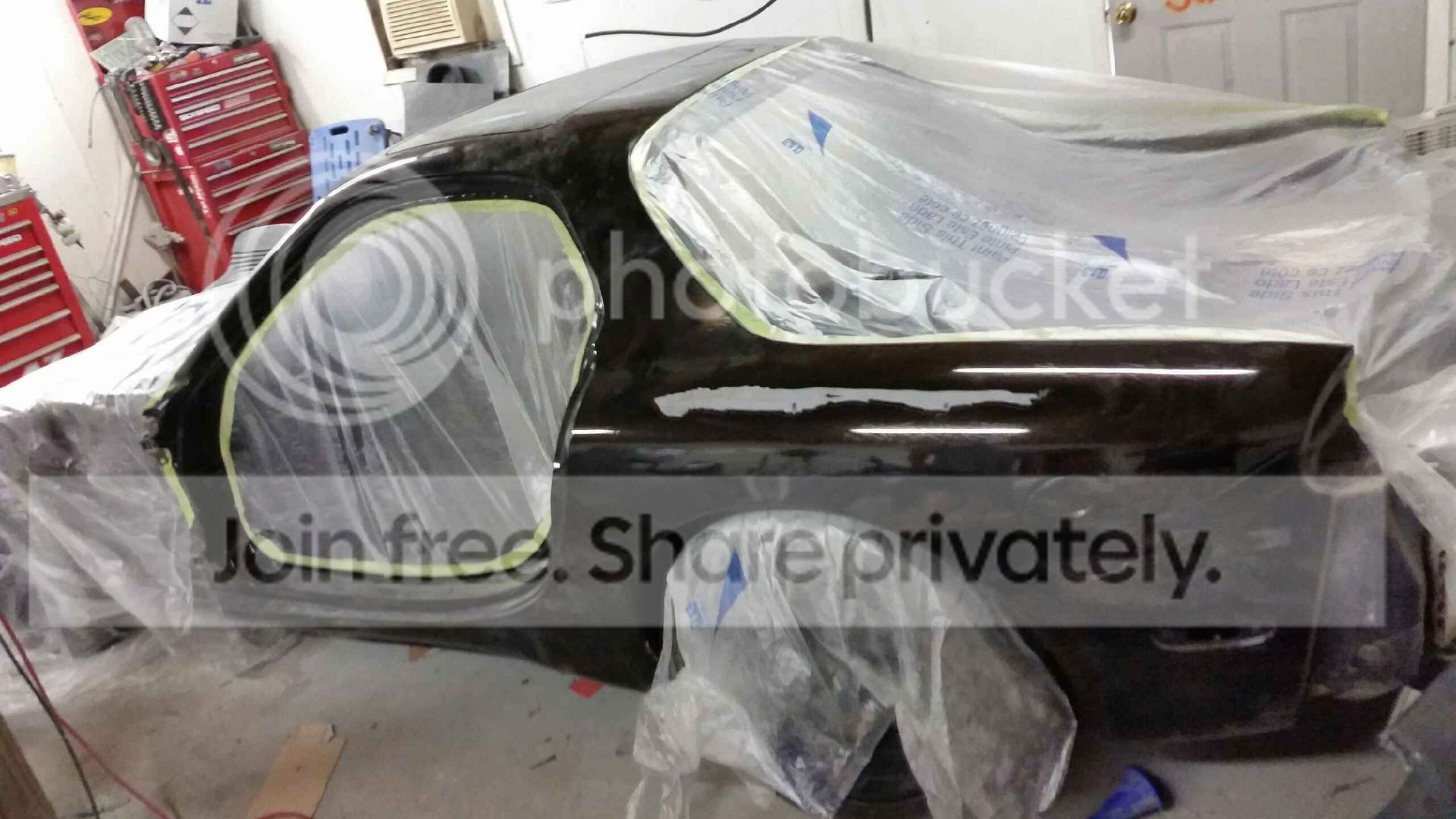

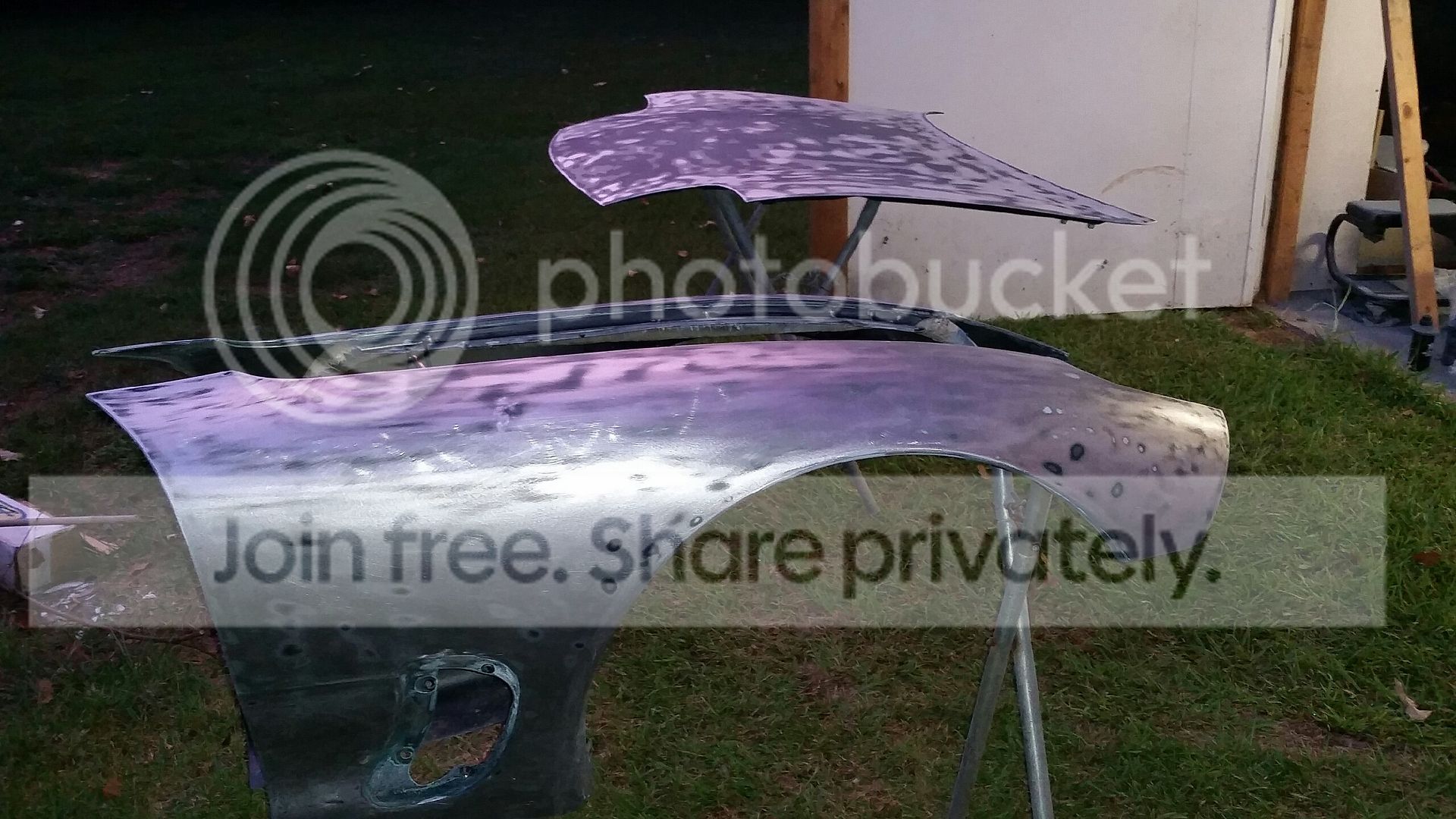

July 23, 2014, 08:50:13 AM

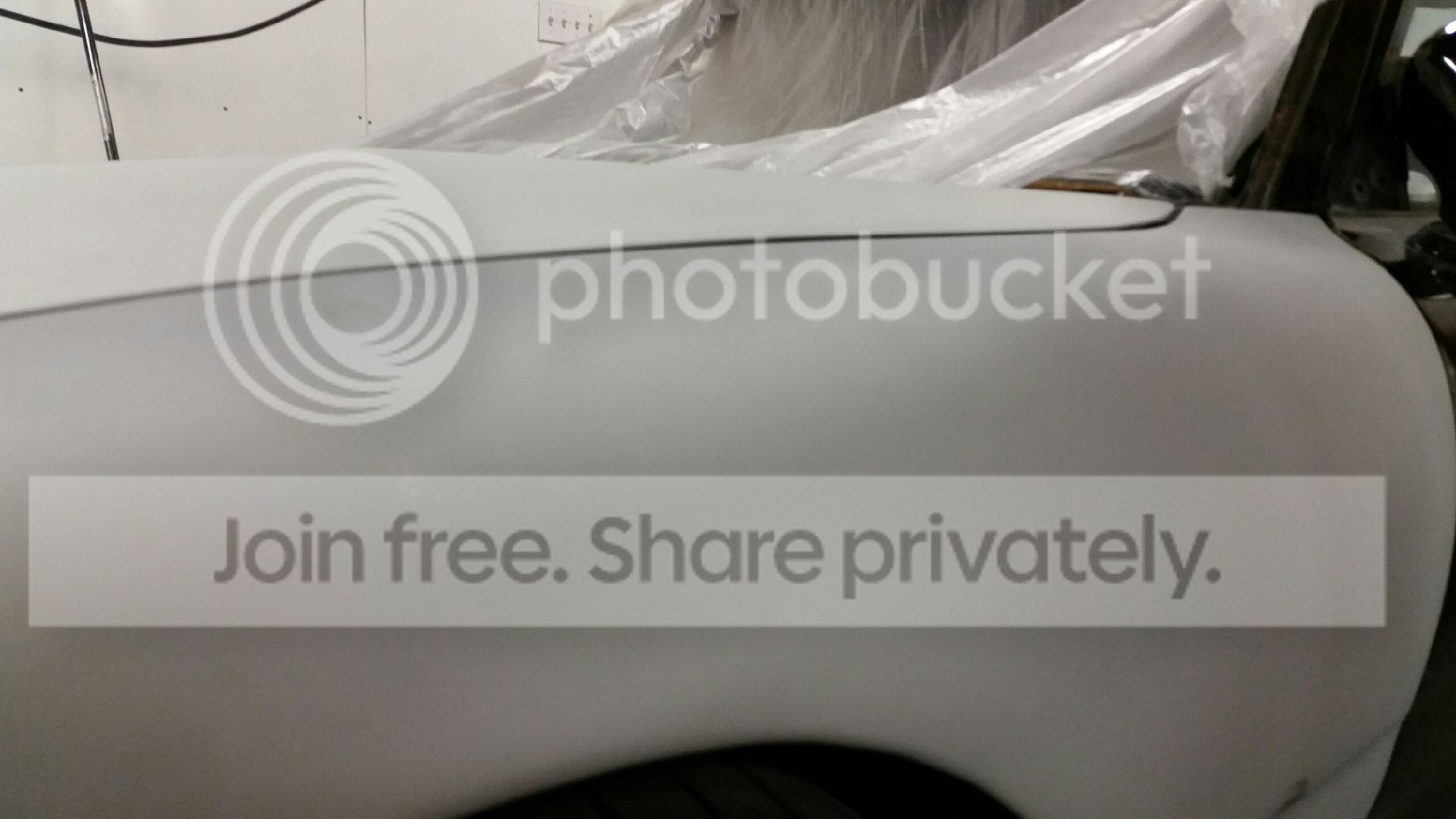

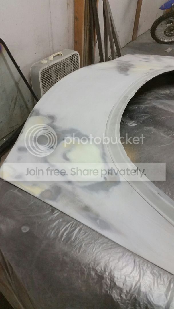

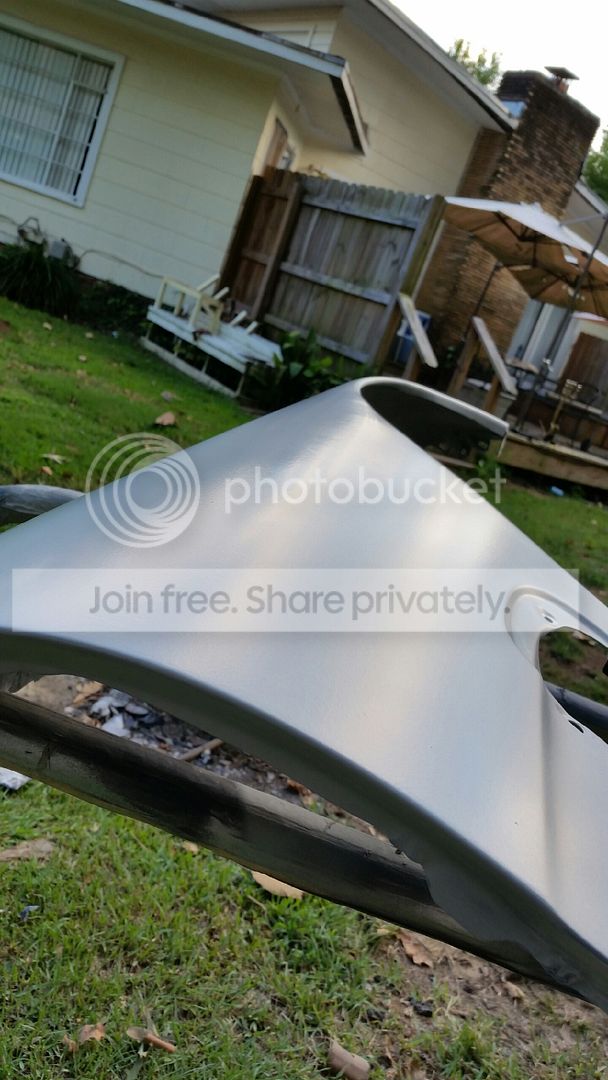

Driver's side fender has been stripped:
Its looking like the fenders, hood, and hatch will see primer pretty soon. John is just waiting to get some help cutting out the hatch glass as well as welding shut the holes in the hatch and hood.
John made the comment the other day that my car will probably see a 20lb weight reduction once all the old paint comes off lol!

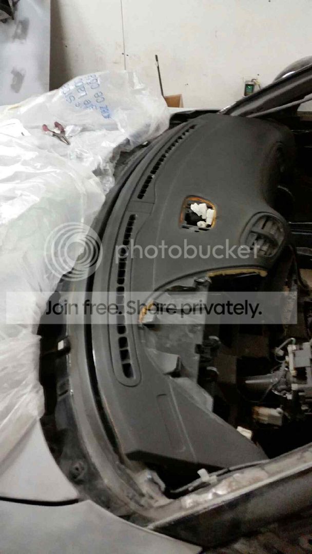

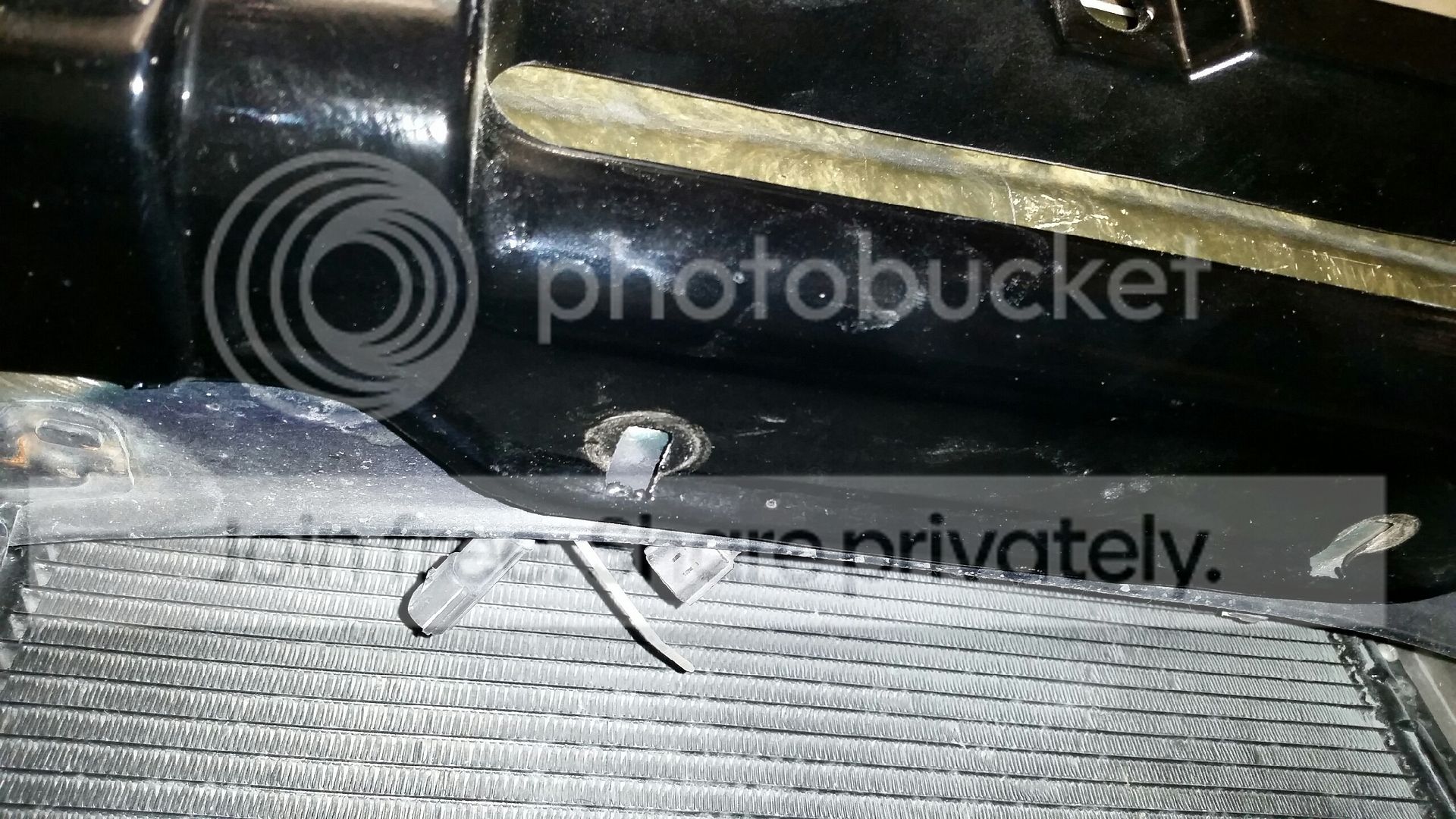

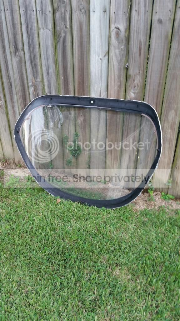

Started out last night's update with a tense moment. John had a glass expert buddy stop by and start the process of cutting out the windshield and hatch glass. Now, I've already had my hatch glass broken once during an attempt at removal by an 'expert' and I've read a LOT of stories about the hatch glass just breaking to pieces when attempting to remove it, so I didn't have a lot of faith that he'd be able to get it out. In fact John and I went ahead and priced out a new window (dealer only) which runs in the upper $400s and felt like an imminent purchase for me.
Crazy man!
Drama over! They pulled it off! I was literally jumping up and down when I got this text
These pics show some of the repair work John will be making. It shows the old and new eurothane and how the rust started to develop. I don't know if I've mentioned it but the last shop apparently broke my rear hatch, replaced it, and didn't mention it to me. The only way I knew about it is because I found glass rattling around in my hatch. Unfortunately they didn't clean up some surface rust around the window mount and eurothaned over it making a nice little present to find later. Thankfully John is a perfectionist and is going to make sure the window supports are repaired and sealed against future corrosion

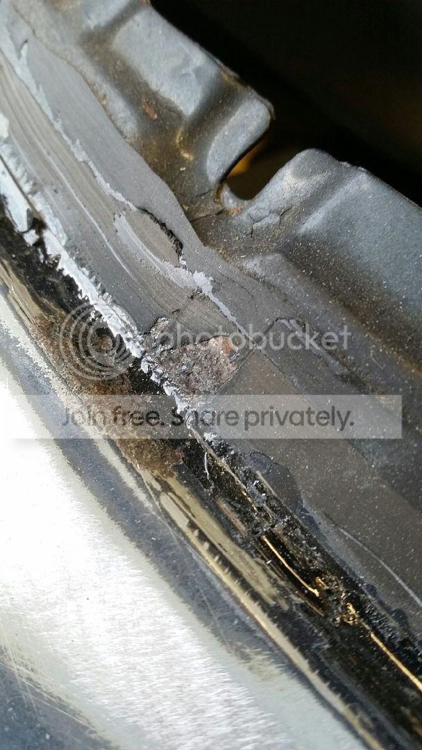

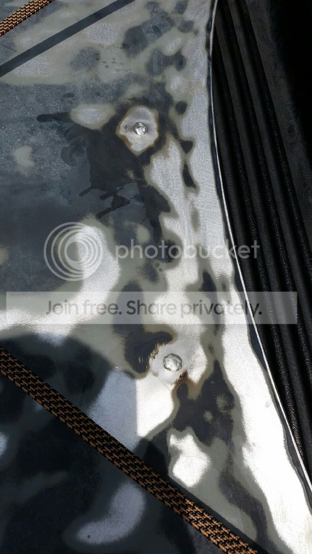

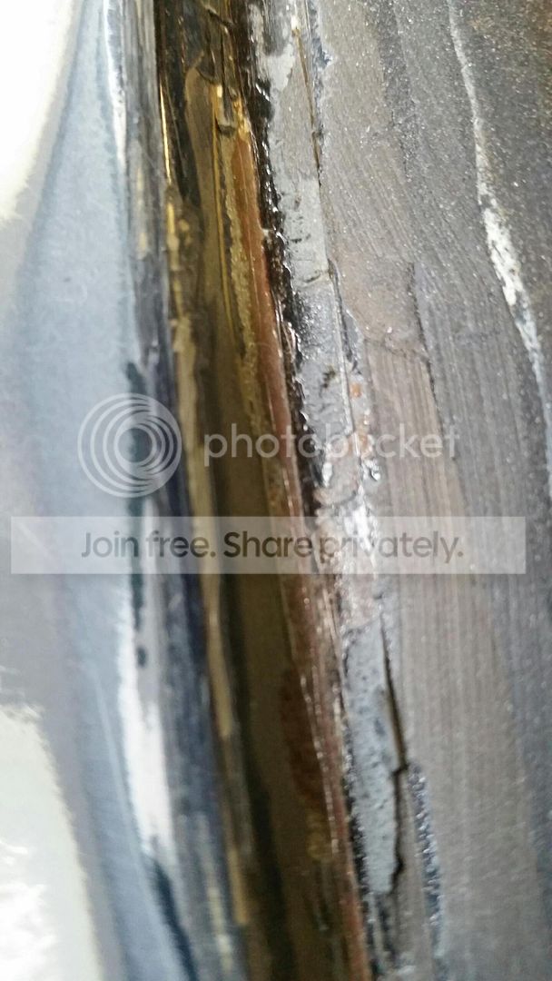

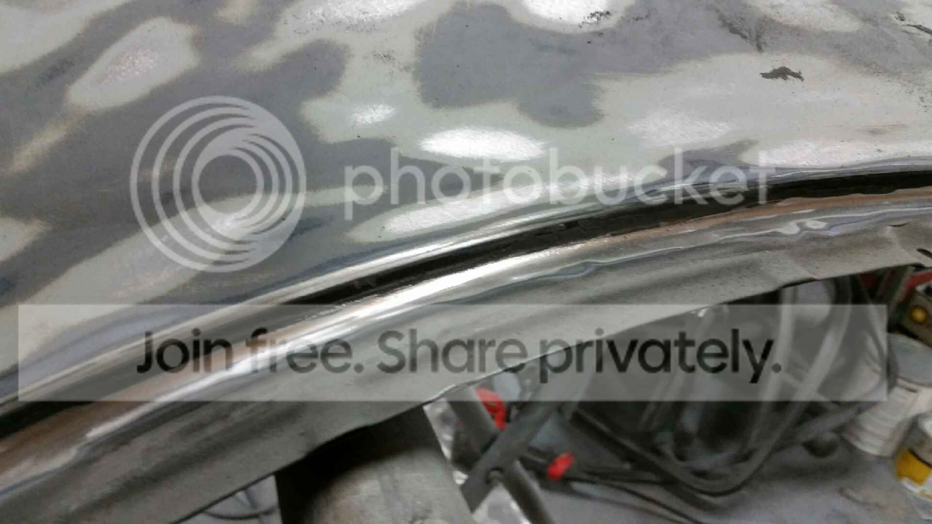

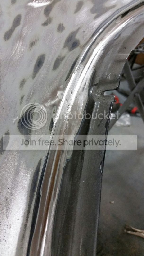

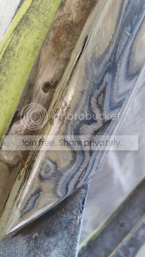

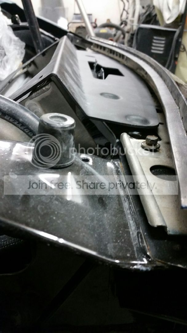

We discovered some other not so nice stuff when pulling the front windshield:
The windshield was installed too low and was basically resting on the firewall cowl panel. They had also broken and re-glued the window 'stops' so that's something I'll be ordering here shortly. For those of you who don't already know, I've been driving with a broken windshield ever since I picked up the roller 5 years ago. It was a big circular baseball looking crack near the center of the windshield. It'll be nice driving the car with a brand new one!

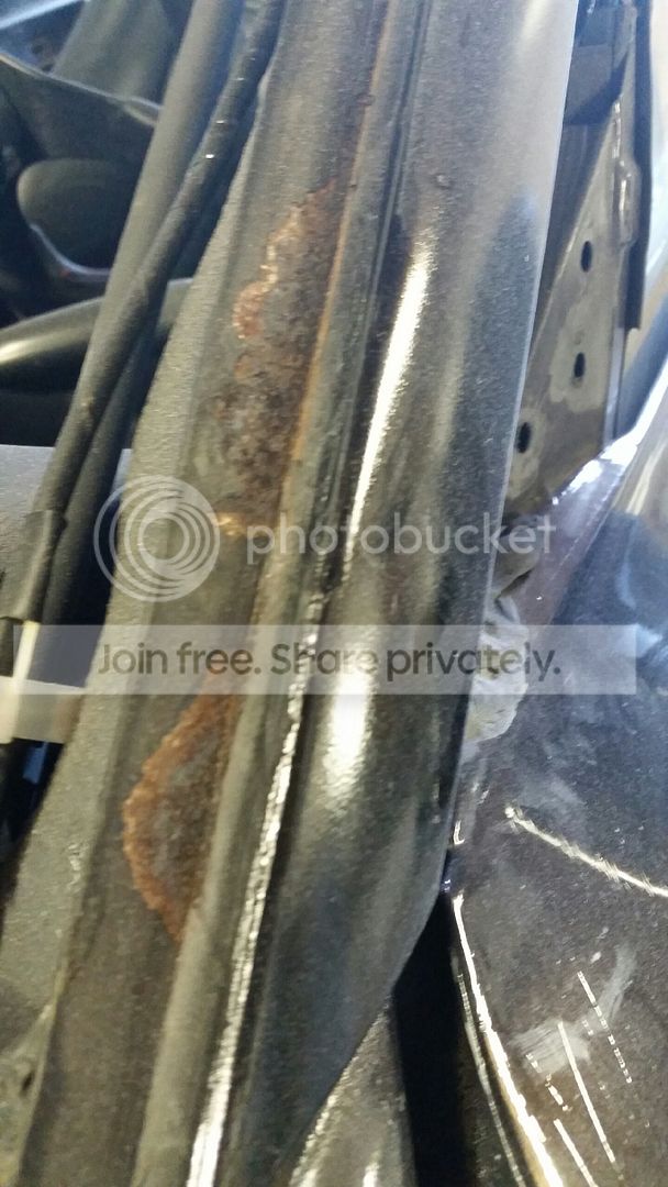

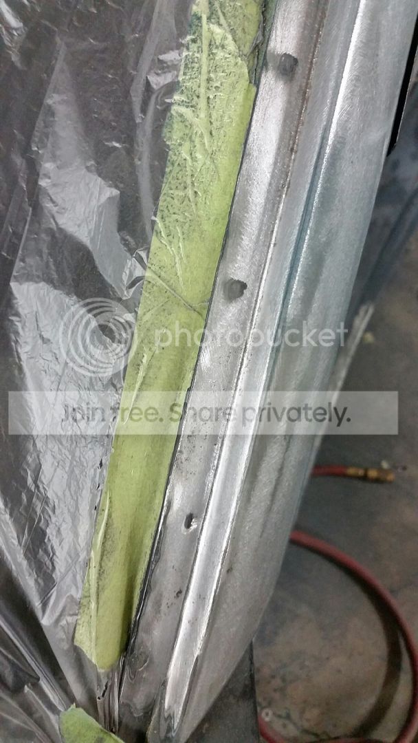

And another picture of the rust on the front windshield post. This will receive the same treatment as the rear window supports

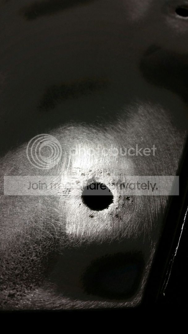

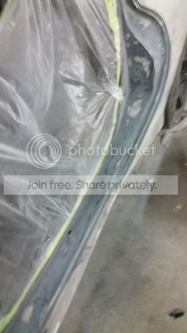

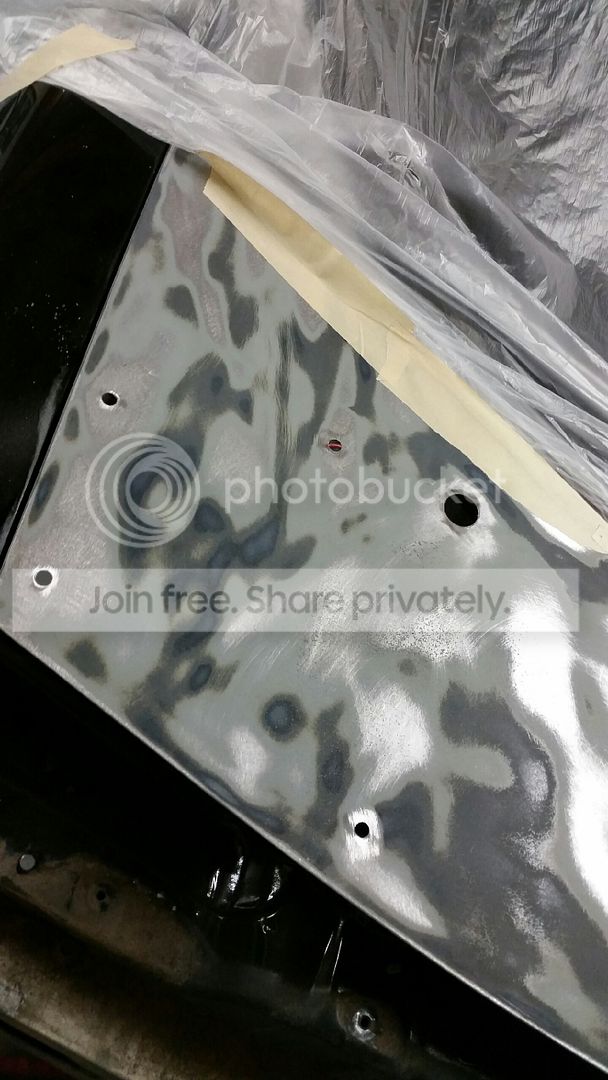

Popping out the glue used to fill the hatch holes

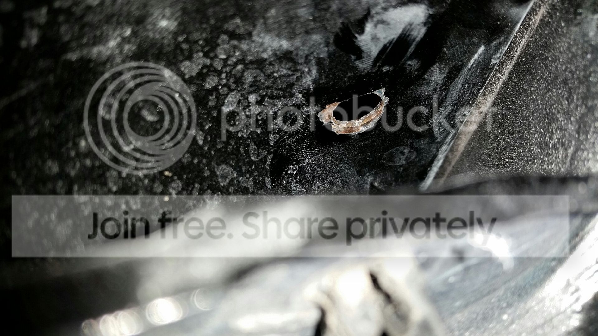

A little bit of rust around the hatch holes that will be taken care of before welding them shut and repainting

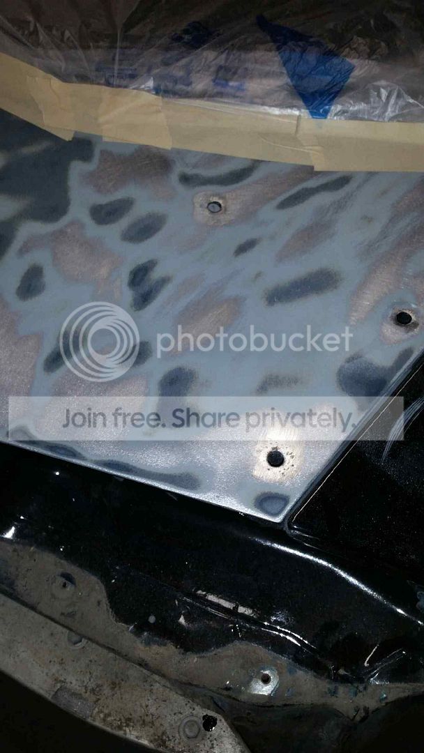

Getting the steel and aluminum patch plates ready for welding shut the holes on my hatch and hood.
Mocked up aluminum patch plate on the hood's windshield squirter hole.
John's planning on dropping my hood off today to have the windshield squirter holes welded shut.

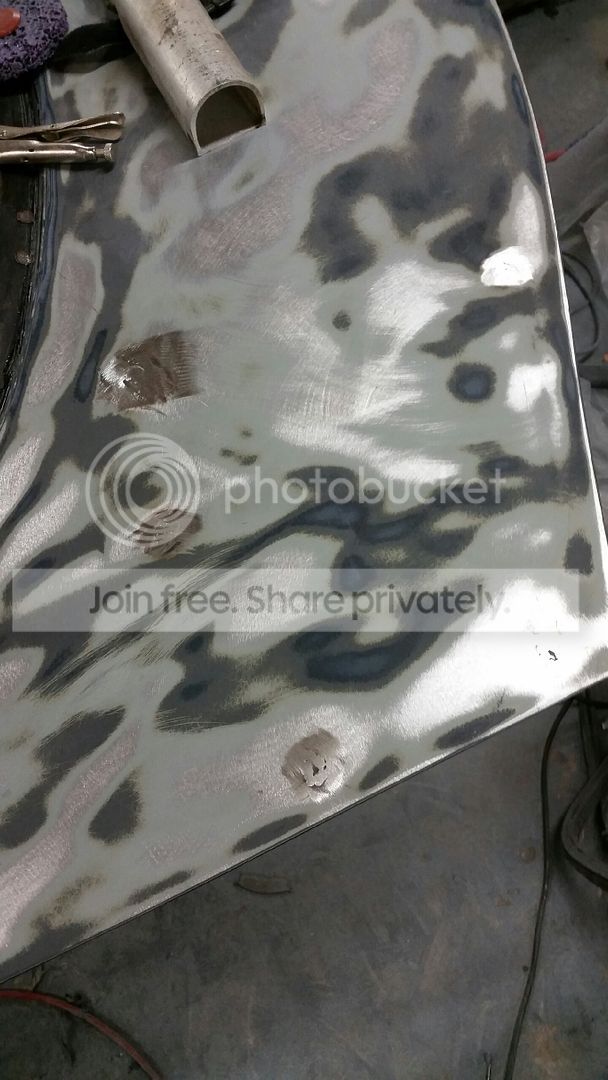

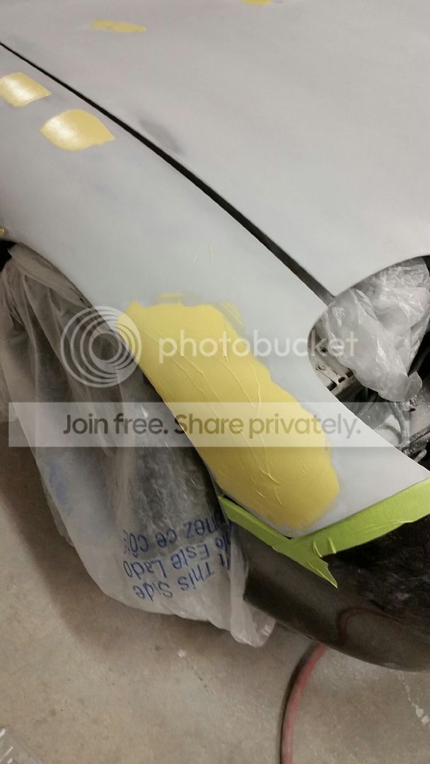

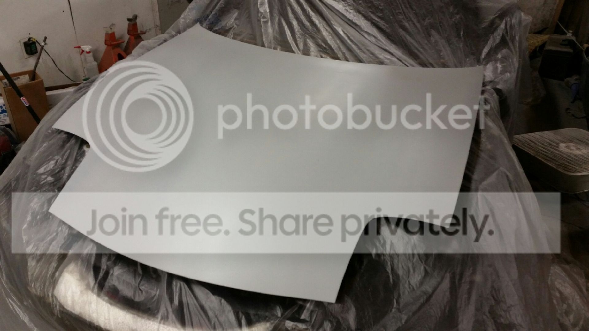

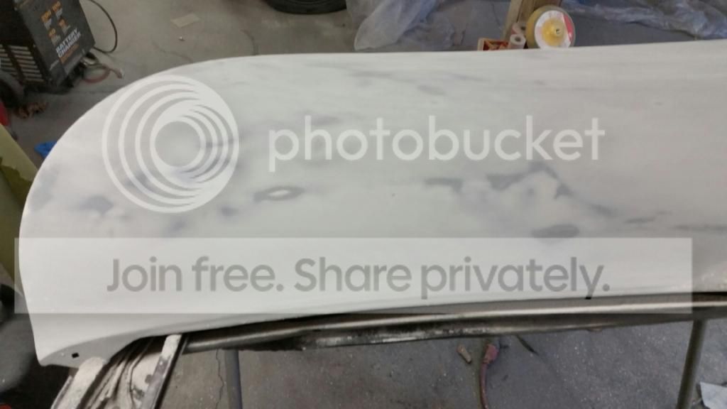

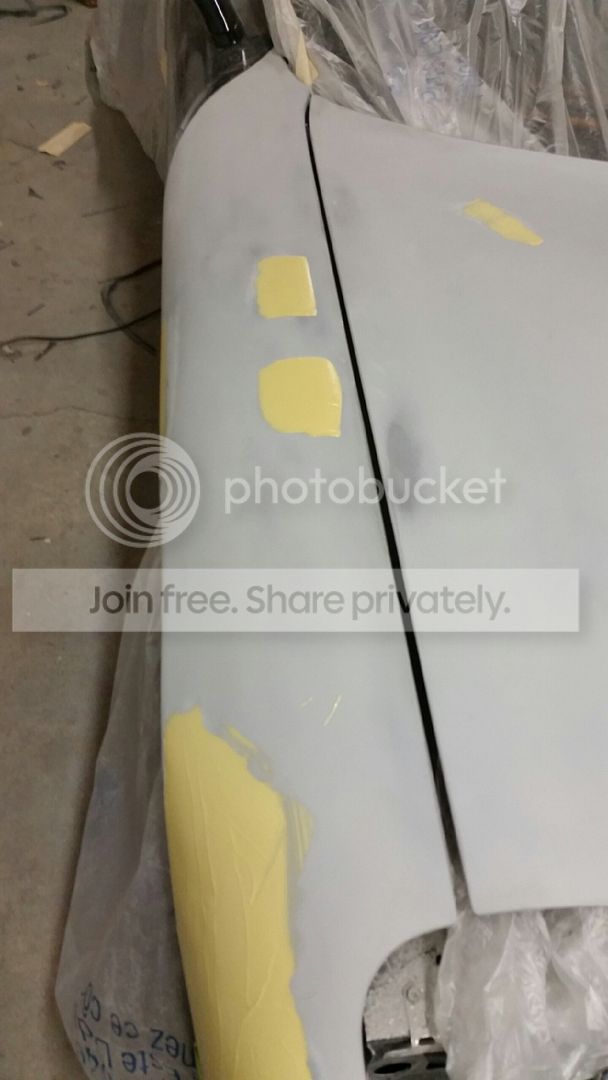

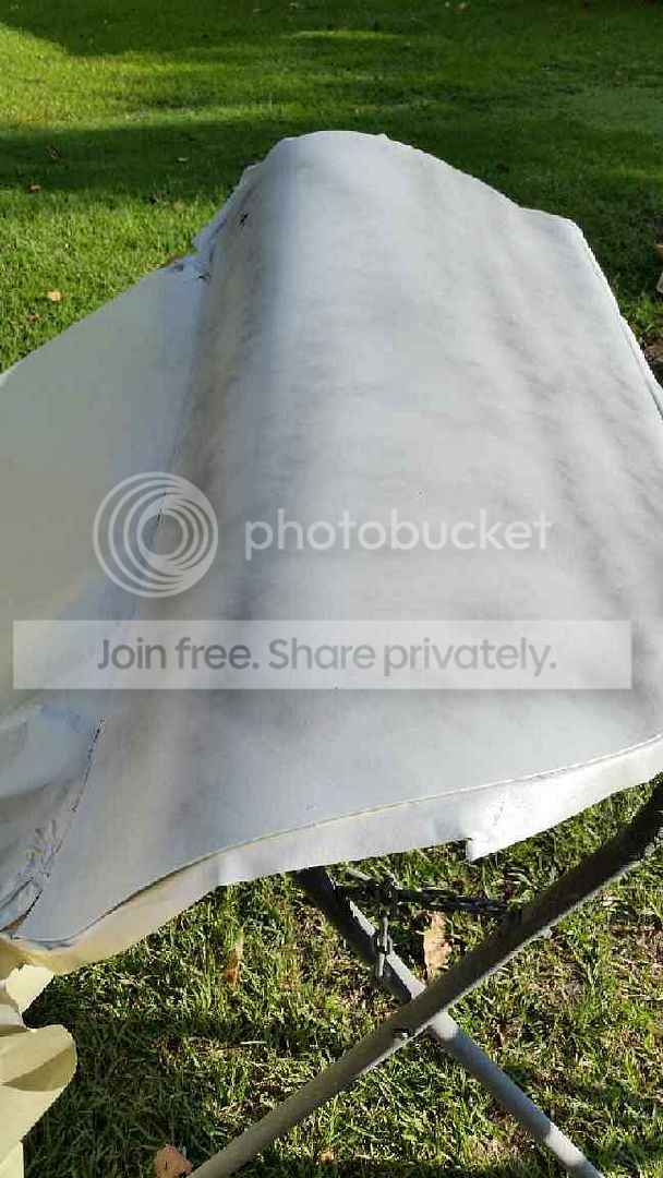

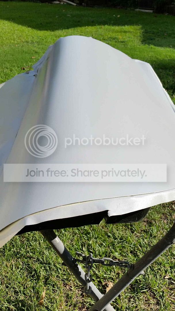

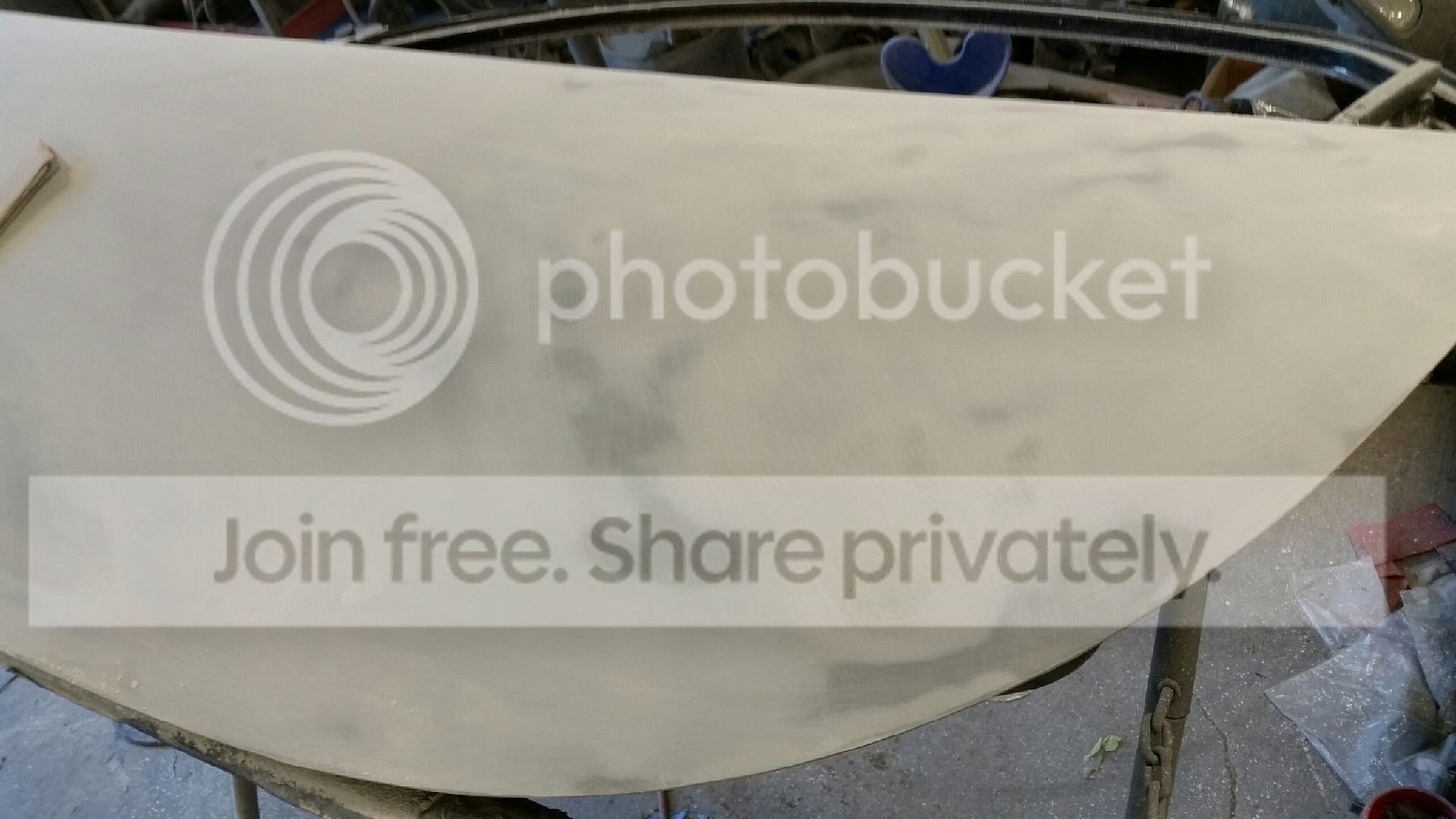

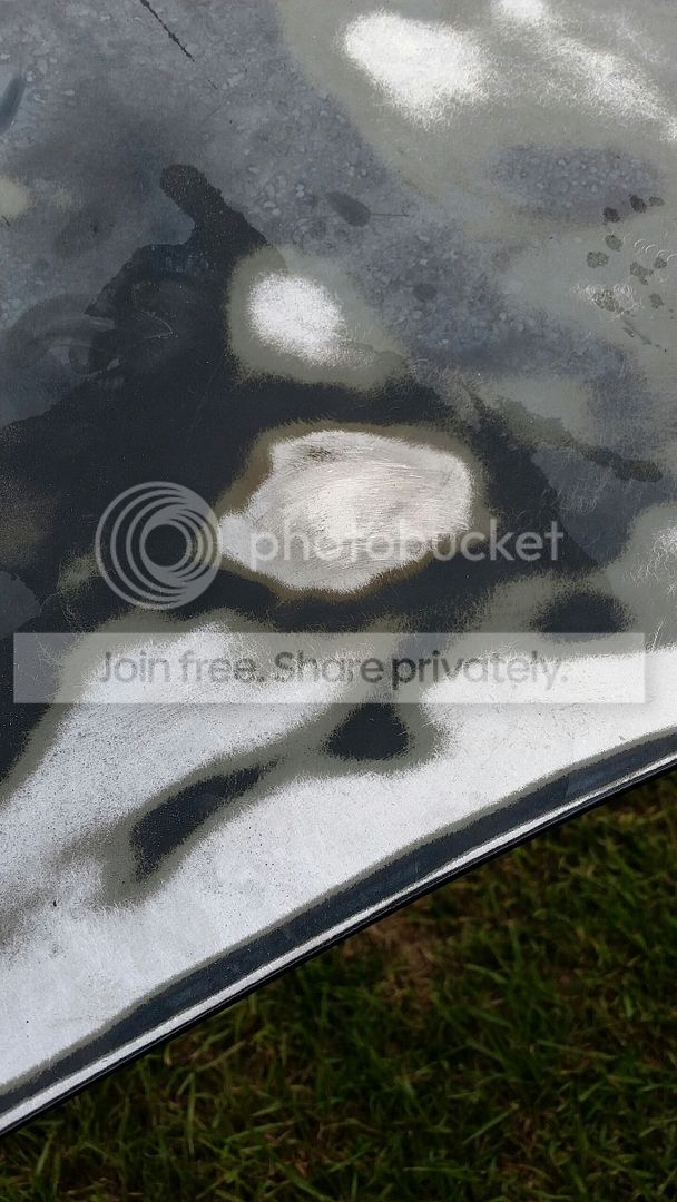

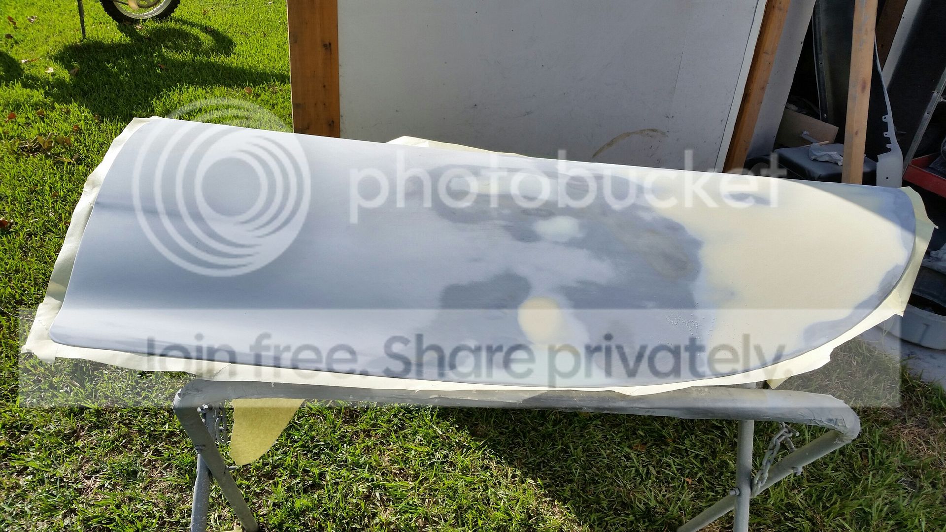

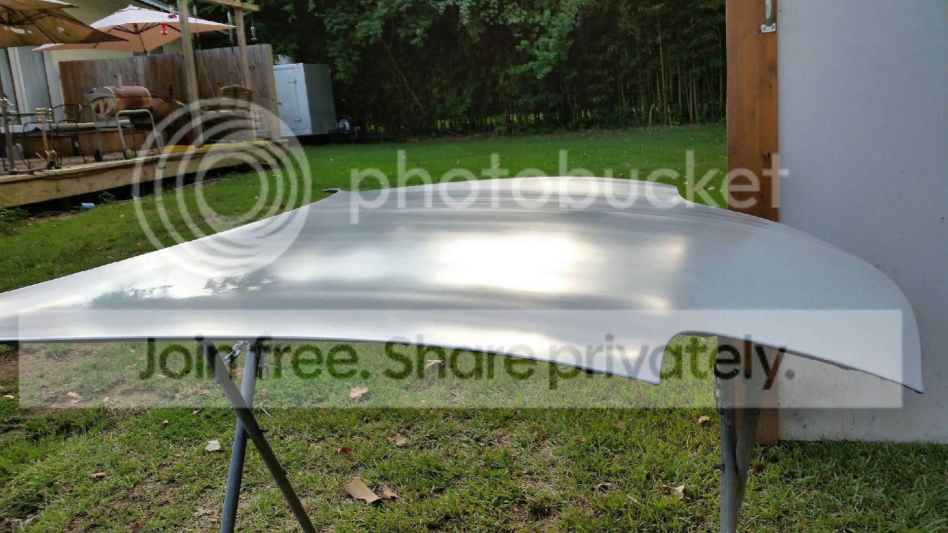

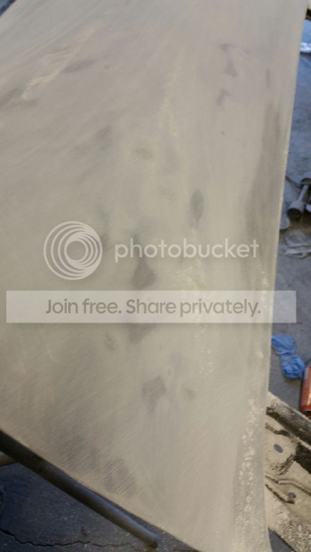

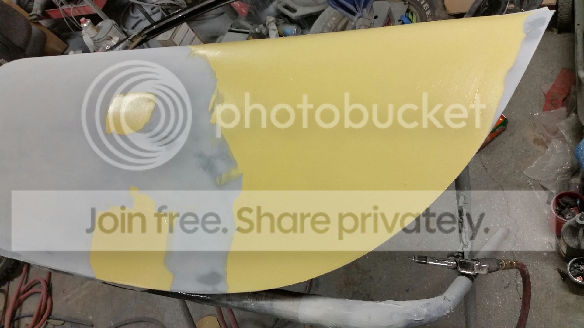

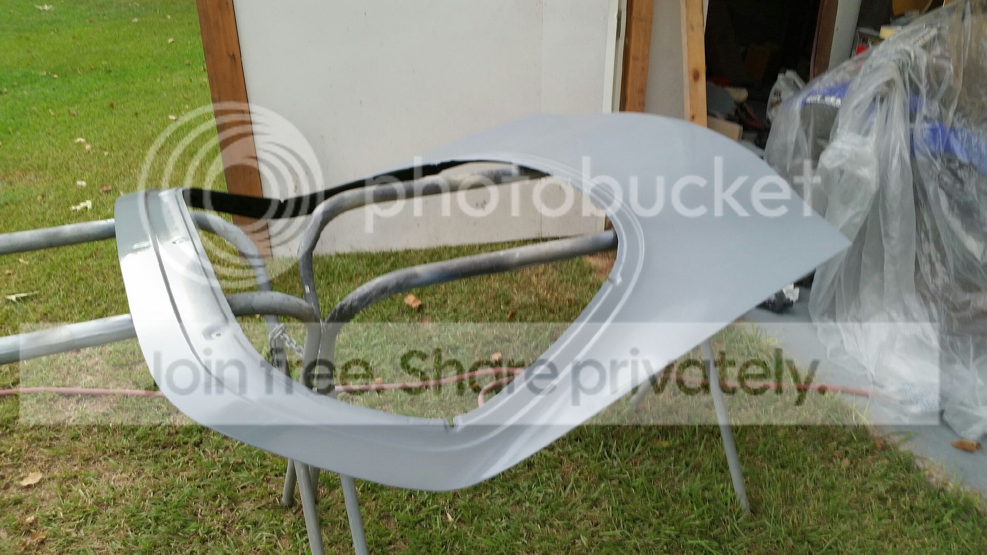

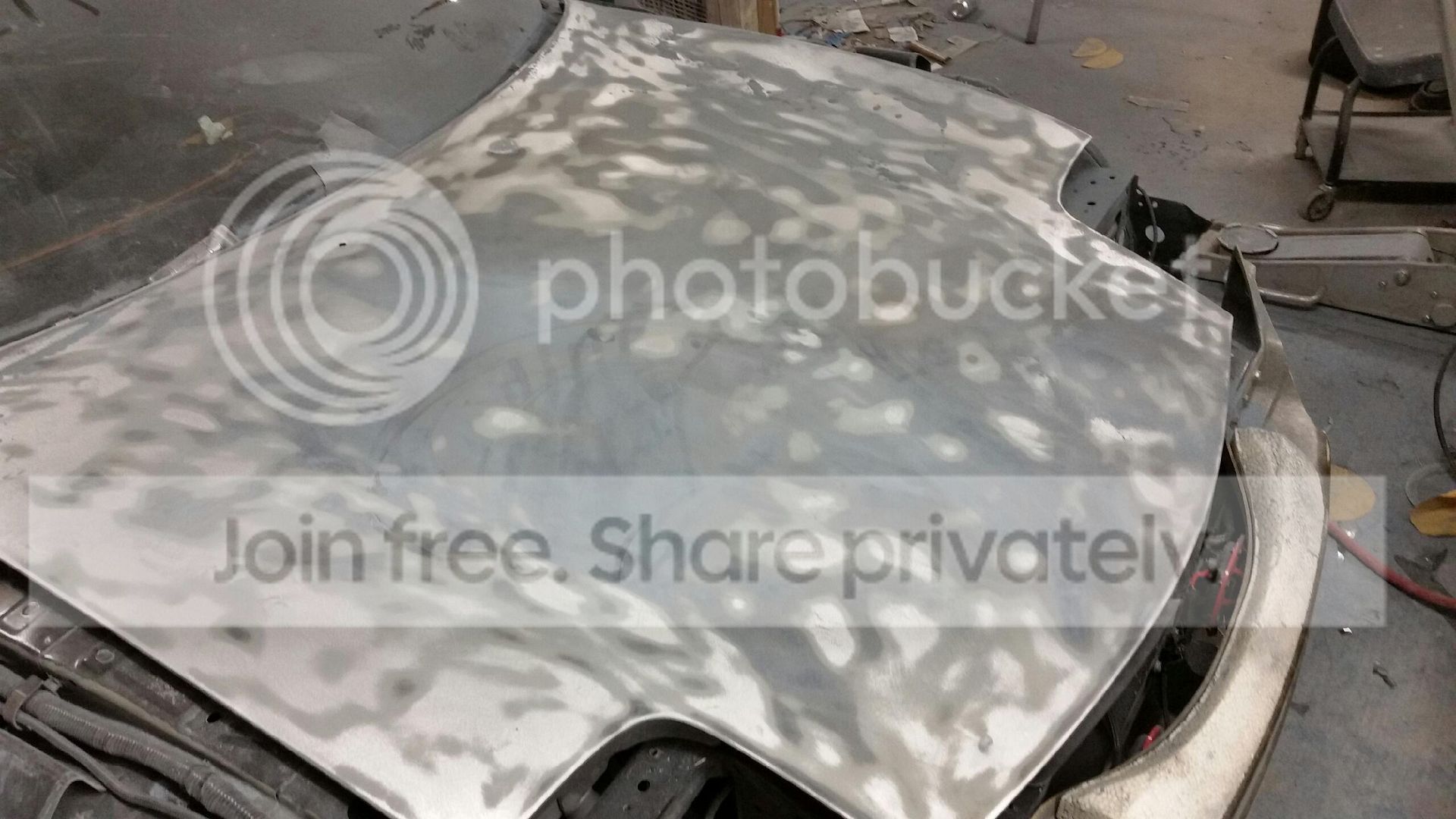

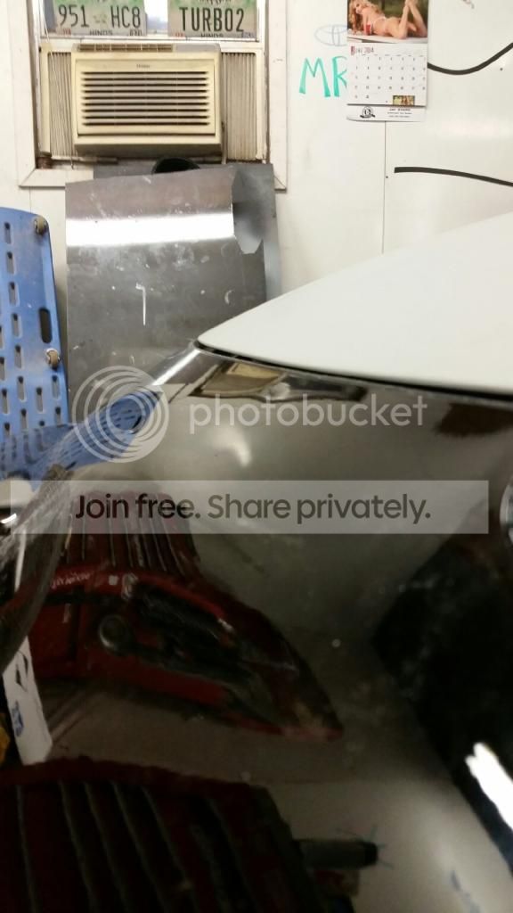

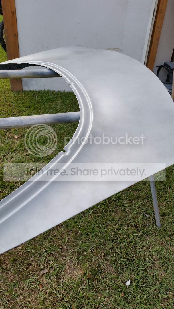

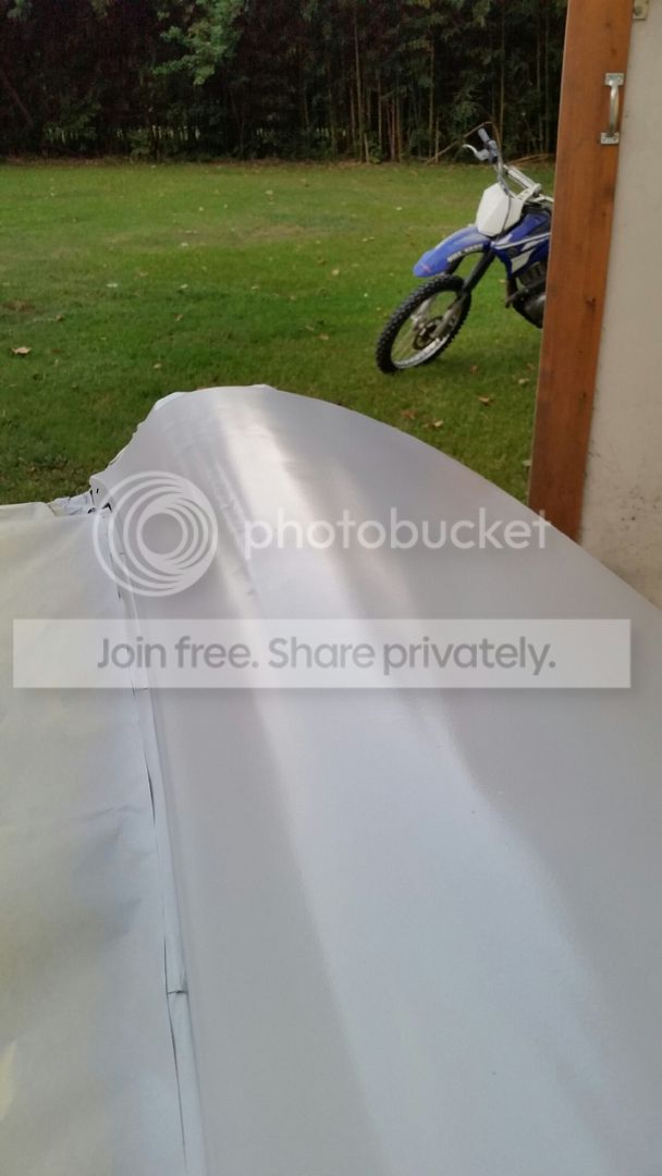

July 28, 2014, 07:31:37 AM

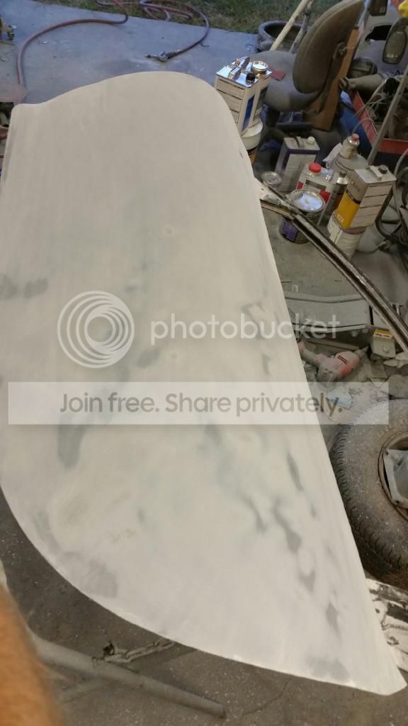

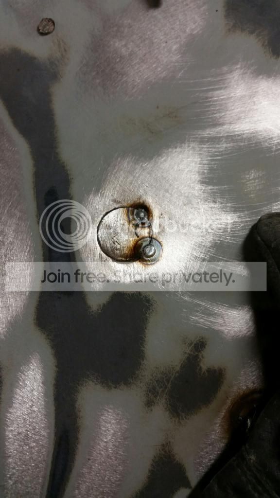

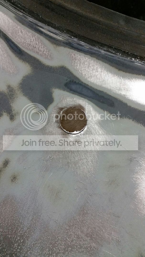

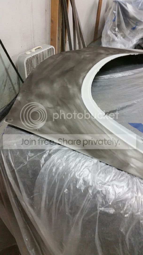

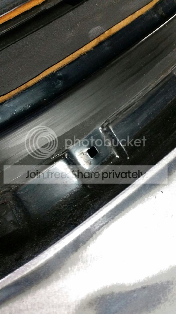

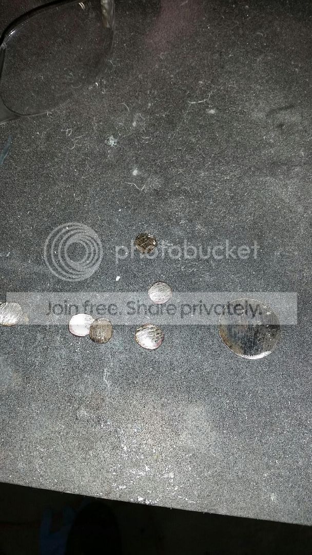

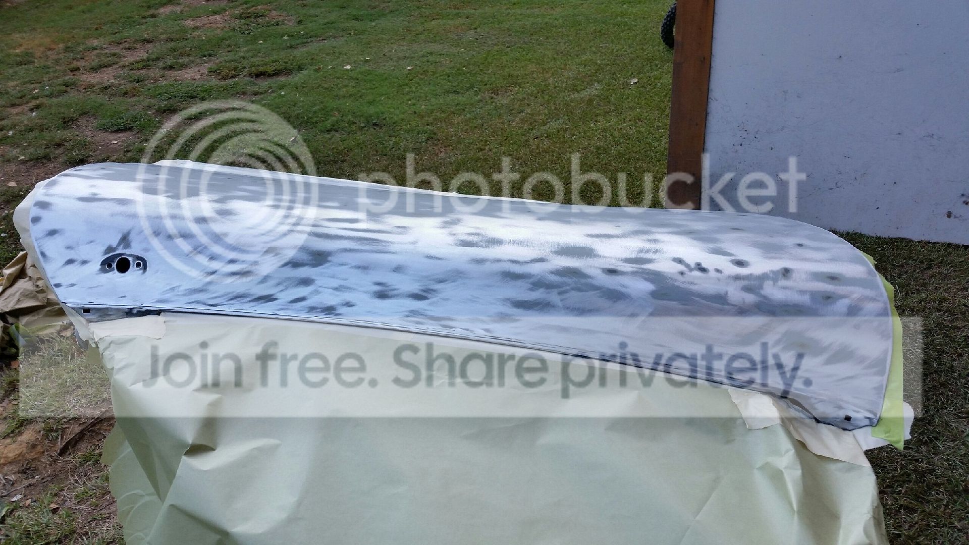

Got the hood's windshield squirters welded up on Friday. The welder did a great job as there was zero warping and he left us a good bit of metal to work with so we could grind it down to the surface of the hood.
Ground down
Whaaaaaat?

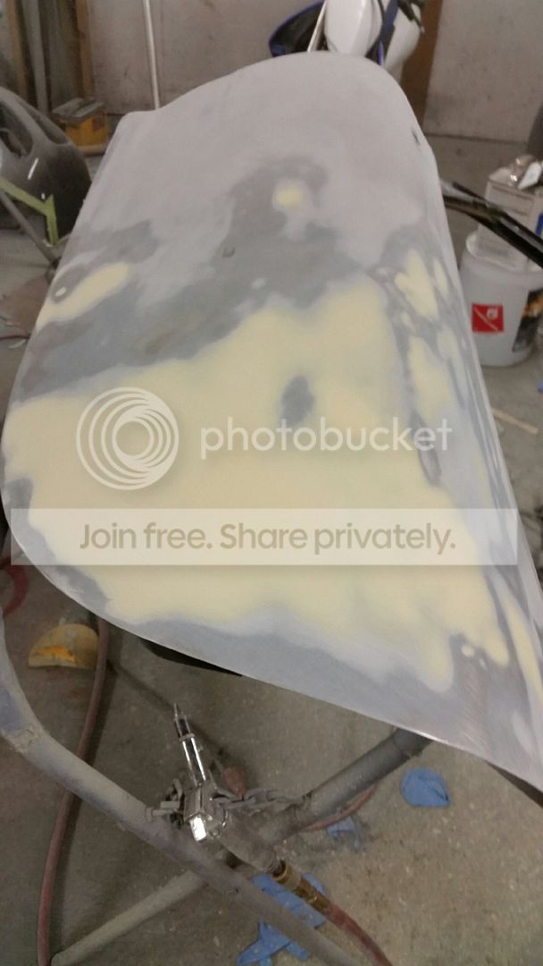

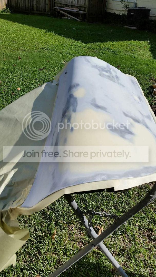

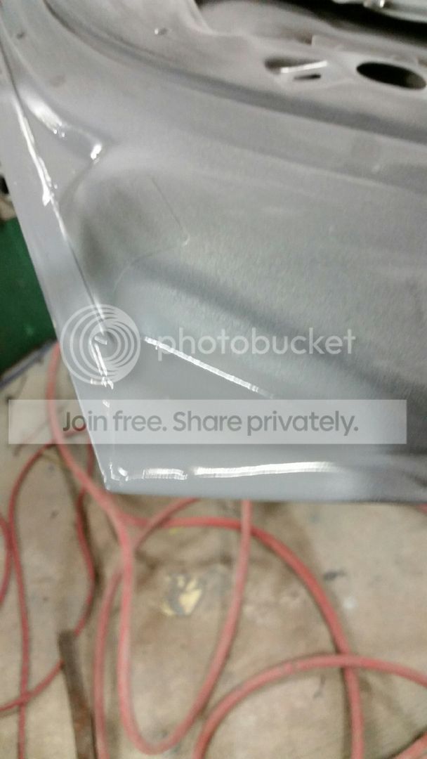

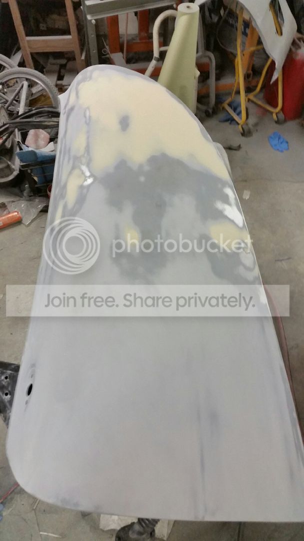

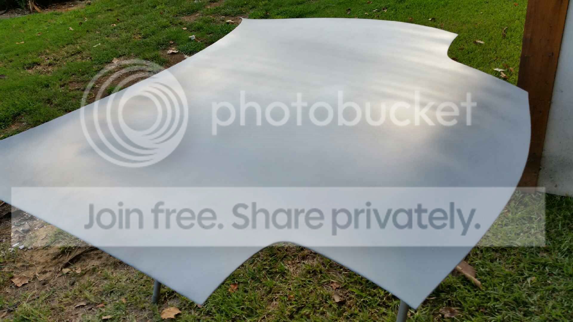

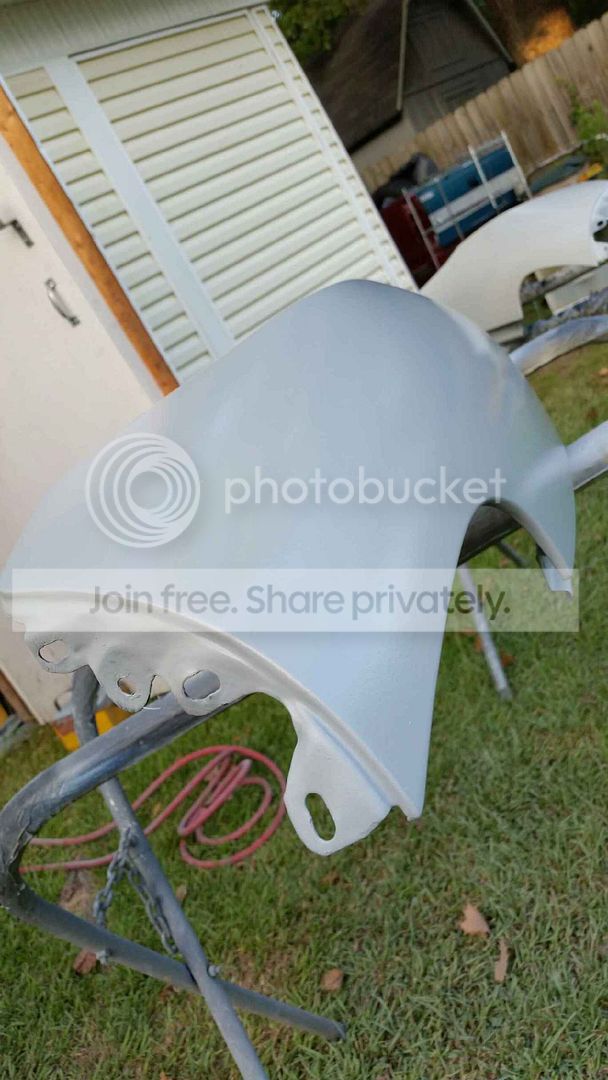

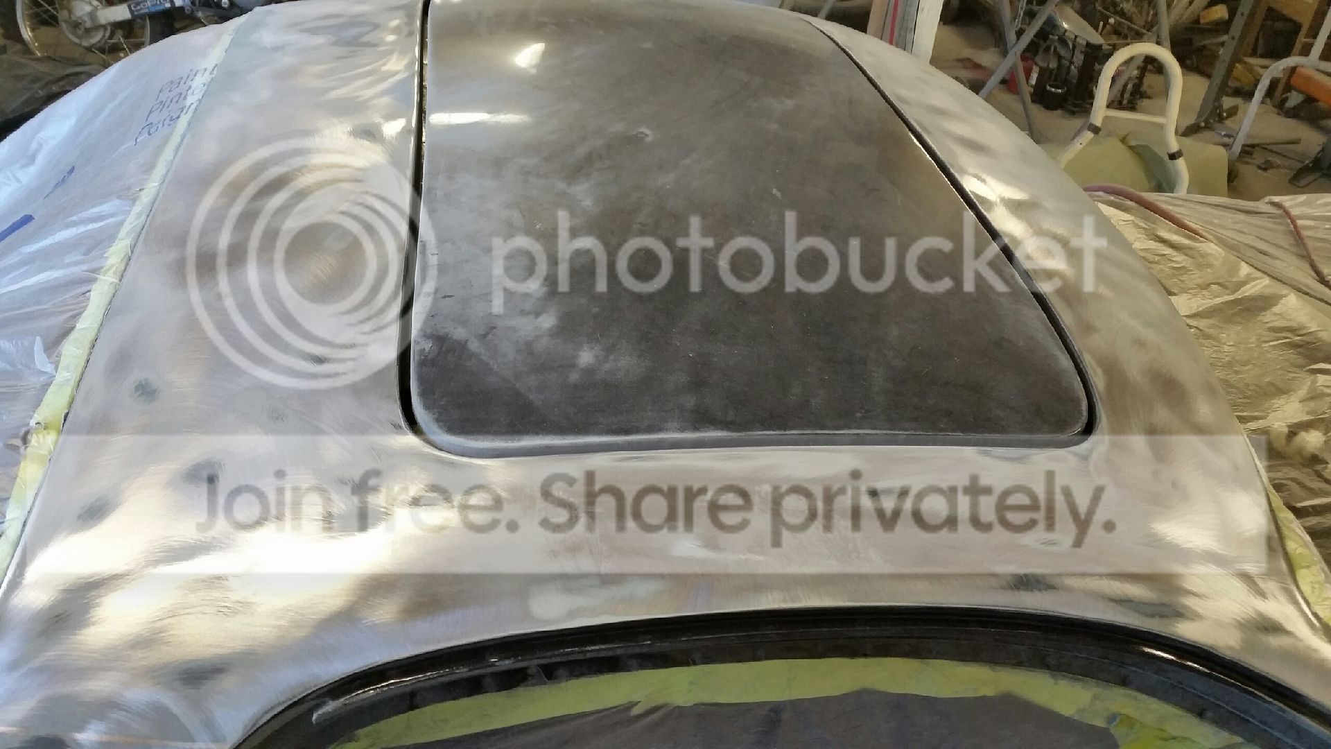

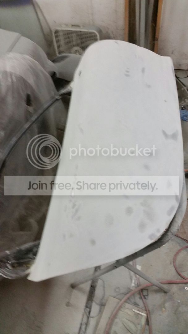

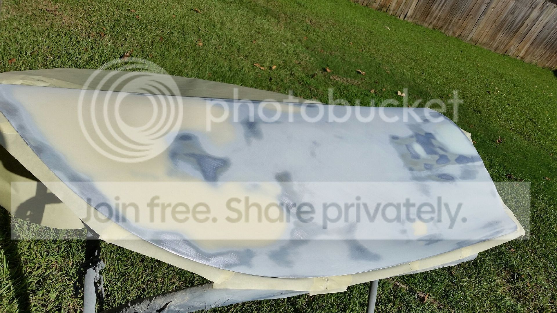

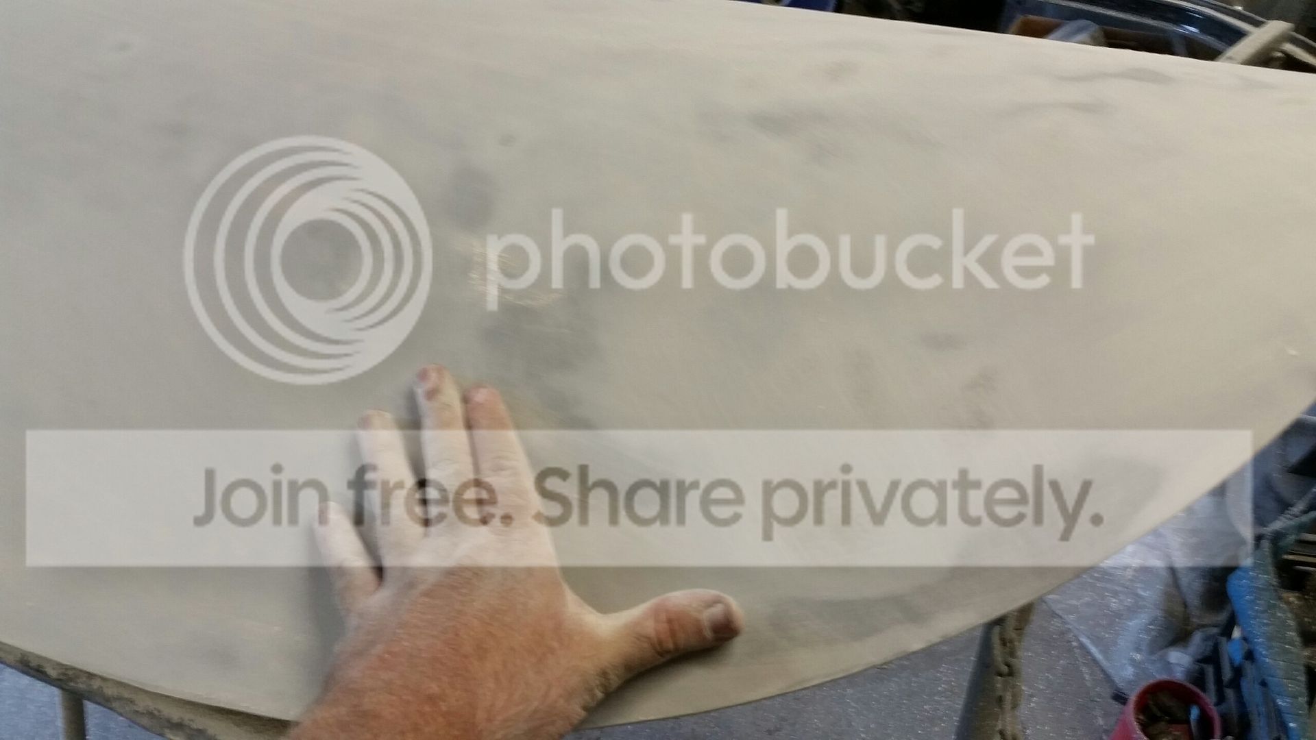

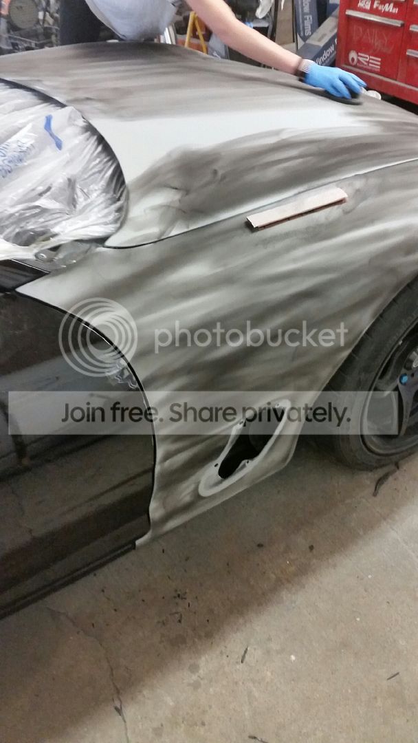

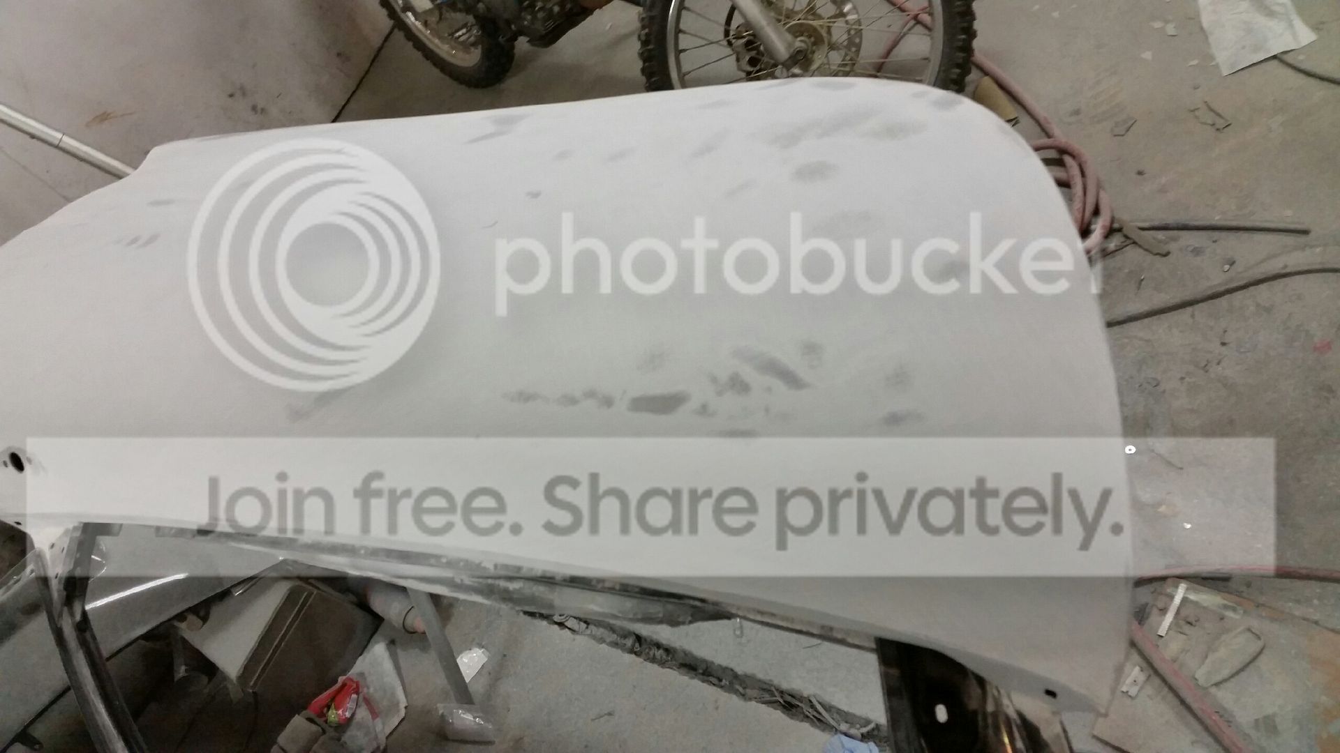

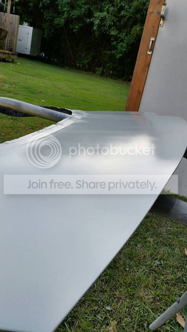

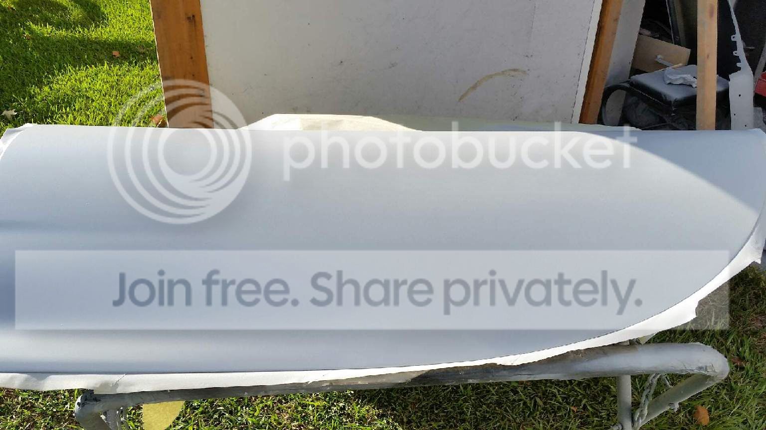

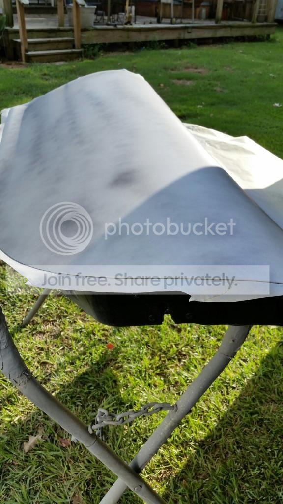

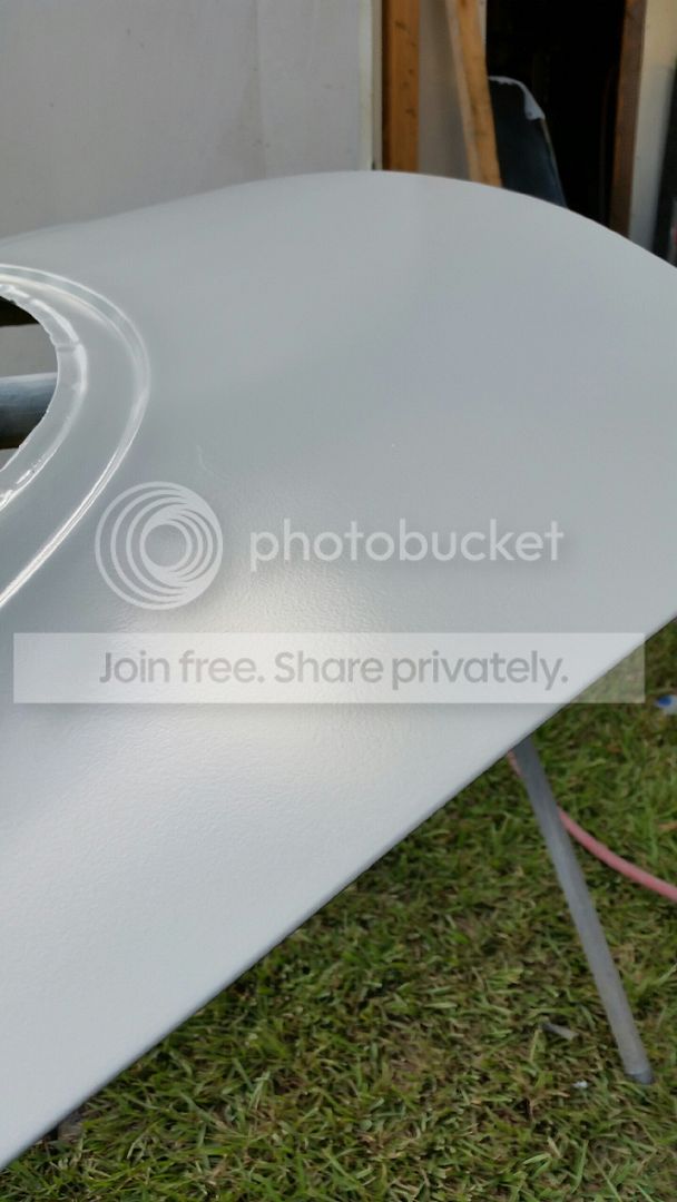

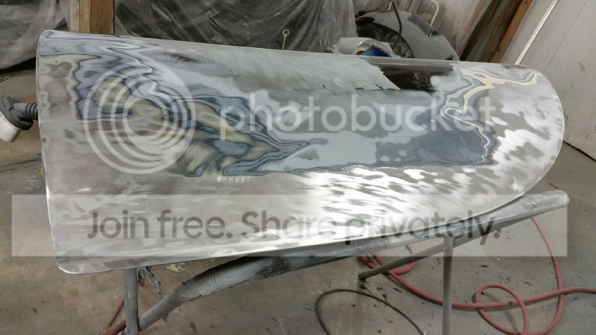

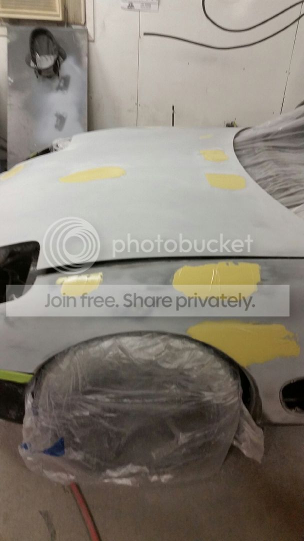

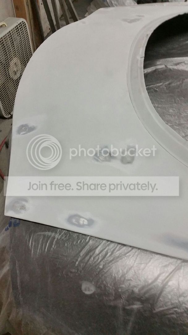

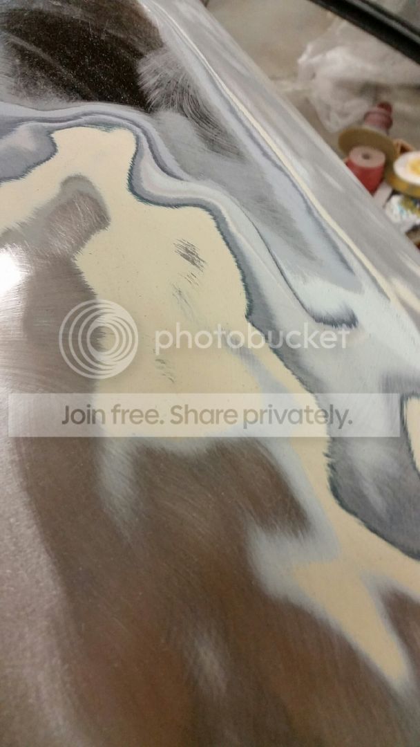

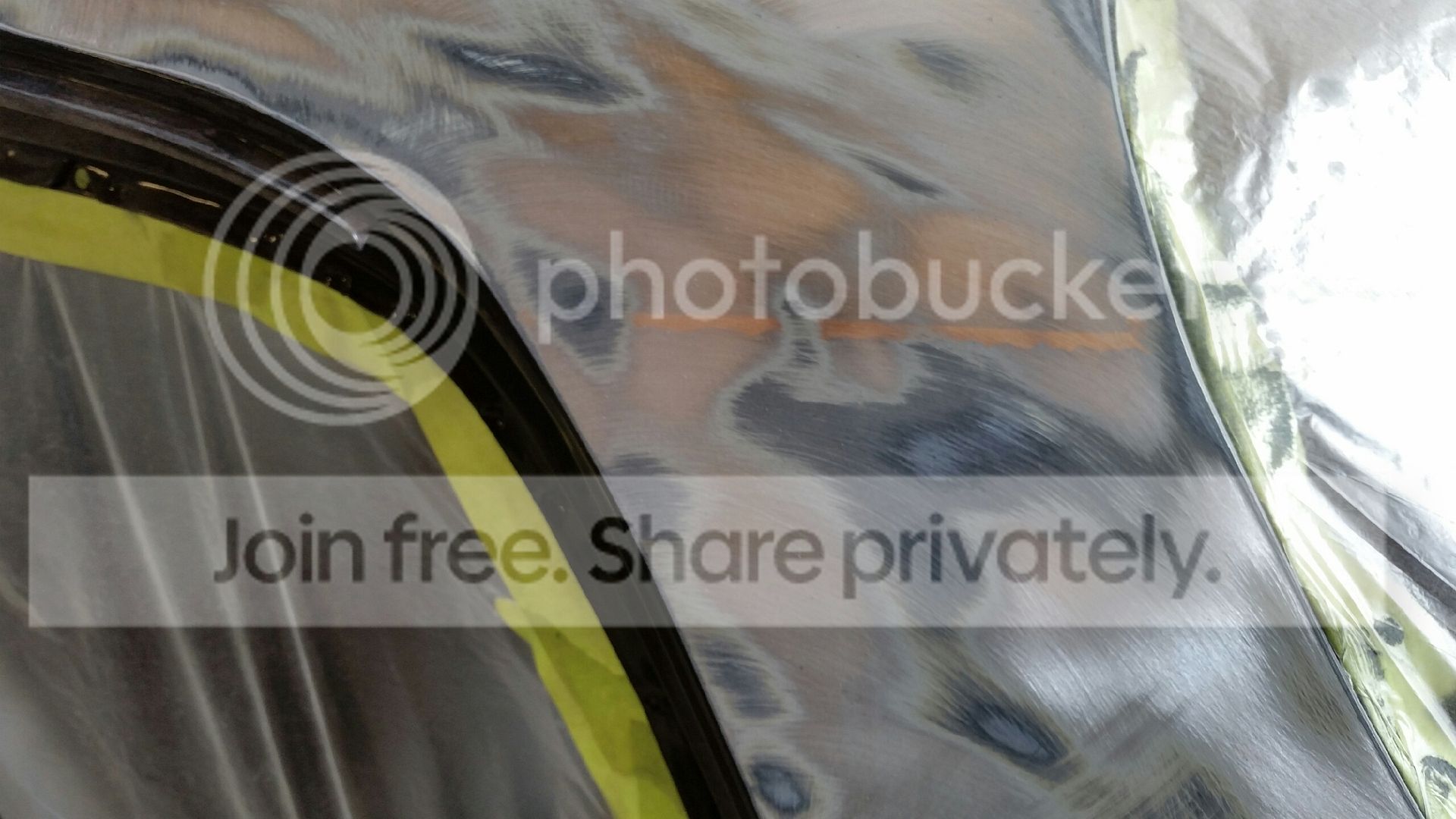

Epoxy primed first with a high build primer next.

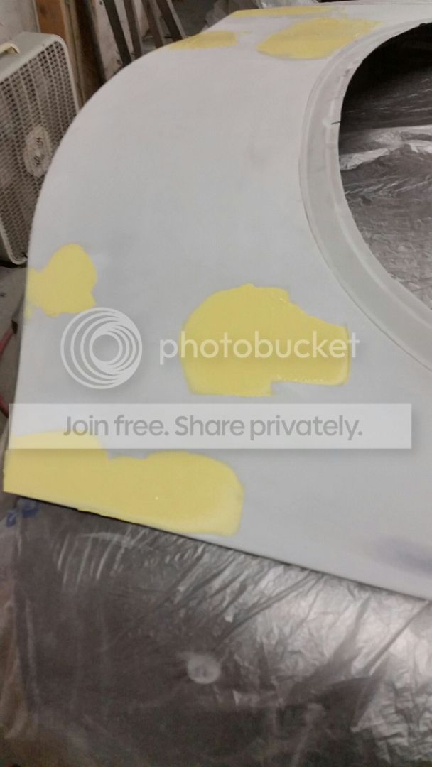

"The next step with these pieces is to fix any dings or waves with a thin lightweight filler then put 2 or 3 heavy coats of the high build primer. After that it's time to block sand and paint them."

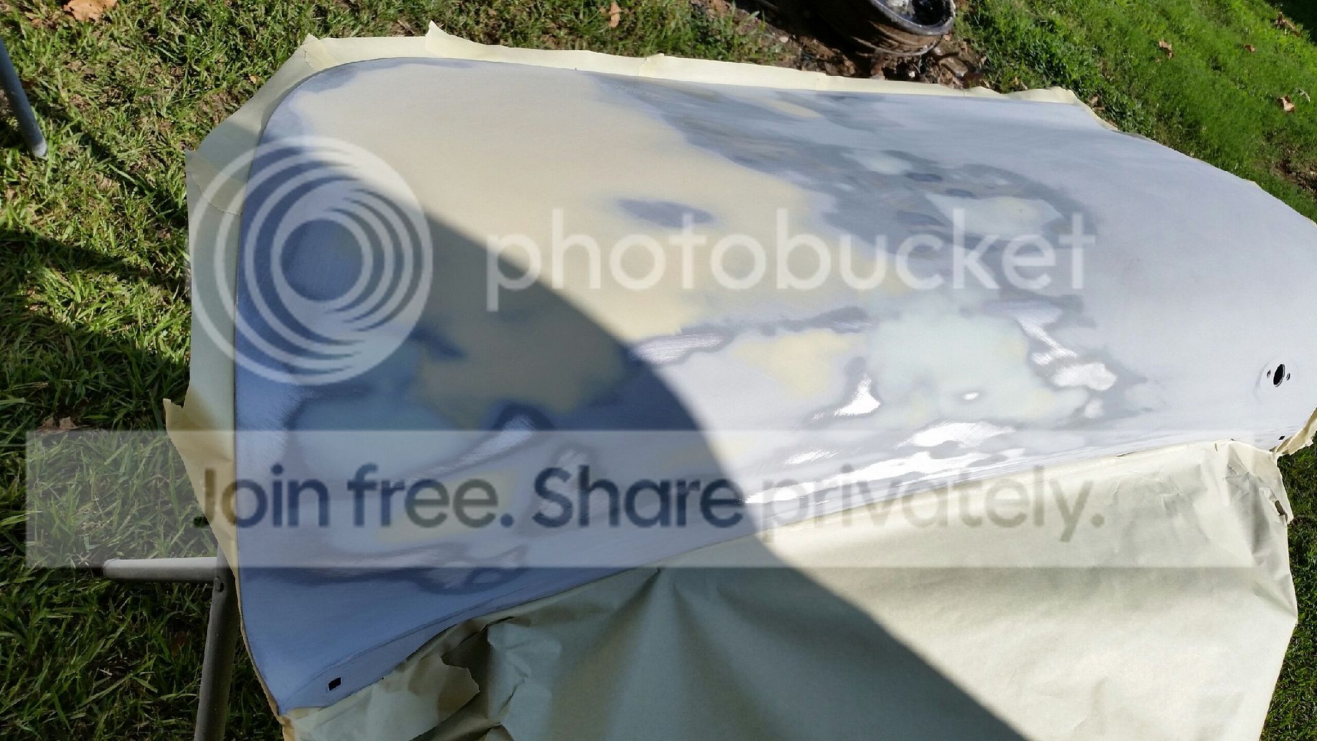

Ground down
Whaaaaaat?

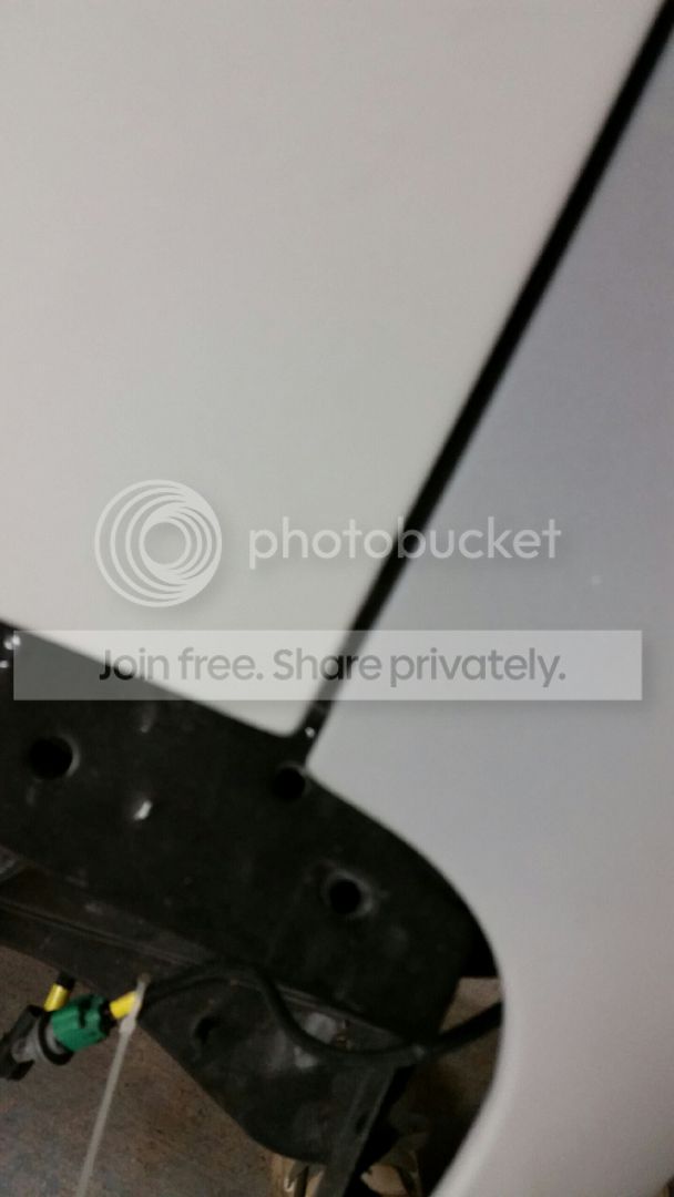

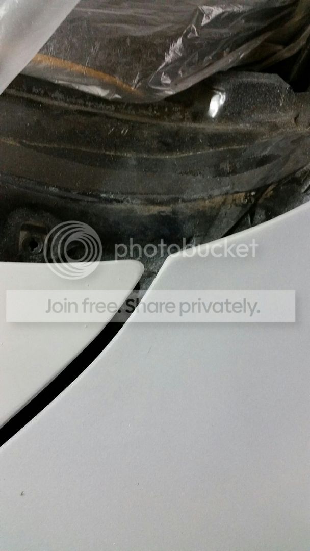

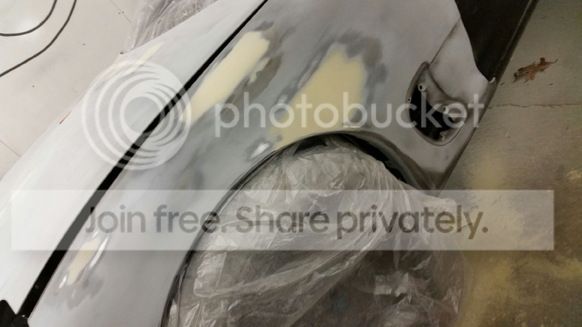

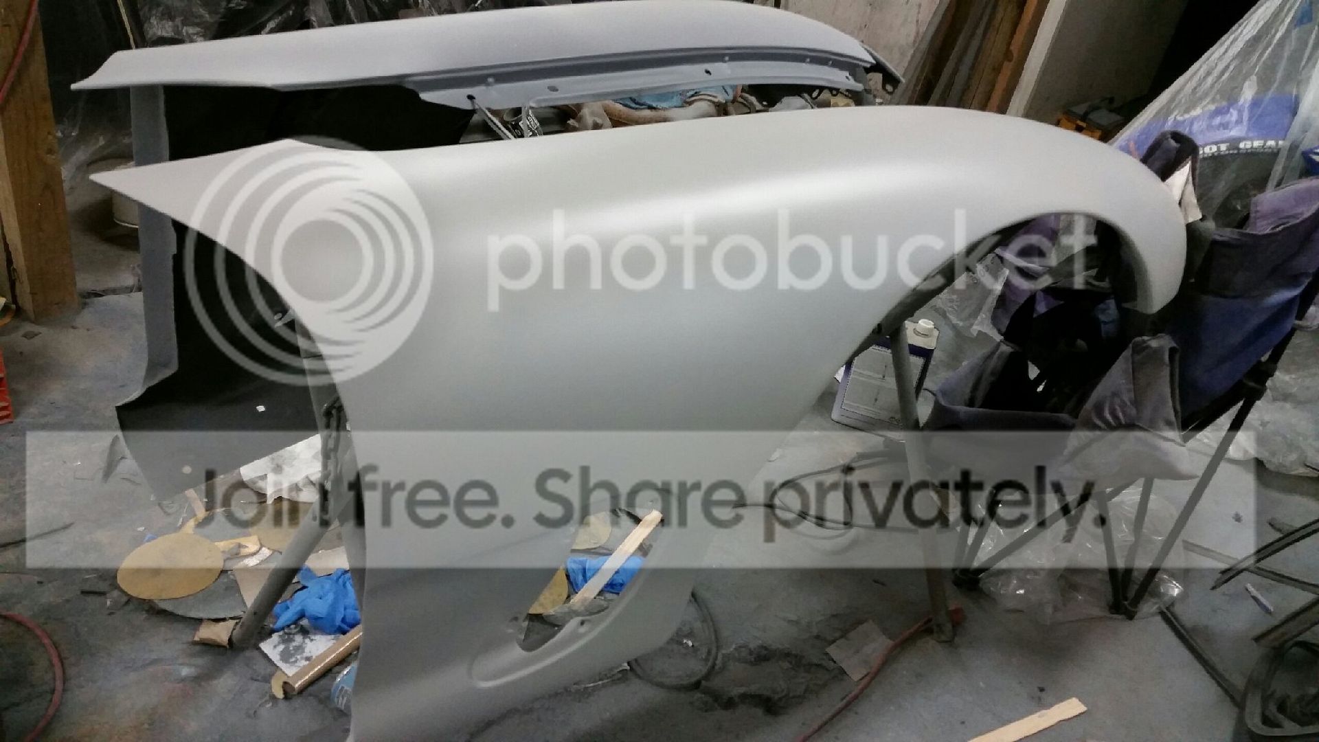

July 30, 2014, 08:11:22 AM

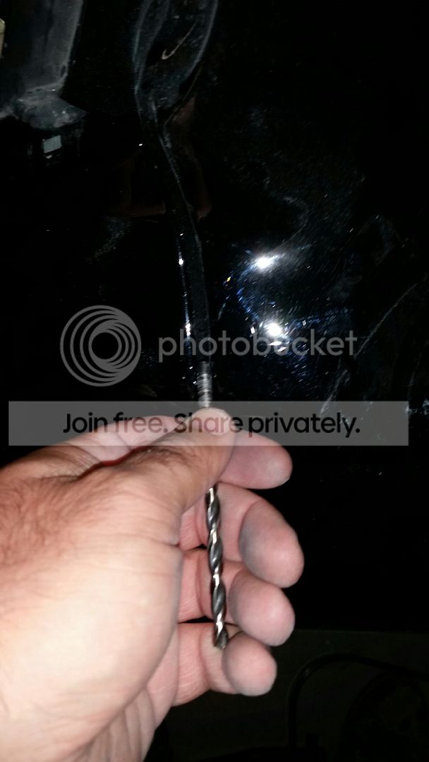

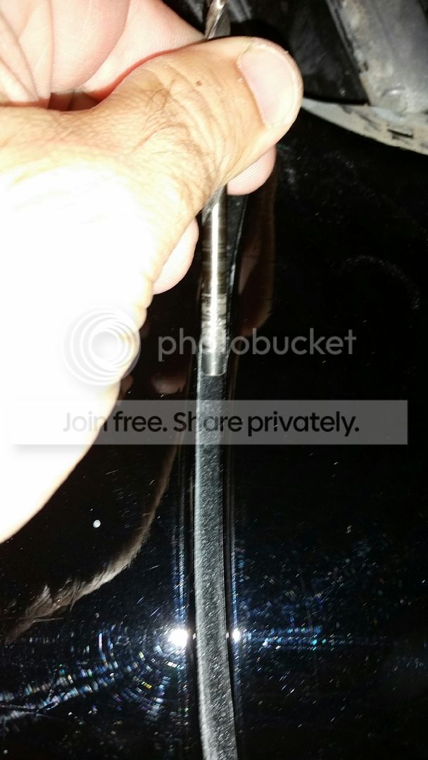

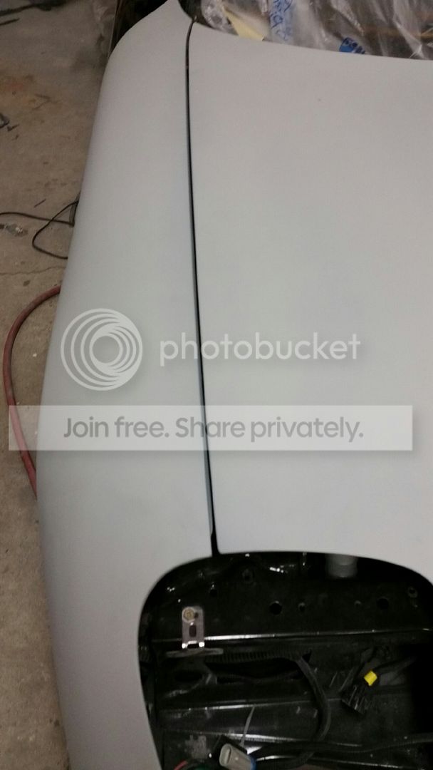

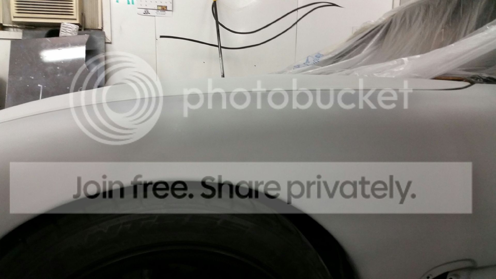

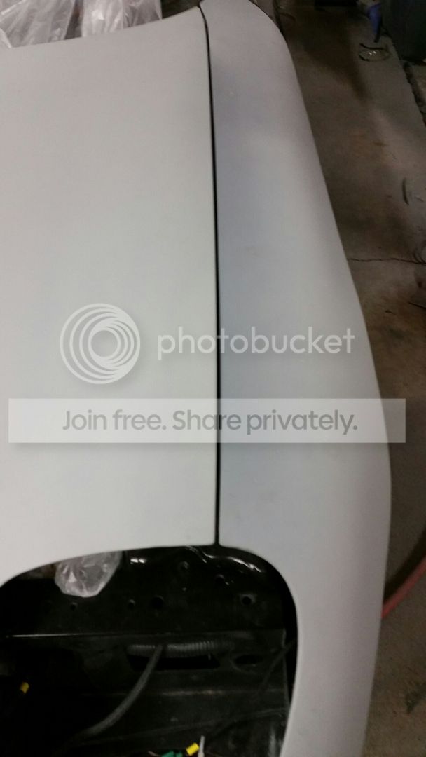

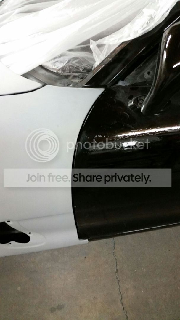

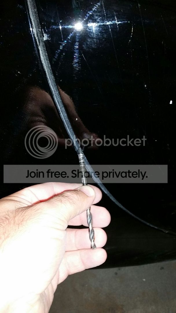

John mocked up the fenders and hood to pre-align everything before spending more time on finishing the panels. The idea being that its easier to make changes now vs after the panel is painted:

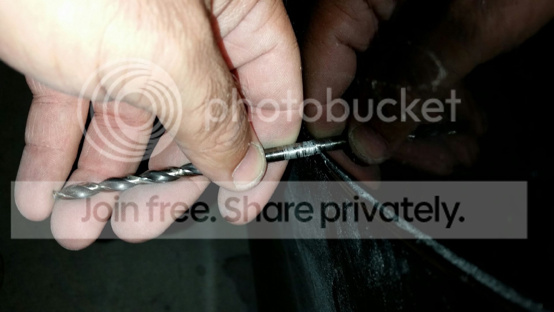

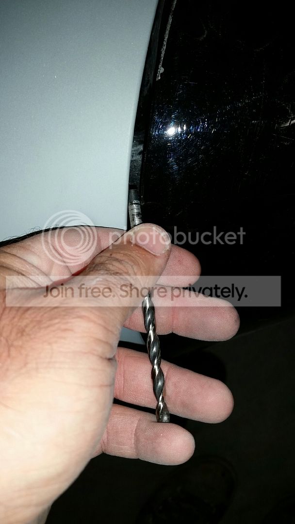

Using a drill bit to get the door gaps uniform around each door. John also adjusted the doors to their catches so that they close with a touch
Working with the hood to get it to sit down on the driver's side fender interface. This was something I'm pretty sure I did when my car kicked out the hood support while cranking and the hood landed on an allen wrench poking up out of the FPR.
Before
After
Working on getting the hood centered up:
Before
After
The panel alignment is now better than its ever been and I am seriously pumped up about it!!!
Before
After
Before
After

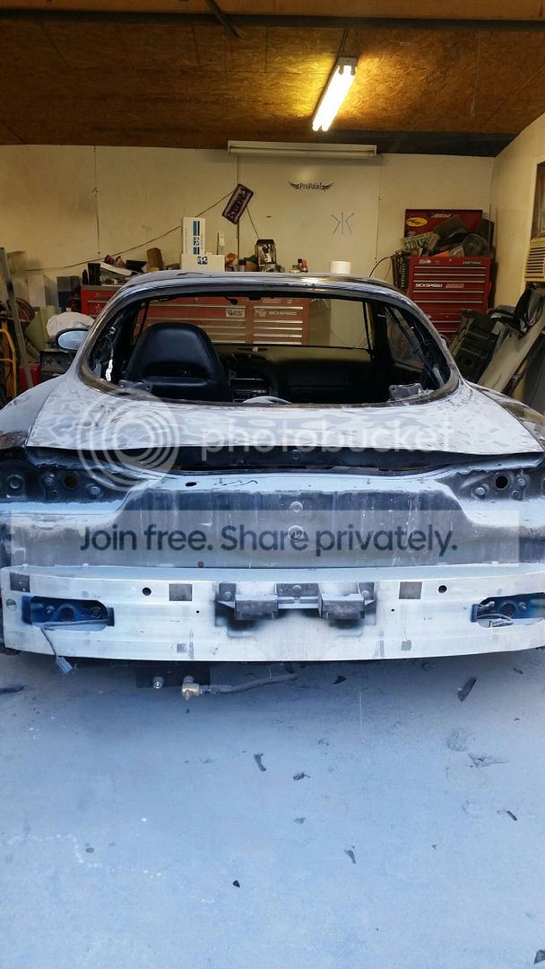

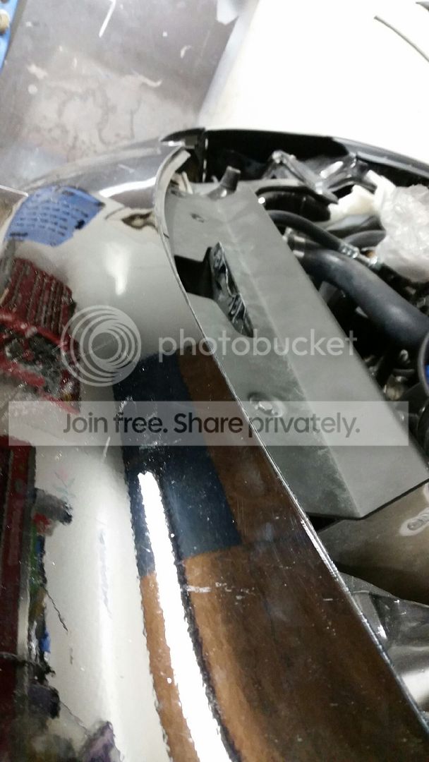

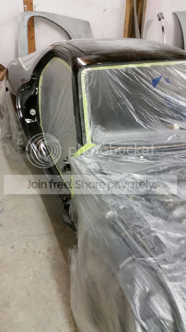

August 01, 2014, 08:45:25 AM
Lots of stuff has happened over the last couple of days.
After seeing the progress John was making I had to see it with my own eyes so I drove down to Jackson Wednesday night after work. Admittedly the trip wasn't just about seeing the work in person. I had a car full of parts to take with my including my front bumper. I didn't take the bumper with me the first time because I figured it was painted well enough and black is black is black is black right? Well, John let me know that blacks can vary a lot more than I first thought so we decided to paint it as well. In addition I was eager to see John work some his magic to see if he could solve the Samberg gap

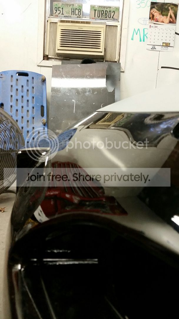

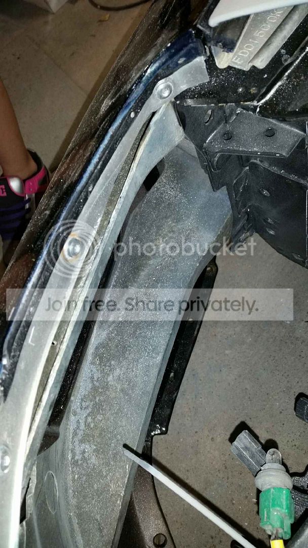

Here's the bumper on and after some adjustments by John. At this point I don't think he'd modified anything but the Samberg radiator cover was not installed:

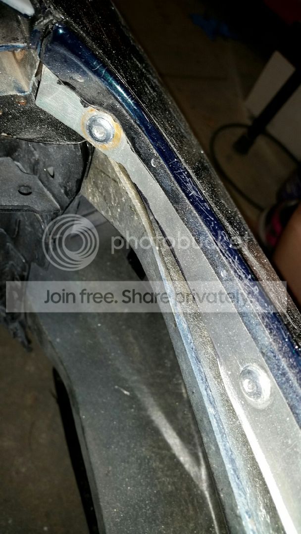

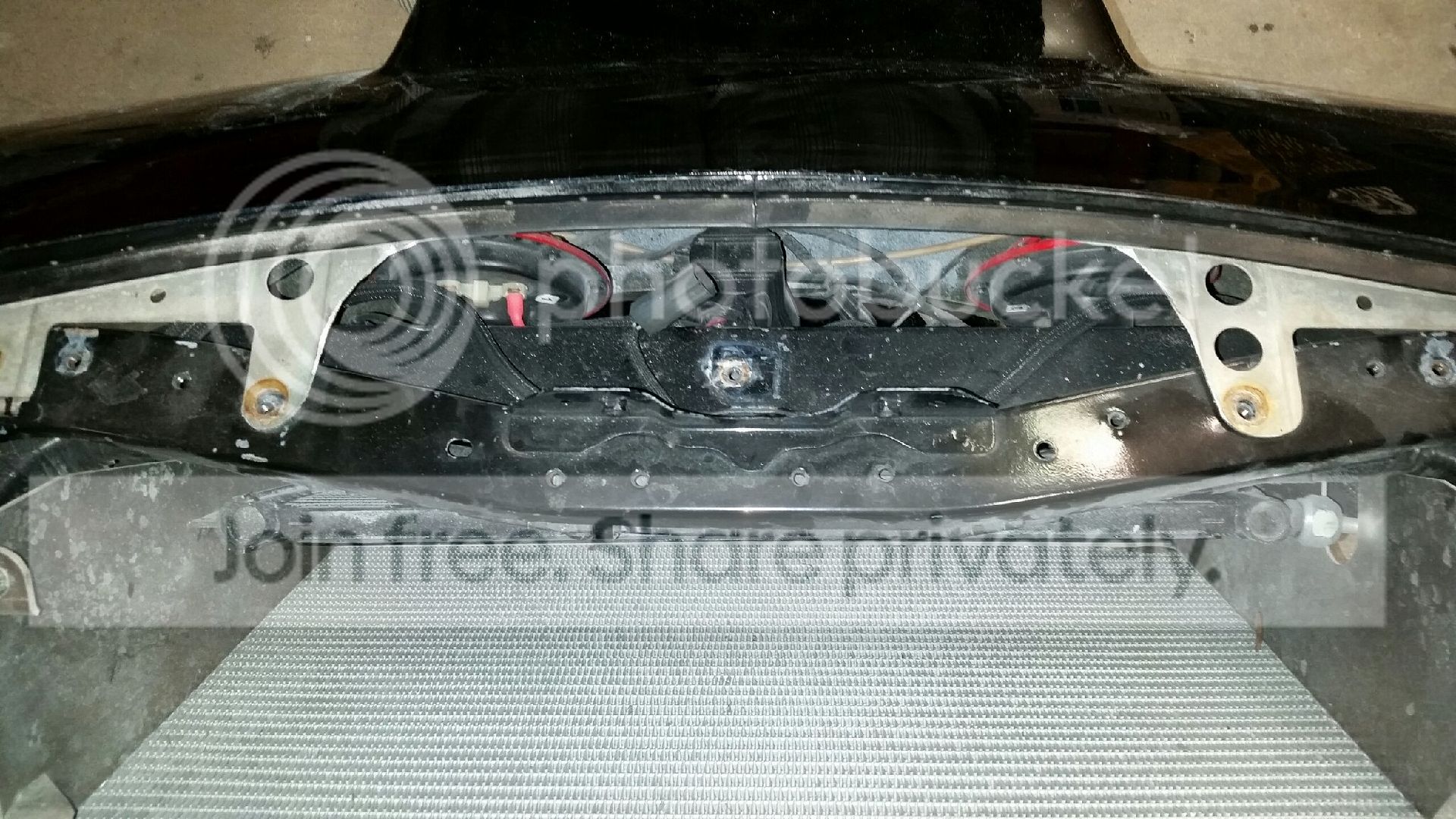

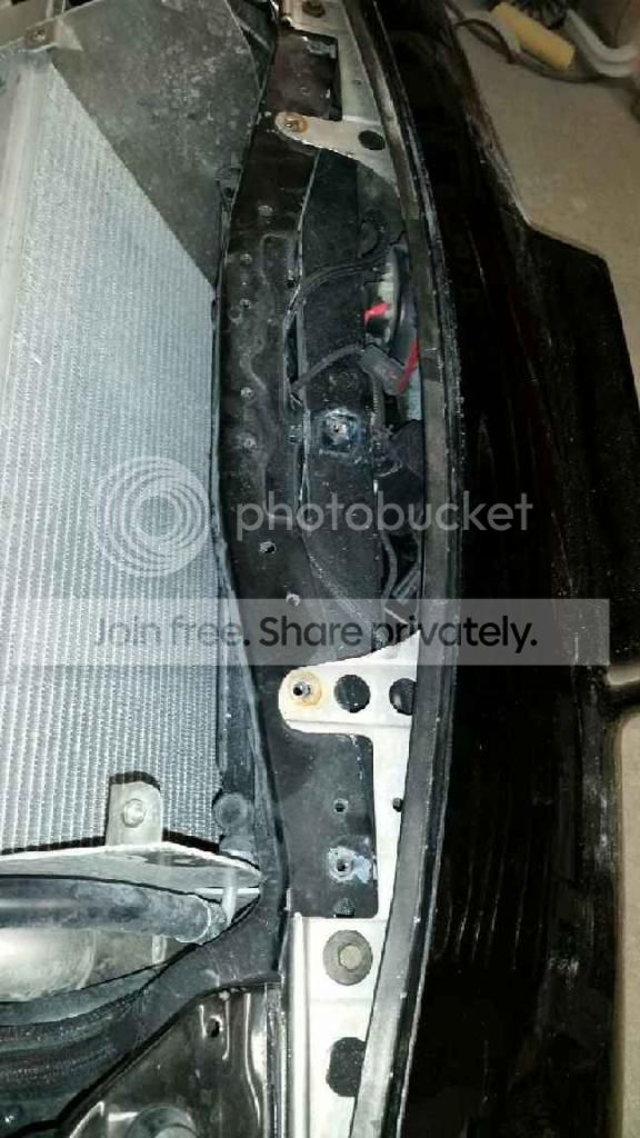

John discovered that I hadn't been using a bumper support under the plate area of the bumper (top of the main 'mouth' of the bumper) which bolts the bumper skin up to the crash bar:
Bolting it in helped raise the center of the bumper slightly.
This is where things get interesting. After quite a bit of conversation on the phone and checking for parts availability I gave John the go-ahead to modify any of the bumper support or the Samberg plate according to what he thought would serve us best. My thinking was that I could always trade in for a rev3 Samberg plate and the bumper support pieces are still available at Mazda so the risk was minimal.
John explained that the plate should not press on the bumper structure AT ALL! Any place the plate makes contact would get pushed down when the plate was tightened down which in turn pushes the middle of the bumper down and opens a gap between it and the hood. What this ended up translating to is that any metal support directly underneath the samberg plate that made contact with the plate had to go.
After some initial trimming. Checking the plate's fit without being bolted in
After seeing positive results, John finalized the trimming. This is what he was left with and is the money shot a think at least a few of y'all will be interested in
Before I show you the final results, one last thing came up that was an extra bonus fix. I had noticed over the last year that my bumper tended to rise ever so slightly right by the headlight buckets. This caused the Samberg gap problem to look even worse because on top of the center gap, the edges of my hood appeared to dip down at the corners right by the headlights. I figured this was just the way the bumpers on RX7s were designed and that my hood was off.
Turns out that my 93 bumper support bar was to blame. Back when I got my 99 bumper I decided to mod my 93 bumper support bar to clear the new 99 lights.
That's all I'd ever heard about as far as mods needed to make the 99 bumper fit correctly. Well, that didn't turn out to be the case. John found that the bumper support also had to be cut on the top ridge where the cover supports meet the support bar (right by the headlight buckets). The unmodified section of bumper support actually pushed the bumper cover up at the edges causing the bumper to rise as it got close to the headlights.
Trimming the bumper support allowed the cover to lay down flat and the results, along with the fixes above are astounding!
Happy guy here

Quick update. John worked on the hatch last Friday:
Welding up holes. This is the rear wiper hole
No more holes!
Grinding out the surface rust that accumulated after the last improper window installation. The rust was located along the rear hatch window seat
Before
After
Before
After
Should be getting pretty close to sealing up the hatch. I haven't heard John's plans for it.

August 05, 2014, 07:31:43 AM
As expected John got the hatch all sealed and primed yesterday:
He also spent some time looking for low spots. Here it's seen with its guide coat on:
Check out the homemade sanding block! I remember reading from John's mr2 thread that he uses paint stirring sticks padded with velcro (just the looped side to make a soft surface) then wraps it with sandpaper. It's a technique I've only seen a few times and it's always been associated with guys at the top of the paint biz.
And here are some of the resulting dings showing their ugly heads after blocking the guide coat:
This was somewhat expected on this side especially. The fender was actually dropped by my Dad the day we trucked the rx7 down to Jackson
I saw it happen through my garage window. Something between the truck and the trailer snagged his pants and he went down harder than any flimsy fender deserves haha. It ended up scraping the paint down to the metal in some spots and I expect it was slightly deformed, but John got it looking amazing despite the drop and previous shoddy work.
August 06, 2014, 07:56:39 AM
Hatch update from last night:
Blocking the guide coat:
Roughing the welded metal for filler:
Skimming with filler:
Ready for final prime then paint:

August 07, 2014, 07:48:48 AM
John was aiming to get the body work finished on the front cap of the car and only missed his target by a hair due to a quick family emergency:
John gave me a hard time for the 'belt buckle dents' in the top of the fenders
I'm completely guilty in the regard. I've been working on the car without
'protection' after the failed paint job because I didn't care about scratching the paint. Guess I should have worried about denting the metal
A shot after blocking:
The larger patches of filler down by the wheel well was caused by rolling the fenders. I knew the FD front fenders were flimsy but apparently it's trivial to pull out the sheet metal of the fender behind the lip and over the side-vent. Mine was pulled and flattened out a little bit of the curvature. When I was down last week John had to feel the pull. I have to admit I barely felt anything if I felt anything at all, but John did so he new it needed to be skimmed and blocked or it may be more obvious under black paint.
I'm completely guilty in the regard. I've been working on the car without 'protection' after the failed paint job because I didn't care about scratching the paint. Guess I should have worried about denting the metal
August 18, 2014, 07:48:28 AM
One of the first things he did earlier in the week was a big solid for me. I bought the car with the defrost vents removed and half broken. 2 summers ago I tried installing the old left side that was still in good shape along with a brand new right side and a new center piece. I don't know if it was just me, but it turned out to be an impossible feat to accomplish with the window installed. Those things take a serious push to clip in and the window restricted and real leverage. All I ended up accomplishing was breaking up the nozzle clips and ruining them. So... fast forward to last week. I sent John a care package of new Mazda parts and he went ahead and installed my defroster vents while the front windshield is out.
It may not look like a super exciting picture, but it is DEEPLY satisfying to me as the old attempted install really pissed me off. John also got a chance to put the final coat of high build primer on the front hood and fenders:
Afterwards he misted he panels with a light black guide coat to help with final blocking.
Excited to see the final outcome for the panels above
August 20, 2014, 07:22:33 AM
John got serious over the last two days
Backside of the hatch primed after smoothing the welds and sanding:
Hatch Primed:
Guide coat applied:
This was funny. John pulled my mirrors to prep them and the doors for paint and found out they've never been removed for any of the paint jobs this car has received:

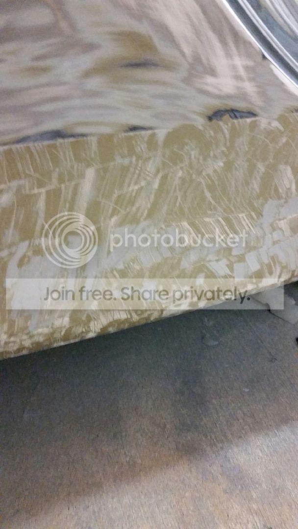

Stripping the doors and finding filler. Hoping it's just dings that were filled. Also, check out the close up on the old defective paint!:
Stripping the driver's door continued:

He found out that the door had a pretty respectable ding in it that had been filled with bondo along with some surface rust that got into the metal before they slapped on the bondo.
Surface rust:
Bondo:
Finished stripping:
John's planning on fixing the dent/ding with some metal tweaking and a thin skim of filler. Looking forward to seeing the results!

As usual, John continues to bust *** and worked on my door through the weekend.
Epoxy primer has been laid and it's ready to be leveled.

Skimmed and blocked driver's door:
Blocked the passenger door to shot the low/high spots. It had a flat spot similar to the driver's side door that was near the back of the door. The door had plenty of dings. The spots that are close together near the top of the door is where John massaged the metal to push out the flat spot. Nothing major to report.
Second skim and block of the driver's side door:
At this point John's very close to final priming the driver's side door. He said he's got a couple things to touch up then he'll shoot the final primer. The passenger door needs a little more work but I expect John will wrap up the doors next week
September 05, 2014, 08:08:58 AM
As expected John wrapped up the doors save the final blocking
Smoothed out and masked for primer
Primed and smooth as butta :yay:
Guide coat sprayed on for final blocking:
Great work by John!

September 10, 2014, 09:09:44 AM
Sorry for the lack of updates. I got hit with some food poisoning or a stomach virus on Sunday night and I'm just getting back on my feet. Luckily John has been going full force though
Taped up to protect the interior from paint dust:
Stripping. Showing off the factory roof to quarter seam:
Showing off some surface rust around the a-pillar caused by the previous improper window installation:
Big stripping commences
September 16, 2014, 01:12:47 PM
John continues to kick butt and is making serious progress :cheers:
Busting up some door jambs:
The jambs were of particular concern for me as they already suffered from paint adhesion problems. I suspected the previous painters hadn't sanded or prepped the jambs other than wiping them clean and John confirmed that in several spots this was the case. As I would have imagined, the process of properly prepping the jambs was very labor intensive and John had to do it all by hand. To say I'm happy with the results is a serious understatement!
More rust hunting and annihilation
The pic above is another shot of the window A pillar support after John finished chasing off the surface rust. I asked him if this was a common occurrence as I had been warned about it when I had a window replaced in my old mr2 (warned only, nobody stepped up and offered to do the right job and fix it). He told me that this is pretty common with DIY window repair as cutting out and removing the windshield can damage the paint and therefore leave bare metal exposed.
Professional window guys repair this type of damage if it occurs with etching primer, which seals everything back up. Do yourself a favor and be involved with any glass work you hire out because you don't want glass going in over exposed metal.
John was able to get the rock shield coating off from under the doors with a heat gun and a razor blade:
This is another little surprise that's happening with my car. John suggested stripping the rock shield off of the bottom edge of the car and painting it to match the car. I agreed and this is how we got to this stage. You do loose a little bit of protection with this choice, but I figure if I really get paranoid I'll just wrap those sections with clear bra and call it a day.
Finally, the sunroof is out and awaiting prep:
