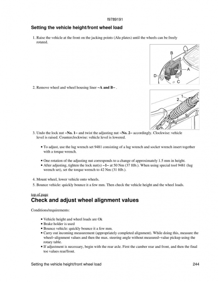

there is a kit from porsche to raise the ride height of the cgt. Basically longer pushrods for the dampers and changing the spring preload.

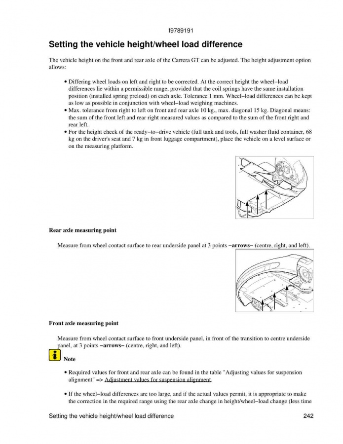

ride height is adjustable

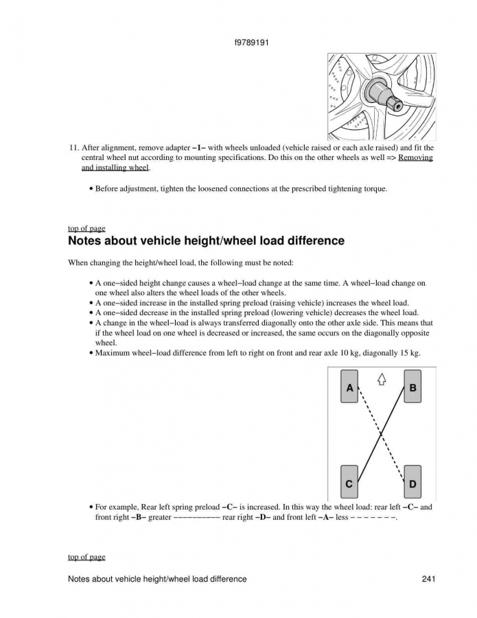

im guessing its because like the gt3 etc, the ride height adjustability is there to allow exact corner balancing and not intended to be used to noticeably change the cars overall height in any direction. theres upper and lower limits specified for each corner which allow balancing to take place and keep the car within height specs.
in order to change the height then adjustment of the suspension components would generally be a requirement hence the kit on offer

To answer the original questions, yes people have adjusted the height of their CGT to go lower.
From the factory, the CGT does not come with hydraulic lift suspension like Lamborghini late model cars. However, the CGT does have adjustable coilover suspension which would allow raising or lowering the height of the car if necessary.
KW offers a hydraulic lift suspension solution for the CGT(aftermarket).

It's not weird at all. You are hung up on "how the car looks about 3/4 lower", that's why it makes no sense.
If you jack the suspension up or slam it all the way to the ground without the proper parts and ignore the factory recommendations, the handling of the car will be severely compromised since you're placing the damper outside its proper operating range and pushing the control-arm beyond its effective geometry.
