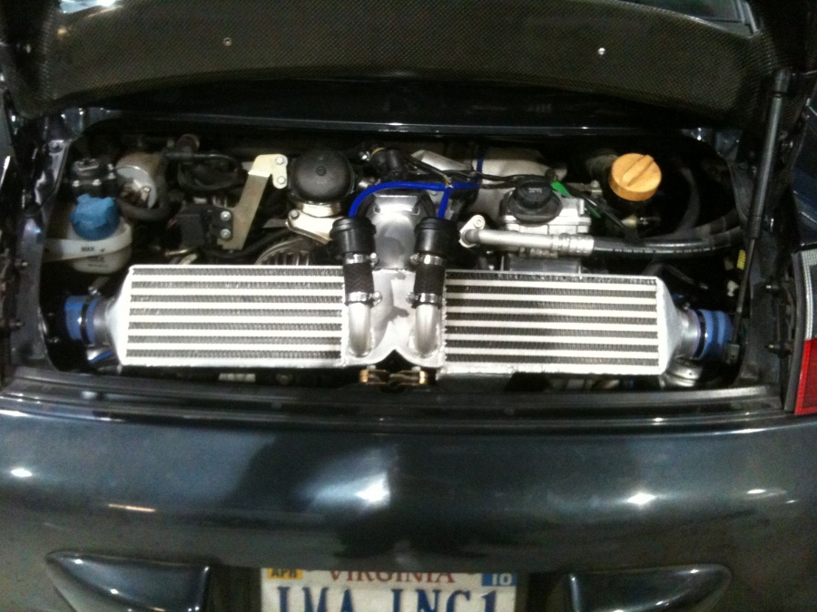

Would anyone like to make 450 to 470 hp at the tires with your 996 GT3? If the answer is yes,then you need to ck us out. We have developed a twin turbo kit. Running 5 psi the car is putting down 450 hp.
More pictures and info soon. We also have a kit for 996 and 997 available.

Wont those intercoolers heatsoak in that location.

3deep
The intercoolers will heatsoak in traffic as well as other cars for sure. The pictures do not show the carbon duct we made for the air to air intercooler. This being my car and having the Cup deck lid with a Crawford wing I opted for the air to air. In the production runs we will use water to air intercoolers as they will work great. Thanks for the observation. BTW once the car gets moving the inlet temps go right down, also the efficiency of the compreesor and the low manifold pressure help to make lss heat than expected. All good things when considered.
No different than the Subie.. As soon as you get any speed the temps drop right down..

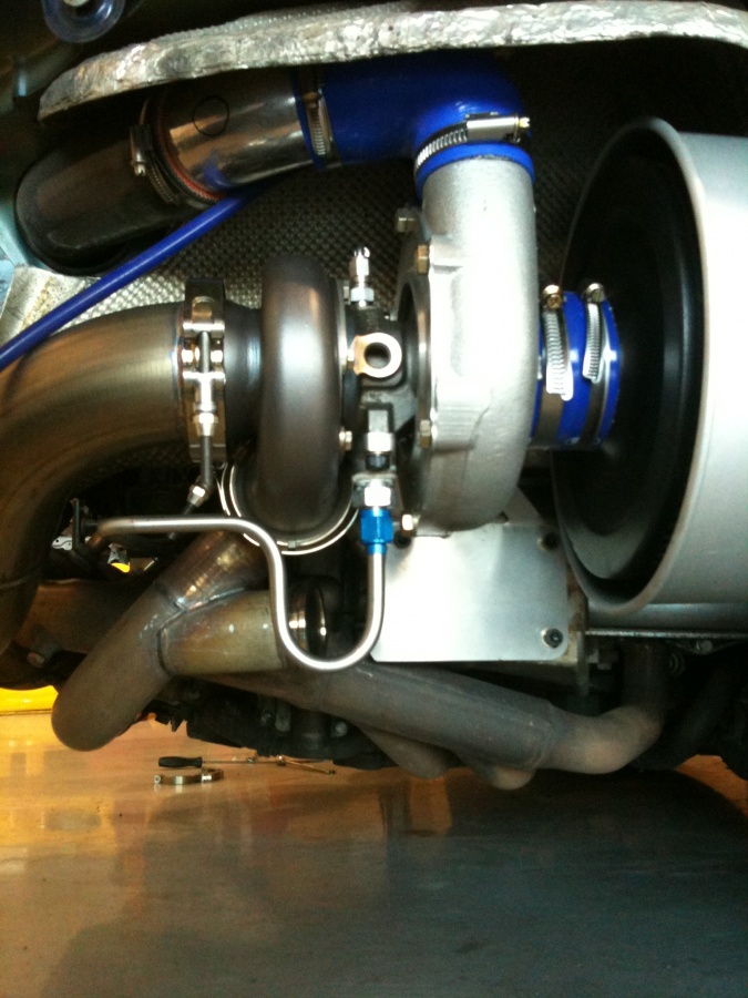

I think its an innovative setup as i see it.. I think as you continue on there is much to improve upon the kit.. Some advice maybe to use the New Billet Air cooled lineup to simplify system without water to the turbos.. Also the coupler off the Turbo outlet to be casted as those 90 degree bends over time split there.. maybe not at 5psi but still a good idea for precaution and wont add much cost.. I Like the vband housings for simplicity of maintenance..
I was considering building a 1 off setup myself if I got bored.. Glad you took the plunge.. I dont see any issues with 12:1 compression.. I have run 49psi of boost at 12:1 with no issues.. The tune must be in check and fueling.. While the GT3 Motor is stout, on Boost be careful with the Ti Rods as they are normally HP Specific in design, and weight..
What are you using for engine MGMT?? Thanks!!
