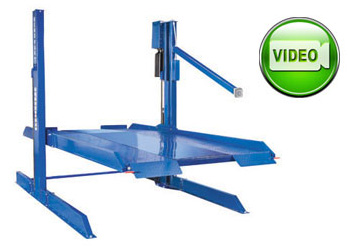

I have a rotary 4 post lift, my cousin did something like this one....
http://www.bestbuyautoequipment.com/...ndpakpl-7x.htm
