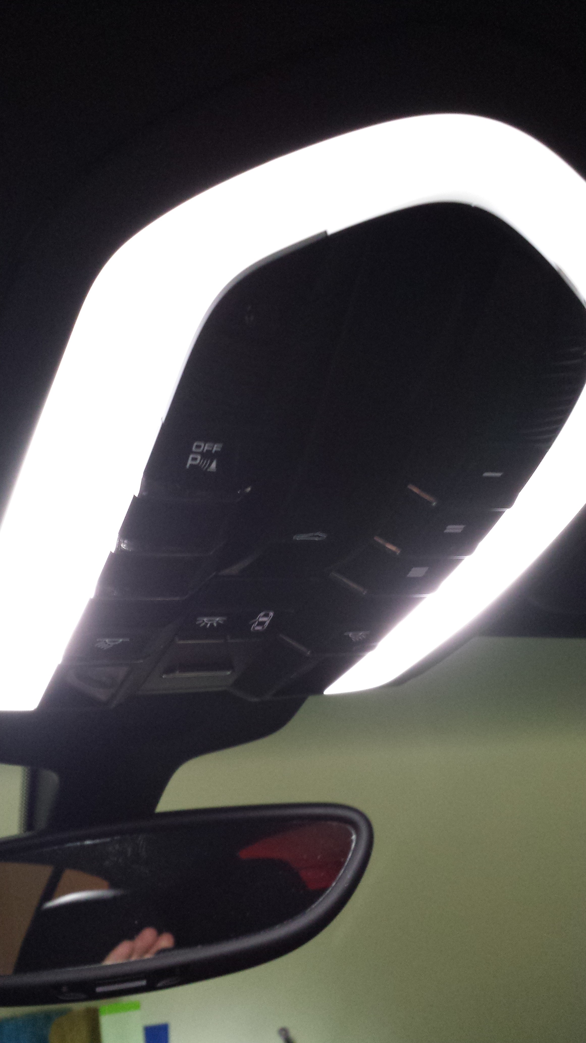

Thanks to this thread, I replaced all of the lighting with leds with the exception of the vanity mirrors. I ordered a trim tool kit from Suncoast parts and the leds were ordered from Amazon. Here is an example of the new led light for the overhead console
