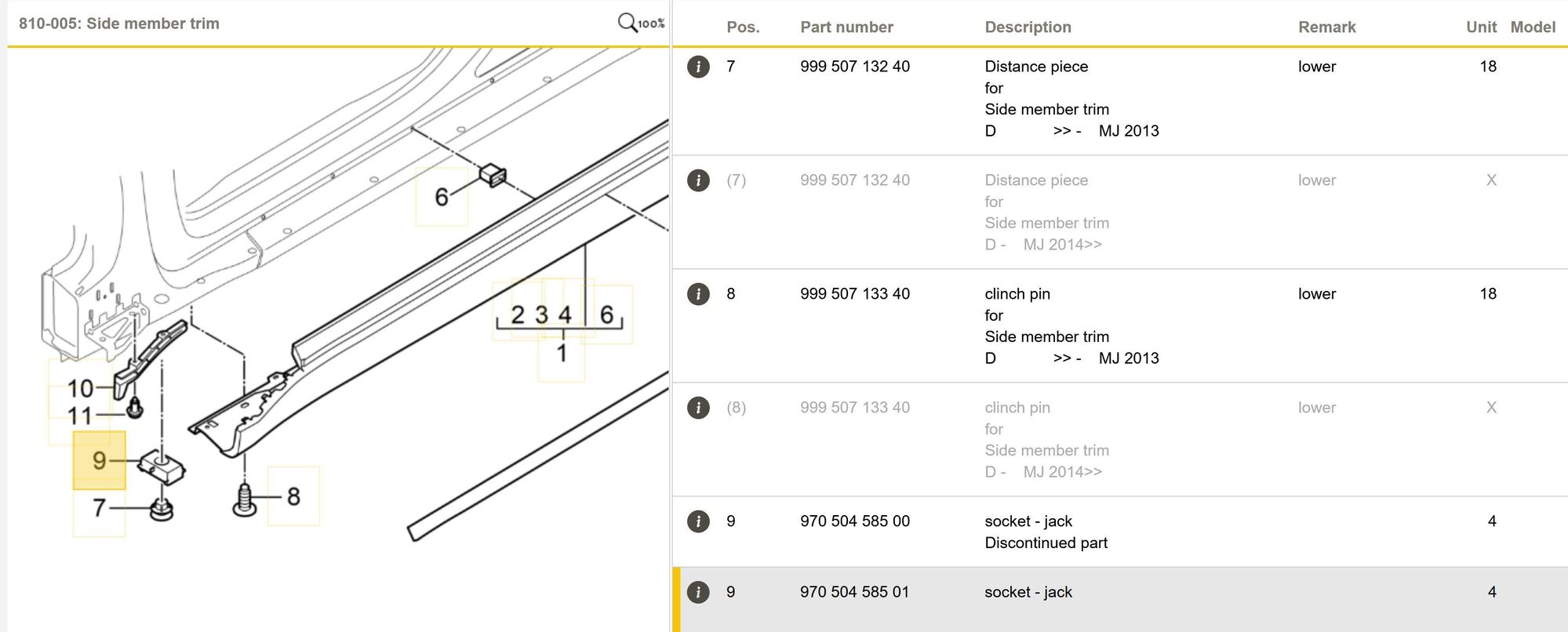

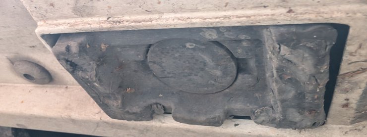

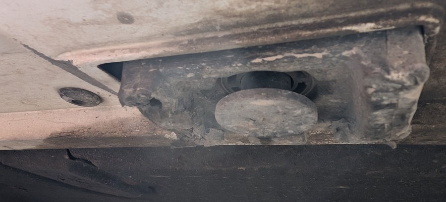

Originally Posted by lesliew
has anybody replaced 97050458501 socke-jacki A - outer ? Can't see any fixing bolt or screw... how to remove old one ?
Old Oct 2, 2024 | 05:58 AM

You pull part center and you pull set

no need to remove side member trim (part no.1) ? that socket jack is pushed fully inside somehow ....
You were absolutely correct, just needed to use a bit more force on a flat screw driver
