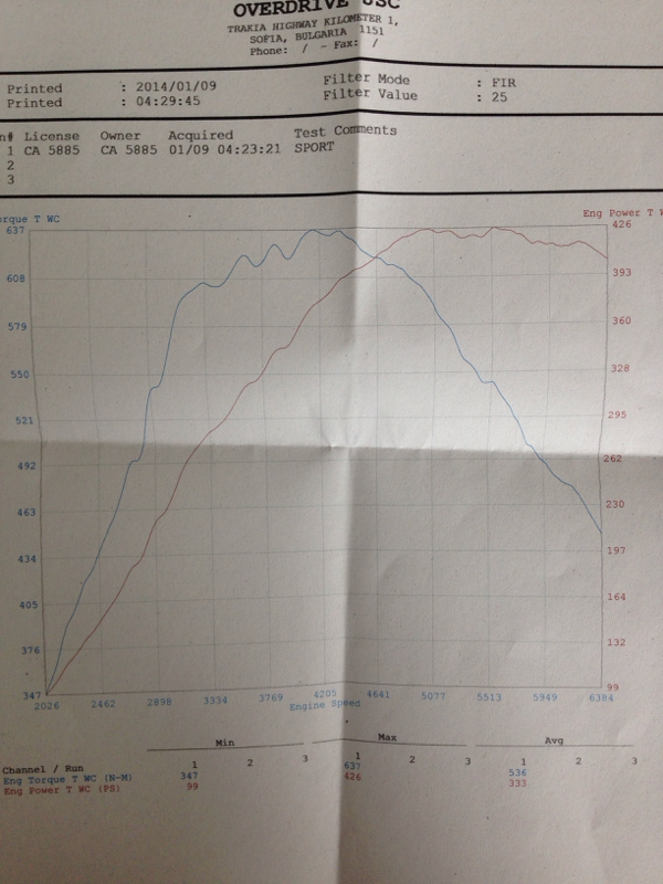

Here is a dyno graph of my Panamera turbo on a Mustang Dyno with Sport Plus mode activated.
The car ECU is stock and waiting for remap this days. The mods i have is: Upgraded Turbochargers, Sport Exhaust with straight pipes, Billet diverter valves, BMC air filter, custom made high flow y-pipe and Pulstar pulse plugs.

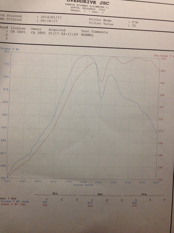

It seems my PDK is broken or it is not designed to hold that much torque...

Interesting, so if I am reading this correct you have over 800FT/LBS of torque at the wheels but only just over 500whp at the wheels? Any idea why you there is such a disparity? I just find it odd that there is that much of a difference, usually on these cars HP and TRQ are pretty close.
Sad to hear about the PDK, was hoping it might be a bit more durable than this. Do you happen to have a dyno run sheet that has a line that shows the boost pressure held at each RPM? That would be very helpful. I plan on implementing similar upgrades sometime later this year so I am very interested in whatever information you have to share.

This is 815 NM which is equal to 600 ft/lbs.

I have heard that the PDK in the Panamera is having a hard time holding that much torque. This is around the same hp/tq levels I am at in my CTTS (approx 600 awhp; same engine) with no issues for over a year and a clean dyno chart. However, we have an automatic Aisin TR60SN transmission.
Without knowing for sure, this does look like clutches slipping..
I would suggest dropping into the 991 911 section and see if any tuners have any experience strengthening the PDK clutches.

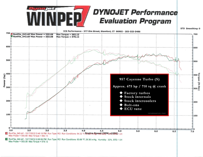

I said approx 600awhp. This dyno chart is a little outdated at 582 ft lbs tq. Since then I have added methanol injection, full 3" exhaust, and currently working on a bigger y-pipe intake. These three should have me closer to the 600 awhp number once I can get it redynoed.
Here is the dyno:

I said approx 600awhp. This dyno chart is a little outdated at 582 ft lbs tq. Since then I have added methanol injection, full 3" exhaust, and currently working on a bigger y-pipe intake. These three should have me closer to the 600 awhp number once I can get it redynoed. Here is the dyno:
Very good numbers considering you are with the stock turbochargers. To obtain this numbers i posted i have: sport exhaust with straight pipes, bigger y-pipe, bigger turbochargers etc...
