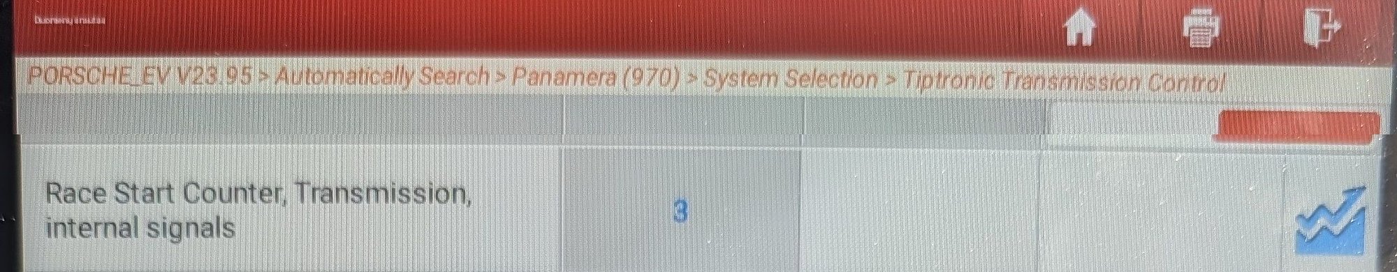

https://www.718forum.com/threads/rea...ch-x431.26052/
.... just in case, where you can see how many times your Panamera was launched:
This is quite helpful 👍🏻
