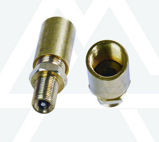

If you want to fill with nitrogen, you can go to welder store and ask for a tank with gauges and nitro2 to fill the system.
Online, you can buy the air line adapter (about 45 bucks). Once you have it all, you will still need PIWIS2 so that you can open proper valves to get the nitro in.
I almost wish that porsche would have a valve on the air tank itself, so one could simply connect nitro tank to it and fill up to 17bar (I think thats the level, but dont quote me).
Having refill fitting on the air tank would make this so much easier, and would allow to drain moisture that can accumulate, especially in cold climates.
But no, too easy I guess. I think I saw someone somewhere, make a fitting on the air tank, had it jb welded. I am sure works just fine. Thought about it for some time, but never got motivation to try.

Linked snap-on tool say 17bar so you're probably correct.
I haven't seen the fill port on the car, what kind of connection is it? threaded, quick connect, etc.?

adapter like this I guess?
Looks like schrader valve on one end and some fine thread metric on the other? :shrug:
Porsche Panamera 970 '10-16 Air Suspension Fill Special Tool Adaptor 00072198250 | eBay

Filling Adapters.
They are listed as Porsche part number 00072198250:
https://www.ecstuning.com/b-genuine-...t/00072198250/
Of course disorganized me can no longer find my set. Sigh...
