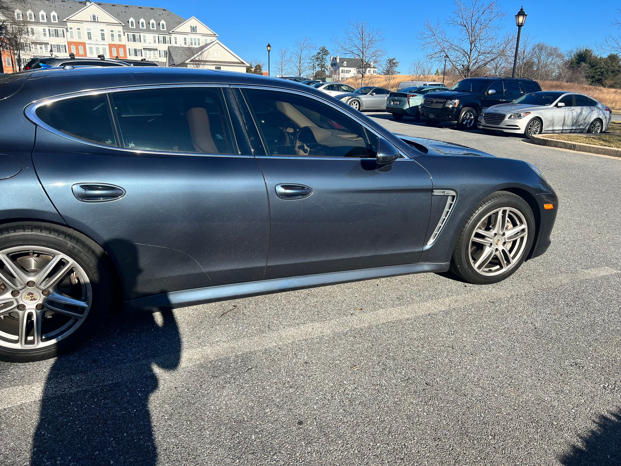

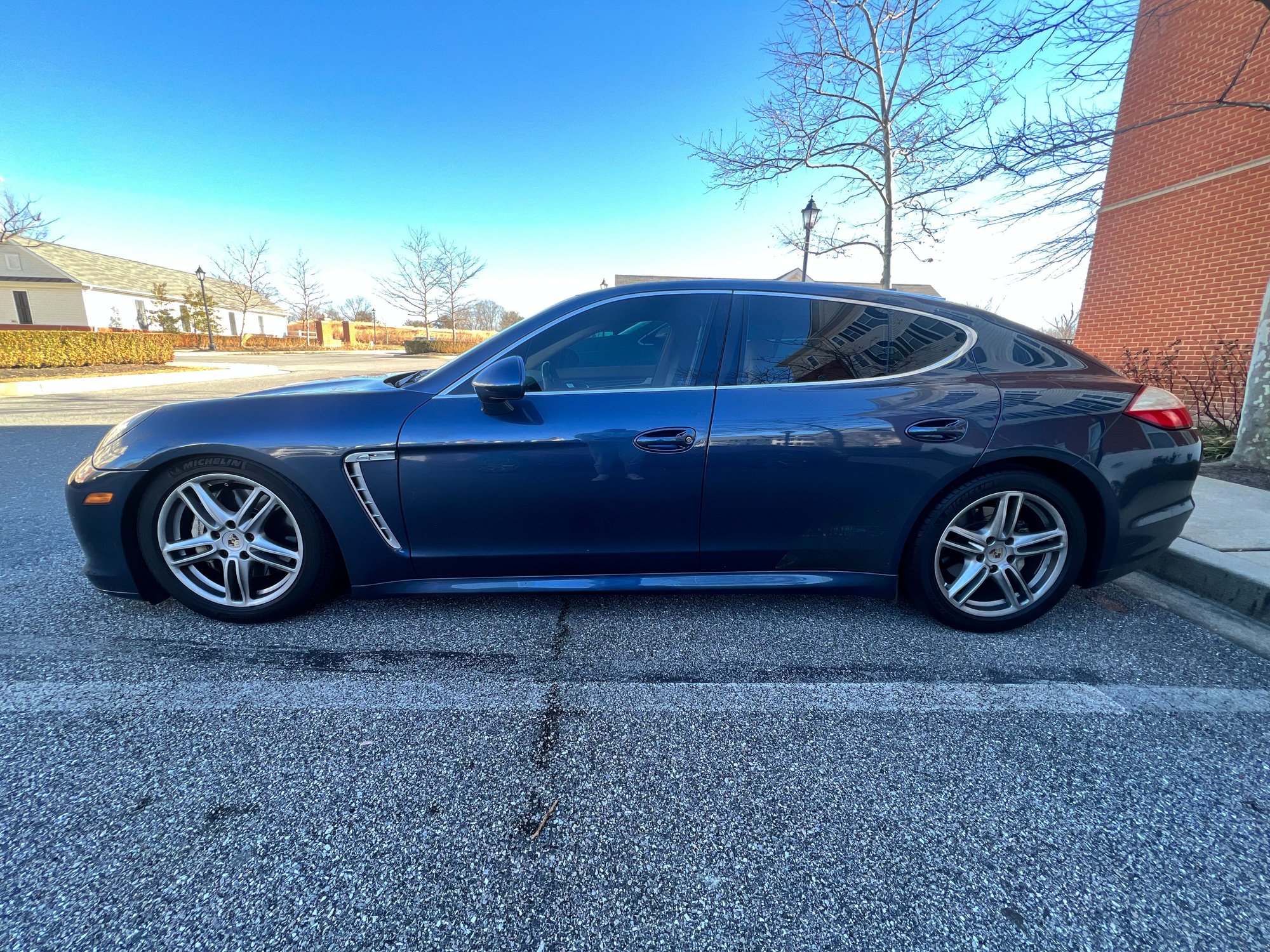

Originally Posted by reconguru
Hello Group, Newbie here. I am enjoying the same problem with my 2010 Panamera 4S. 20 degree F weather caused RED Chassis Failure light to come on. Car was lowered in hooptie mode, would not raise and rode like there were no shocks at all. I drove the car slowly and carefully to the dealer where after 20 minutes, the light went out, the suspension raised up and the car ride was much smoother. I left the car with the Porsche techs for over a week, they replaced various parts (unknown which parts at the time of this writing) and started to deliver the car to me when the light came back on. So far the response from the dealer is that it is a cold weather issue, nothing more. They are still trying to resolve the issue.
The option to wait until the car warms up for 15 to 20 minutes is not acceptable, I often have to respond to emergencies and have little time to let the vehicle warm up completely.
Does anyone have a solution or know where I could point the technicians to gather more information or research?
we are in the same boat, I have the same issue when it’s 30 degree or below, the RED “chassis system failure” comes on, then goes away after 20-45 min after start up
the car rise up to normal height, i never have this issue when the weather is above 50 degree
