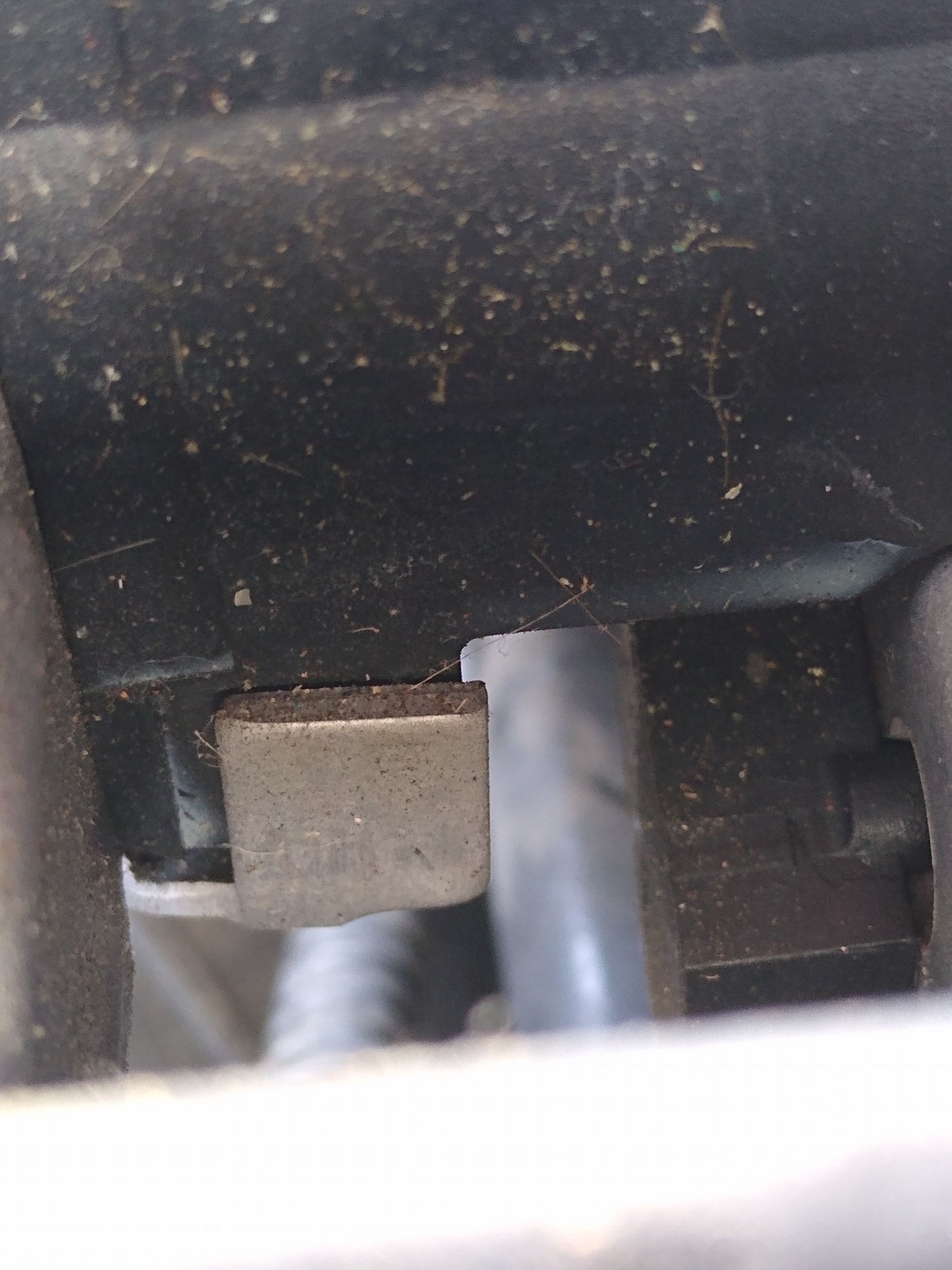

Would someone please photograph how the lower latch operates? I can gain access to the assembly from beneath the car, but I don't know how to release it. Should a rod be inserted to push a particular area? Should it be pulled? Should I attempt to gain access from the driver's side or passenger's side? Maybe someone can open their hood and have another person pull the release cable from the passenger compartment so I can understand how the mechanism releases so I can replicate it.

Sorry I didn't think of that sooner!
View from passenger side
View from driver side
Passenger side camera looking forward
Driver side camera looking forward
Center camera looking forward
It does not look promising there is a way to manually activate it. I felt around underneath. Best bet is to pull the wire inside the release cable somehow...
