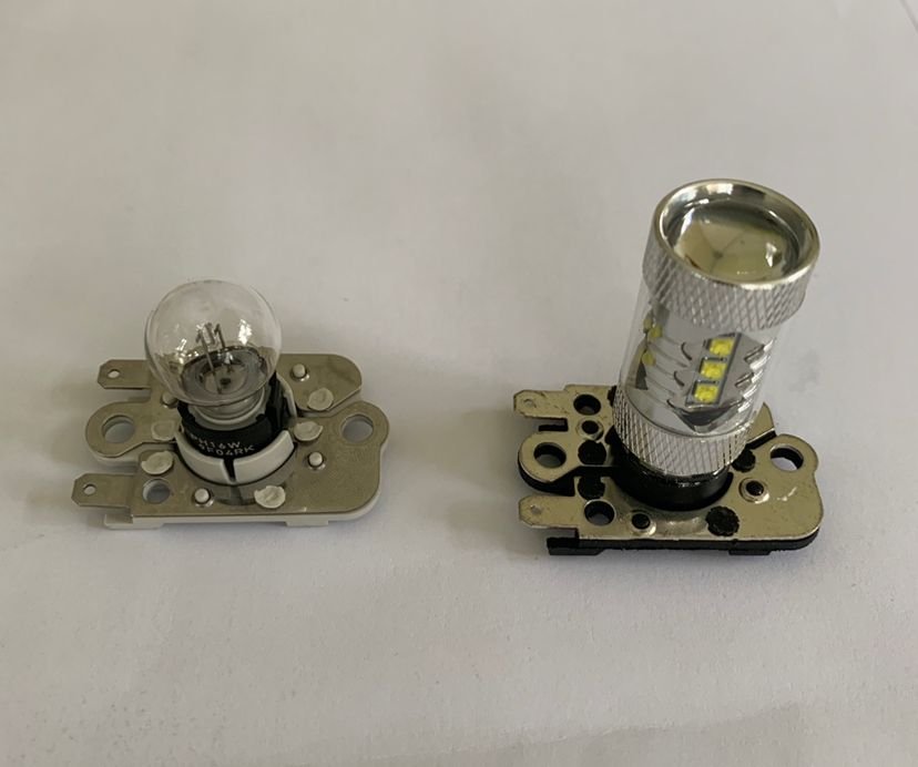

here you go ciaka
https://www.amazon.com/gp/product/B07MV6QVZ2/ref=ppx_yo_dt_b_asin_title_o02_s00?ie=UTF8&psc=1
plug and play and a very noticeable improvement, not bad for $25 they also arrived about 5 days faster than predicted
you'll want to check your tail light assembly before ordering them, make sure you have the access hatch

I went with the 50w, was a bit worried about the wires, didn't want to push it

Agree. Dont over do it with wattage, or you will get melted socket, which you will have to replace.

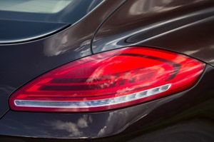

I am having the same issue as 970gts. Looks like my tail lights are the newer version with the reverse being a white strip along the bottom (image below). By the looks of them, I would assume they are already LED. But I have the same issue as everyone else in the thread with very low light when backing up at night and basically being able to see nothing in my rear camera. Anyone know if there is a way to possibly upgrade the LEDs in these?
