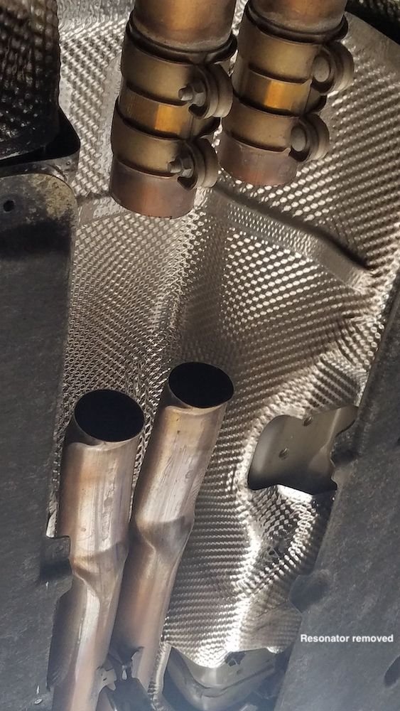

A worthless thread (because no sound clip) PTT with Magnaflow 10790 X-Pipe installed
EDIT: Here is a video of sound comparisons. The big difference is in low tones that are very apparent at lower RPMs. Makes car sound raspier and more gurgly. From inside cabin, cannot hear difference almost at all, due to sound proofing materials used on Panamera. Hope it helps.

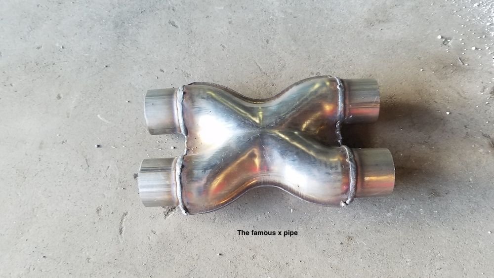

Flo1989 twisted my arms, and I got me the Magnaflow x-pipe, and just had it installed in the car. Will have to take the after vids for sound, etc.
First impression, there is much more low frequency rumble at lower rpms, while at higher rpms the exhaust seems to sound deeper and throatier.
It is very hard to tell from inside the car, as it is thermal and sound insulated.
From inside car, I would have to struggle to try notice a difference. That is how well insulated things are there.
From outside, the difference is very apparent. And it did cost me same as his job was, total about $160. $92 for x-pipe off ebay, $70 for labor at a small muffler shop. Going to a small muffler shop is key. Large shops wanted to charge me $200 or more as soon as I drove onto the lot with the Panamera. This guy, I spoke to him on phone, told him what I want to do, he said come on down any time.
Just wanted to post up, will update with media soon. Thank you for your suggestion Flo1989.

It will be a day or two before I get a change to take edit and make comparo vid. For interior, the sound proofing is awesome. When I told the muffler guy to sit in and get on the gas since I cannot hear from inside, he laughed. Then he sat in, and immediately said 'holy crap, this thing is fricking insulated to the max'.
From inside you hear ever so slightly more. You wont even notice it. No need for Burmester. No need for any radio to drown out anything. I was surprised very much.

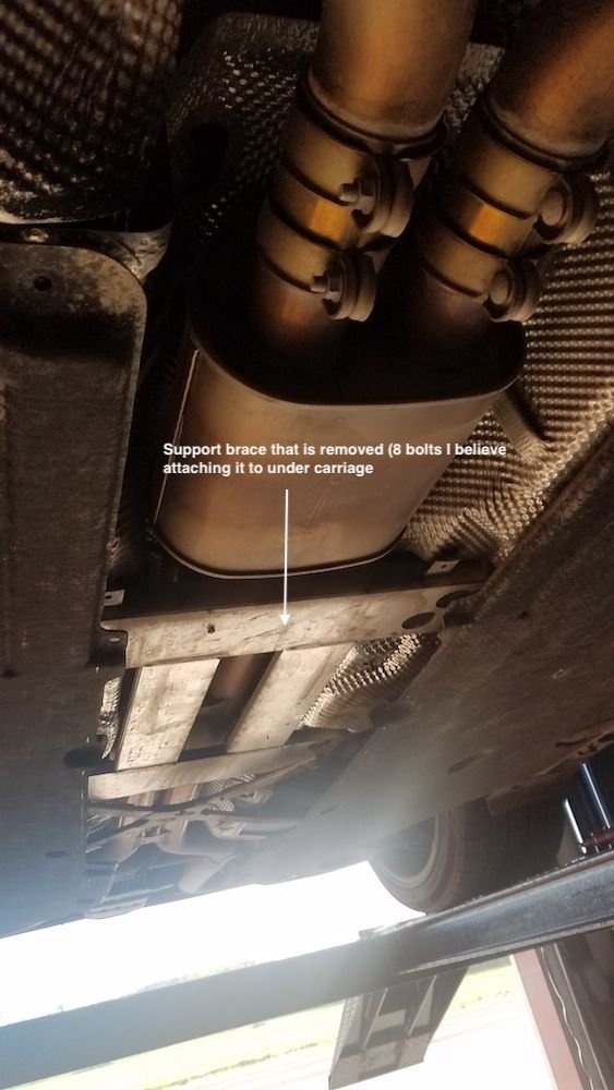

do do you have a picture or diagram of the exhaust and exactly what was replaced?

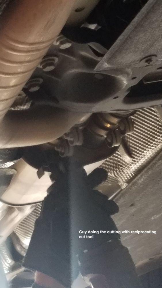

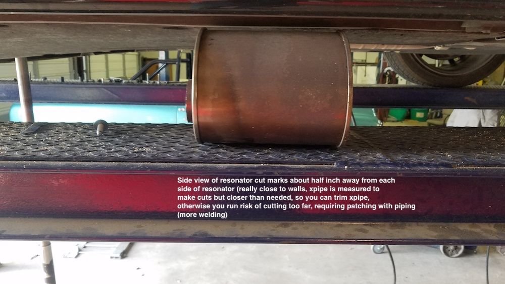

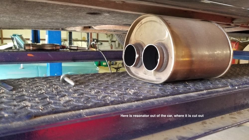

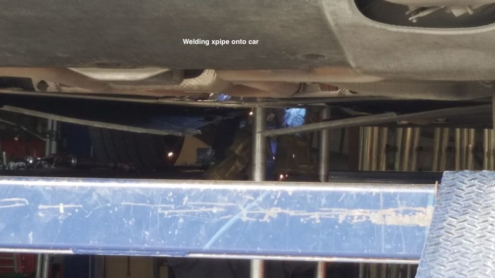

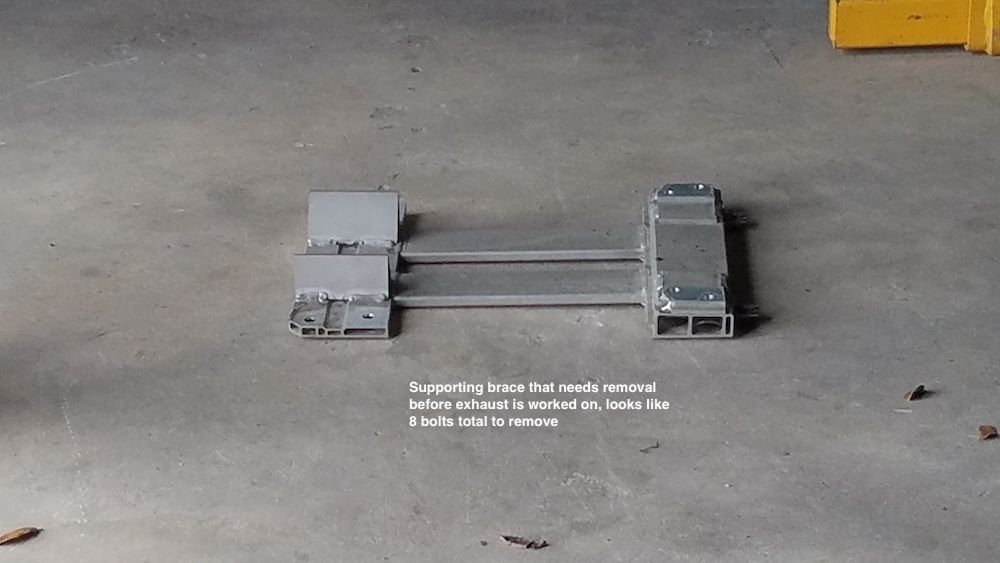

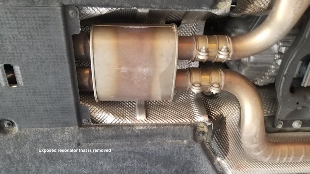

I have full set of pics as if I was making DIY for replacing the xpipe. The guy was super cool and while he was working, allowed me run around with camera to take whatever pics I wanted.

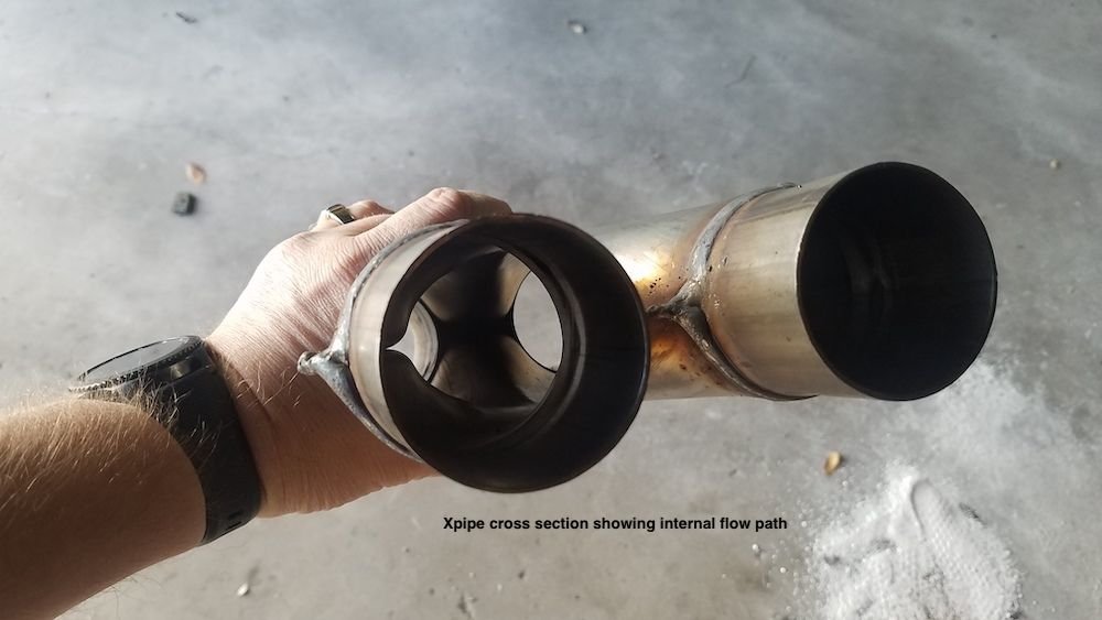

can you post pics of the weld of the x pipe?please . the part # is 2.25" would a 3" work better?

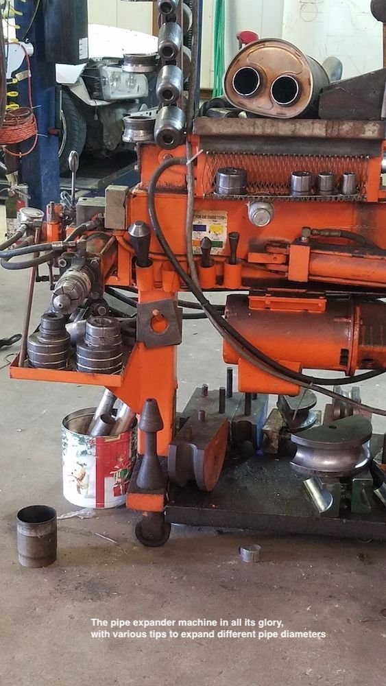

In mean time, for Panamera GTS and turbo, DO NOT BUY any other size than 2.25". It is the size that will fit your car. My muffler guy had to take the xpipe ends and expand them ever so slightly since he was very **** about things fitting just perfect. 2.25" is what you need to buy - Flo1989 link is one. I got mine off ebay but entered the same Magnaflow part number and saved about 20 bucks. Spend time finding a small muffler shop that can give you good price. For large shops, they will see your car and will automatically add 100 or 200 bucks to the cost. Guaranteed.

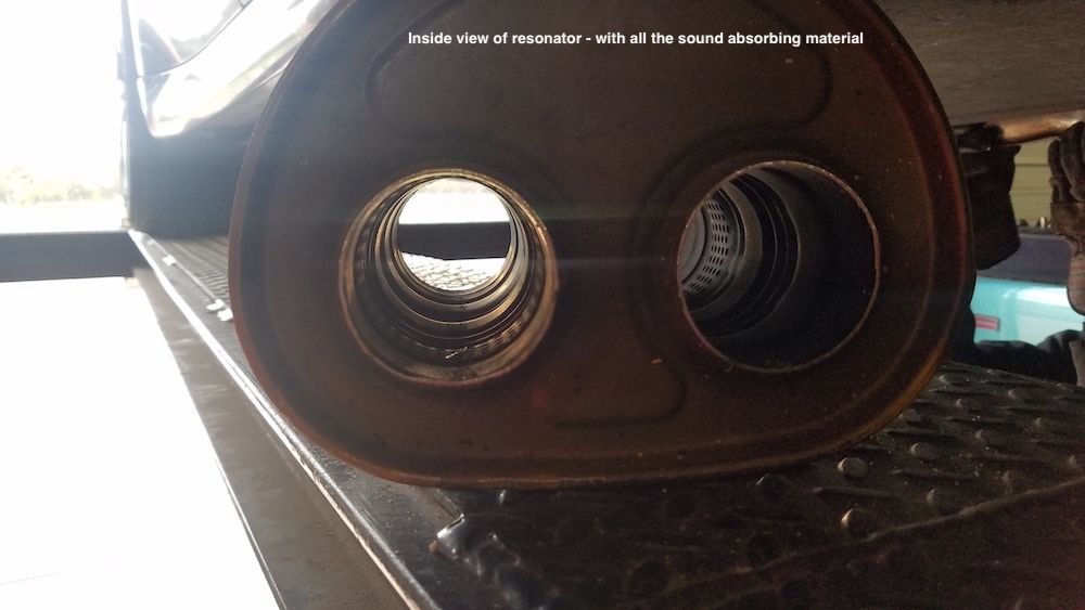

Made an update to put up pics, showing the work done. Next, will be some vids.
