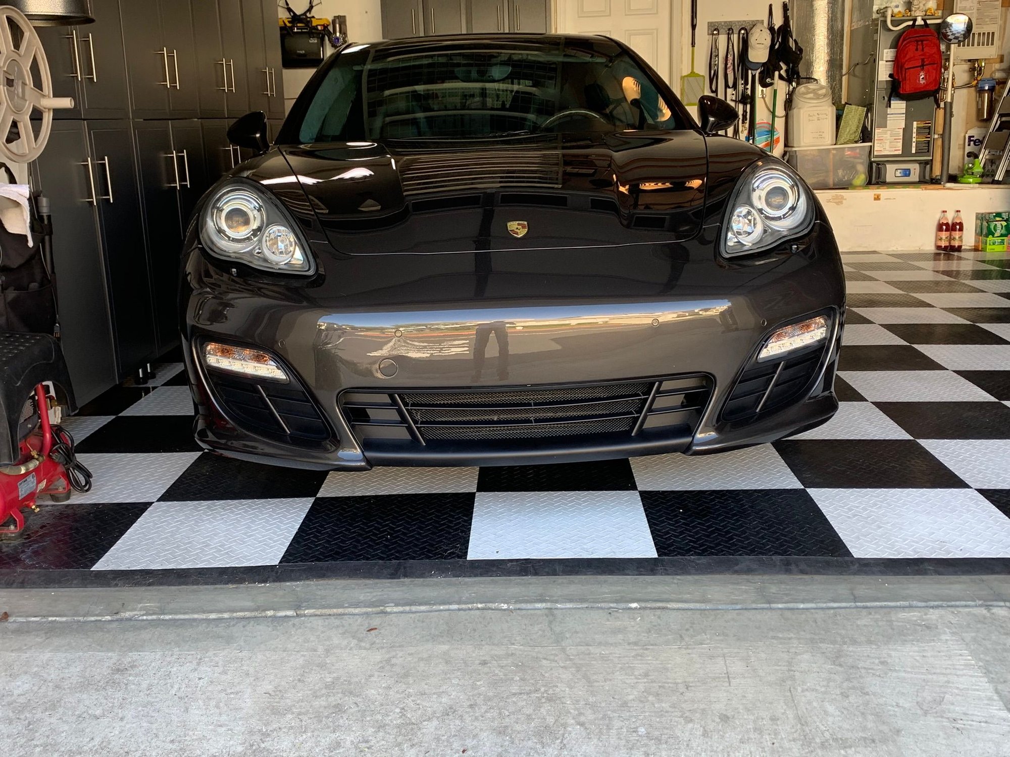

I recently installed one on my 4S with a Sports Design front bumper. I used a piece of rain gutter mesh covering that I bought from Home Depot for $4.00. It's metal, has a very durable black paint/plastic covering on it and was easy to mold and install using small black tie wraps. I think it came out pretty nice.

I love that grill and the plastic inserts! Mine looks nothing likw that on the aero kit. Wonder if there was a different aerokit for turbos and non turbos? Mesh looks killer😊

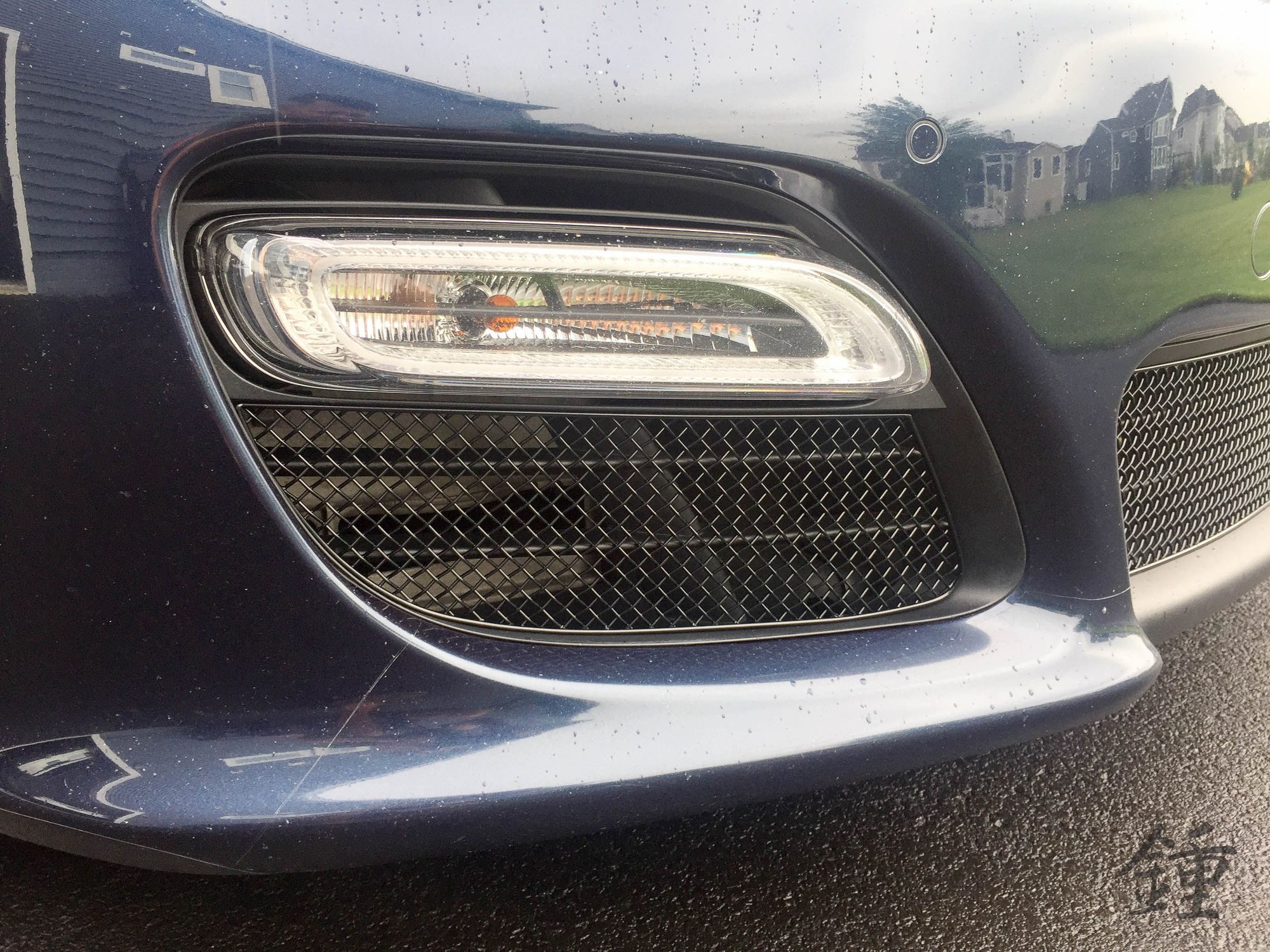

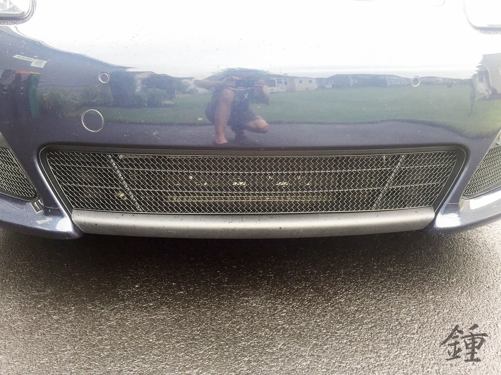

Zunsport for Panamera 970.1 with this bumper style and without ACC...

Damn, That looks good! They are rather expensive considering what they are but they look great and seems like install is a snap. I may get these.

Ha-ha, yes install is literally a "snap". Grills are well constructed with the mess tacked/welded to the frame on the perimeter. Three hooks each for the side vents and 8 hooks for the center grill. The hooks latch onto plastic surrounds that are behind the intake openings. No drilling or modifications required to the bumper. For the Panamera, Zunsport only have grills for the 970.1 Sport Design bumper. I installed mine to avoid puncturing my A/C condenser a second time. Search for Zunsport discount/coupon code... old ones may still work.
