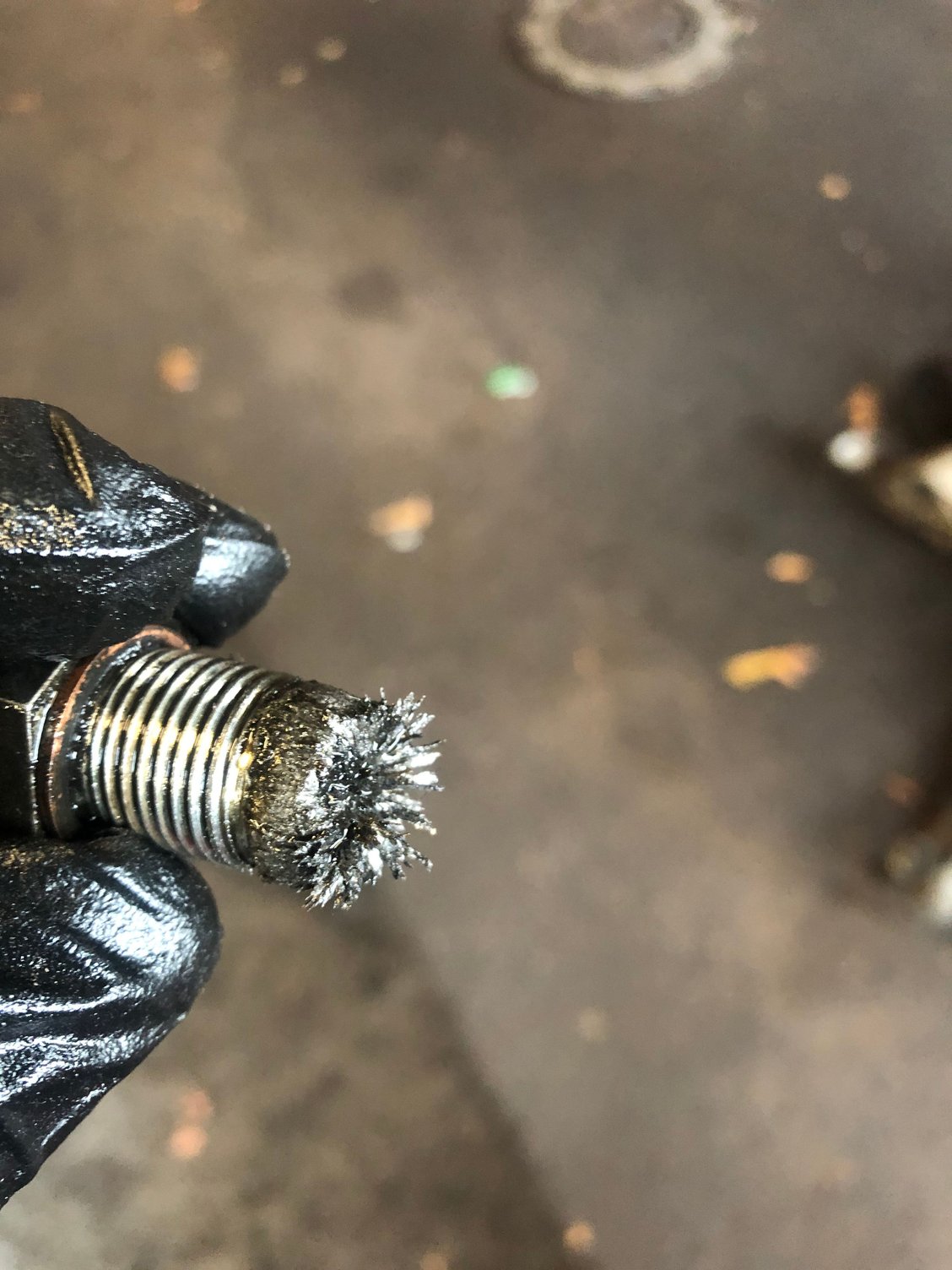

Got around to replacing the diff. Located a used one with 40k miles for $800 delivered. Massive job, my mechanic said it was incredibly difficult to remove the diff. The drain plug from the old diff

Yes, that is why I removed the fill plug, sucked out all the fluid, measuring how much came out, then filled in using same hole. Easy job this way. What was sucked out matched capacity in FSM so confident all fluid replaced.
Good job replacing diff.
