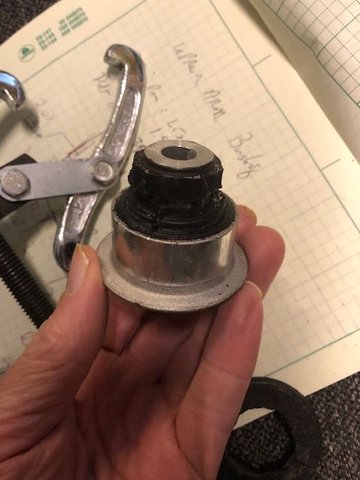

I'm going to redo the bushings in my car this spring, so I'm making some polyurethane replacements,
I have a couple of upper arms from a friends suspension work where he decided to just replace the upper arms with new updated pieces.

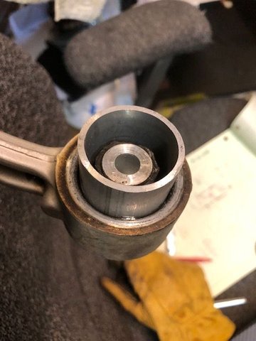

First thing, you'll need to cut the rubber of the inside of the bushing, the upper bushings are hollow for about half the length, cut from the inside of the arm, the outside s thick and has lots of metal
Both sides push out from the inside of the arm.
not much needed, I'm using a 1.5" aluminum tube O/D (1.3" I/D) capped with a piece of 1.5" aluminum round rod that was machined down a bit to slip onto the end.

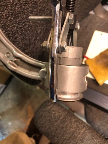

and a bearing puller
Getting started can be a bit tricky as the bushing cover a very large part of the arm, you can just get the fingers on it, helps to hold it closed with one hand while you get it started.
Couple of cranks with a wrench and it's out,
