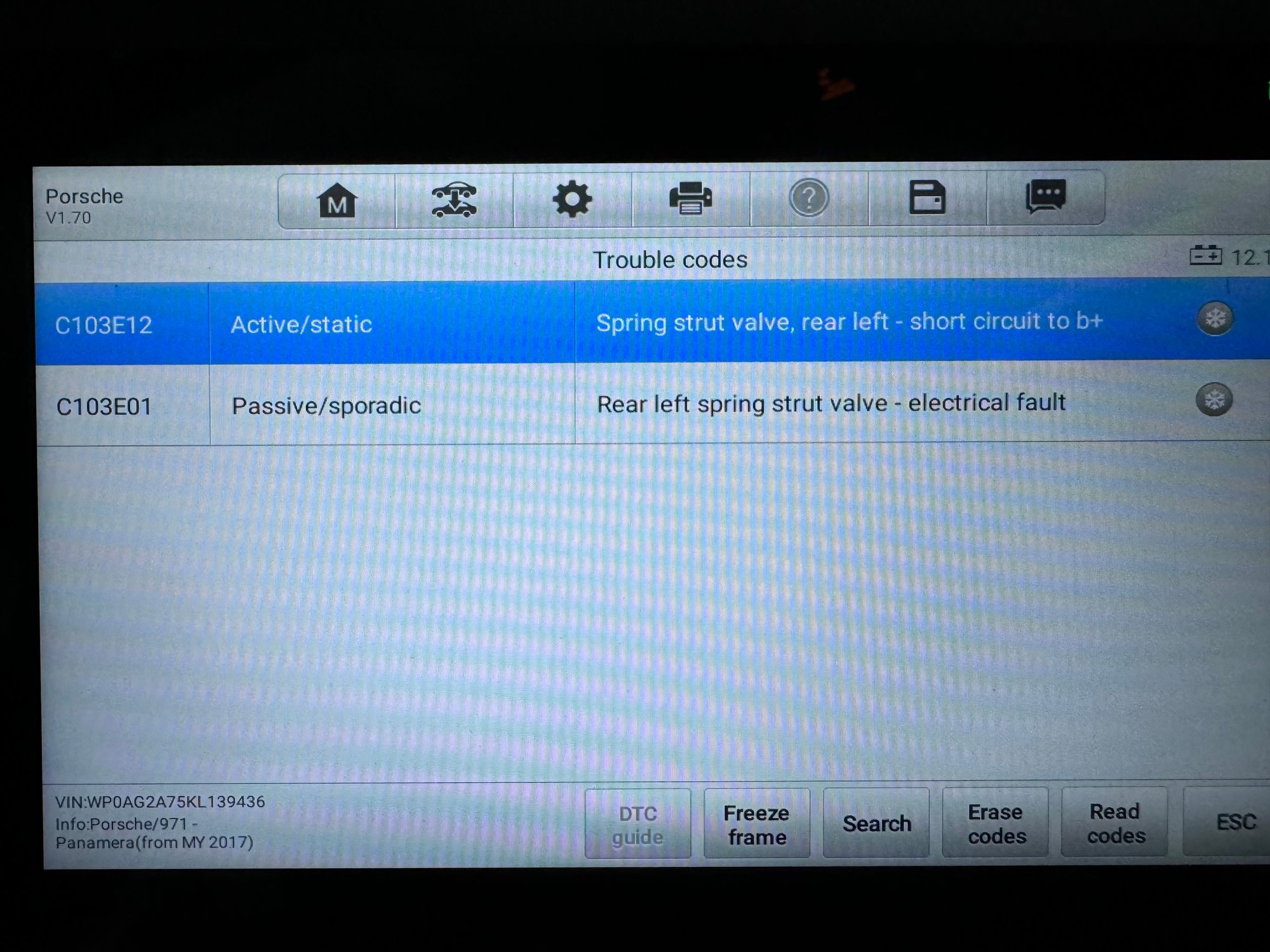

Hello!
Would like some assistance here before I go find an indy or dealership to diagnose/fix the car.
Error was only showing intermittently for the past 1-3 monts. However, this week, it has stayed on. Prior, the leveling/height control was working perfectly (even when the error disappeared).
Did some research online for possible causes (low battery voltage, damaged cables, etc). I didn’t see any damage around the strut/suspension (didn’t check behind panels/inside the car yet) and will be checking voltage later today.
I attached the error I am getting. Please help/advise on next steps.
Thanks in advance!
EDIT: wife drove the car this morning for about 50-60 miles. There has been no chassis system fault on the dash (from start up until now). The fault was there last night (unable to clear with Autel MK808s).
EDIT 2: chassis system fault came back on before my wife got home.
Checked the battery and date code was 10/19 (likely original/never replaced). Pulled the trigger and bought a new one. Install was a pain (because of the foam that hold the pump/towhook/flat sealer thing). Foam was blocking one side of the battery.
Before the install both DTC codes were present. After the install and battery registration, the passive fault remained. After clearing the passive fault, test drove the car for 10mins while checking for any faults/codes/DTCs along the way. NO FAULTS/CODES came back (before the new battery, I could not clear any of the codes). CHECK YOUR BATTERY FOR CHASSIS SYSTEM FAULTS (read this somewhere too).

Fault is back
Getting the chassis fault again. Still coming ON only after driving over 30miles. Goes away when the car’s been off for at least an hour.
Code reader still says passive/sporadic - Spring strut valve, rear left - short circuit.
Could the valve get stuck?

I may have found the solution.
I went to Porsche to get the airbag replaced (out of desperation thinking it was the sensors in the airbag). Unfortunately, this did not resolve the chassis fault.
A few weeks later, I was speaking to a guy who know Piwis. Surprisingly, he had a different type of chassis fault (leak). He was going through the process and he mentioned height calibration.
I looked at the repair summary from Porsche and did not see any height sensor calibration. So, this afternoon, I used my autel mk808s to do the calibration. Before starting, I confirmed I had all the same chassis faults (instrument cluster chassis fault came on too as I pull in the garage). After the calibration, I ran the codes and they were all gone. No faults on the cluster or the scanner.
I will monitor the car the next few days if it comes back.

Unfortunately, the chassis fault came back on. I am thinking this is a wiring or sensor issue somewhere between the module and strut sensor.

Might be fixed
After checking all connections, changing the valve block, and recalibrating, the chassis fault (rear left strut short circuit to b+) still came back. Worse in the heat and recently even in the cold weather, fault was still coming back.
HOWEVER, a few months ago I bought a used PASM from Ebay ~$150 (same model just different last two characters AN -> AJ). When I first installed this, I was getting multiple errors so I thought it was not compatible.
I tried again this afternoon. I read somewhere (nhtsa doc I think???) that the ignition needs to be turned on and off, clear codes, and perform a height calibration. Used the autel MK808s.
I did. No error codes came back. No chassis fault. Car felt better. All modes working. Drove it in hot weather. No issues. I’ll keep driving it the next few days and see if this is the solution. Will update here again.

Confirmed fixed!
after +100miles, chassis fault never came back. No errors on the PASM module. Car runs great again!
