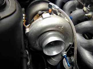

u may have the best setup in the owrld but if you stuff aint tuned right it dont mean jack $hit! loli had fun with my old supra ... it been decommision for 2 years now but ive been getting the bug to resurrect it...
here's a pic of the turbo i had on it.. it's a TO4E ball bearing turbo...
had fun boosting this baby at 16-18psi
