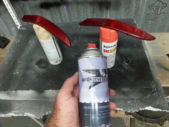

DIY: Paint existing rear reflectors
Lightly scuff surface and edges of your reflectors with (red) 3M scotchbrite pads (you can also use household type). Secure the underside of your reflectors with tape, dum-dum, or ? to a 4x4, full spray paint can or ? This will prevent your reflectors from getting blown off from the slight force of spraying. Clean, then spray (edges first !) two coats of adhesion promoter, (note: the reflectors will get shiny again-that's the adhesion promoter doing it's job !) then three PTM base coats and finally one coat of high gloss clear. (Follow instruction's on each can for dry time between coats, room temp, etc). Let dry for a full day and carefully re-install. Adhesion promoter $7.95, your color basecoat $19.95, high gloss clear coat $7.95 shipping approx. $10.00. Total: $ 45.85 and plenty of product left over for misc. jobs, re: key fob's, touch-up paint, etc. Note: I used Dupli-Color high gloss clearcoat because it was on the shelf. Would advise ordering everything from one source for continuity and to save on shipping. I used: http://www.automotivetouchup.com/tou...sche/2015/911/ (no affiliation) T
