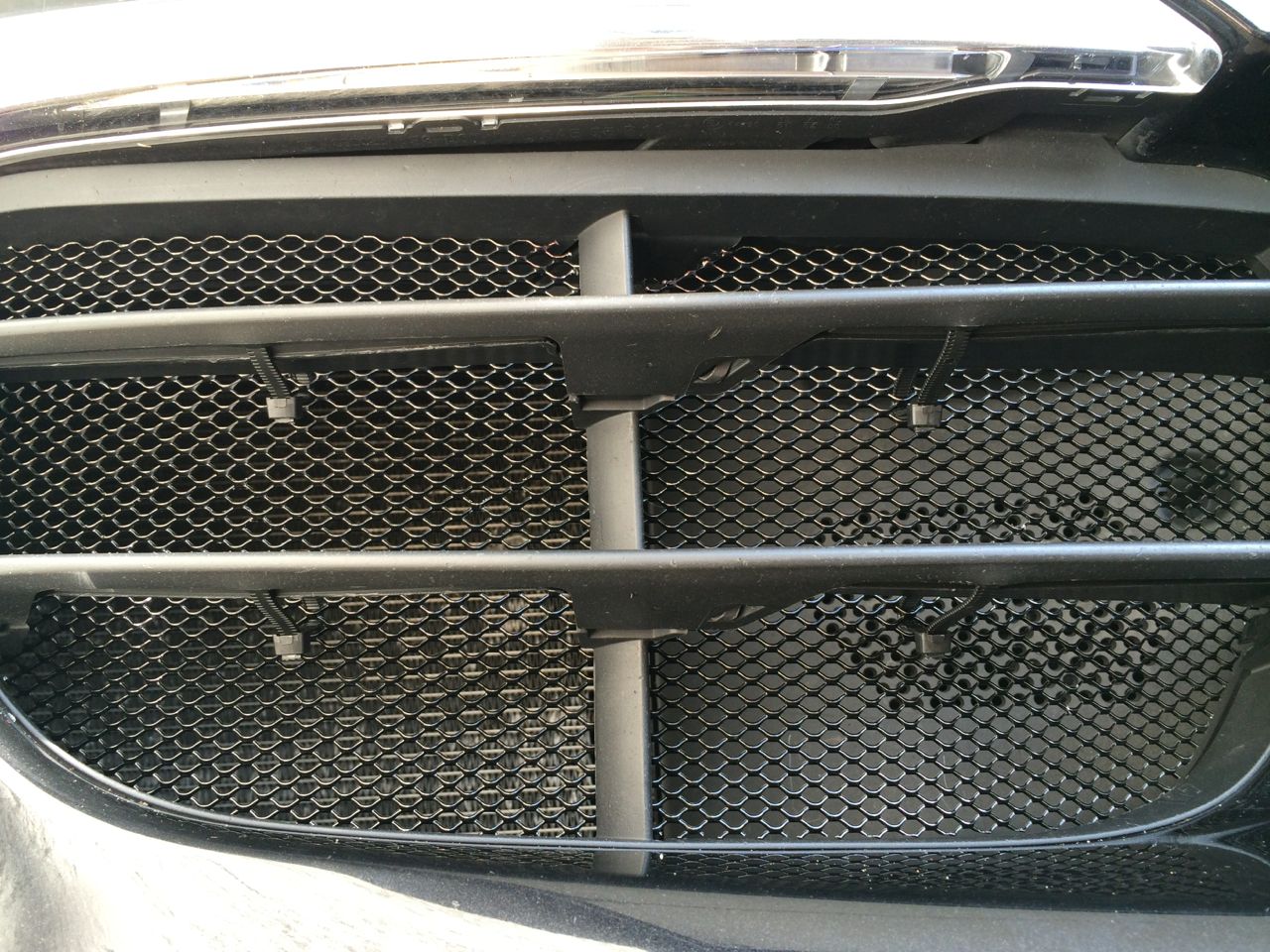

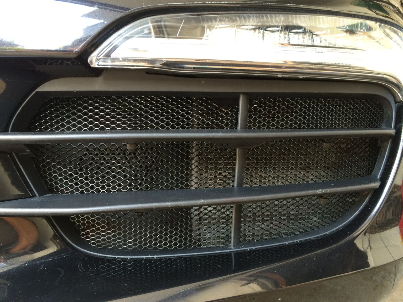

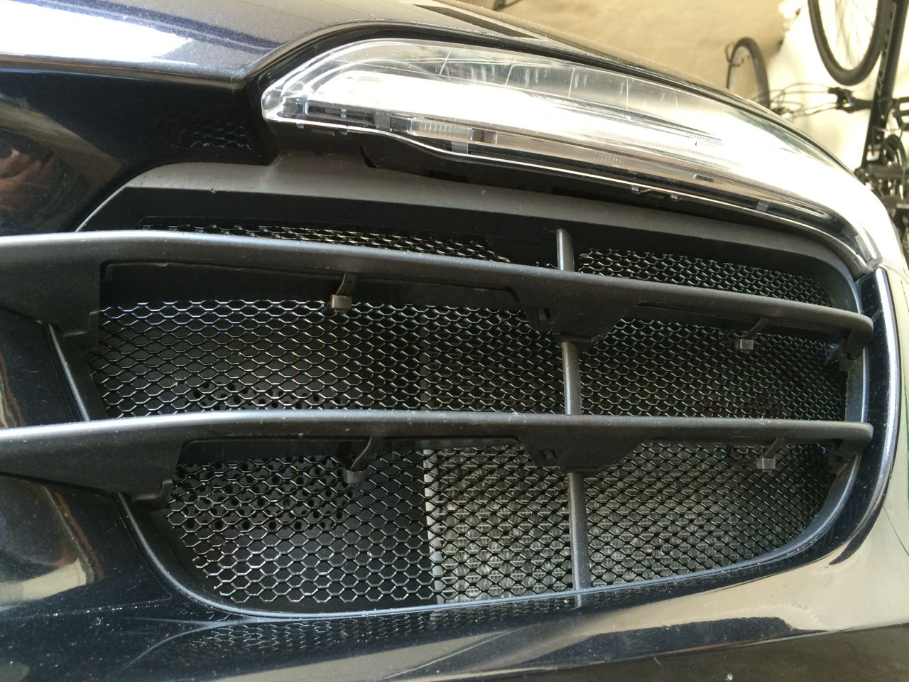

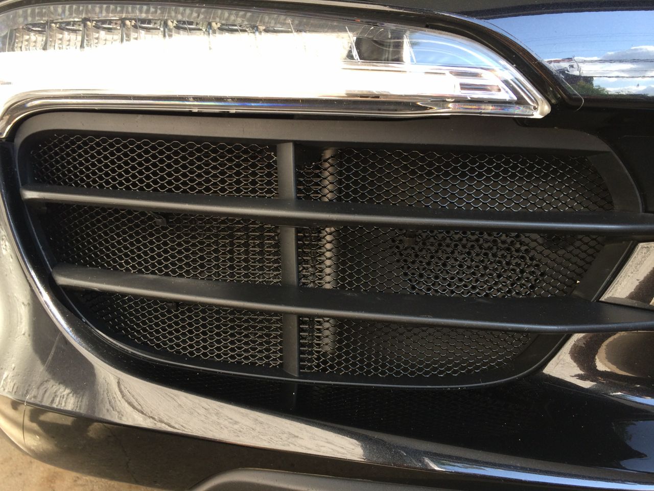

DIY Mesh for front grills
Did my own front grills with Mesh today. Following Jim M.'s lead I precut the mesh roughly to the shape of the opening. I then slid the mesh through the same opening Jim M. used but inserted it flat and upwards towards the top of the radiator inside getting my hand in underneath to help it. Once in I straightened out the mesh I put it into place and fit the ties in the appropriate spot. I only have pics of the mesh after installation hence the detailed description.
What I did differently:
1) the two slats in the grill opening are actually covers over thinner slats (think replacing the black ones for chrome ones like on the 50th anniv. model). I removed these and it provided significant additional room for my hand and the vacuum nozzle to clean out the area ahead of the installation;
2) I lined up the ties therefore towards the middle of each slat and on re-installation I forced the black cover pieces over the ties to conceal them (from the top at least). In the pictures you can see the view from straight on, and then from below the slats. The covers slid on. They had to be forced on a bit but clicked into place as needed.
Note: to mount the mesh flush with the back of the slats I needed to cut off two small plastic pieces (about a half inch length, round and width of a screw) that protruded backwards from the center column onto which the horizontal slats are affixed. These pieces don't seem to serve any purpose so I didn't hesitate to slice them off.
Difficulty on the first side (trial and error): 5/10. The second side once I determined all the above: 1/10 (i.e. easy!)
