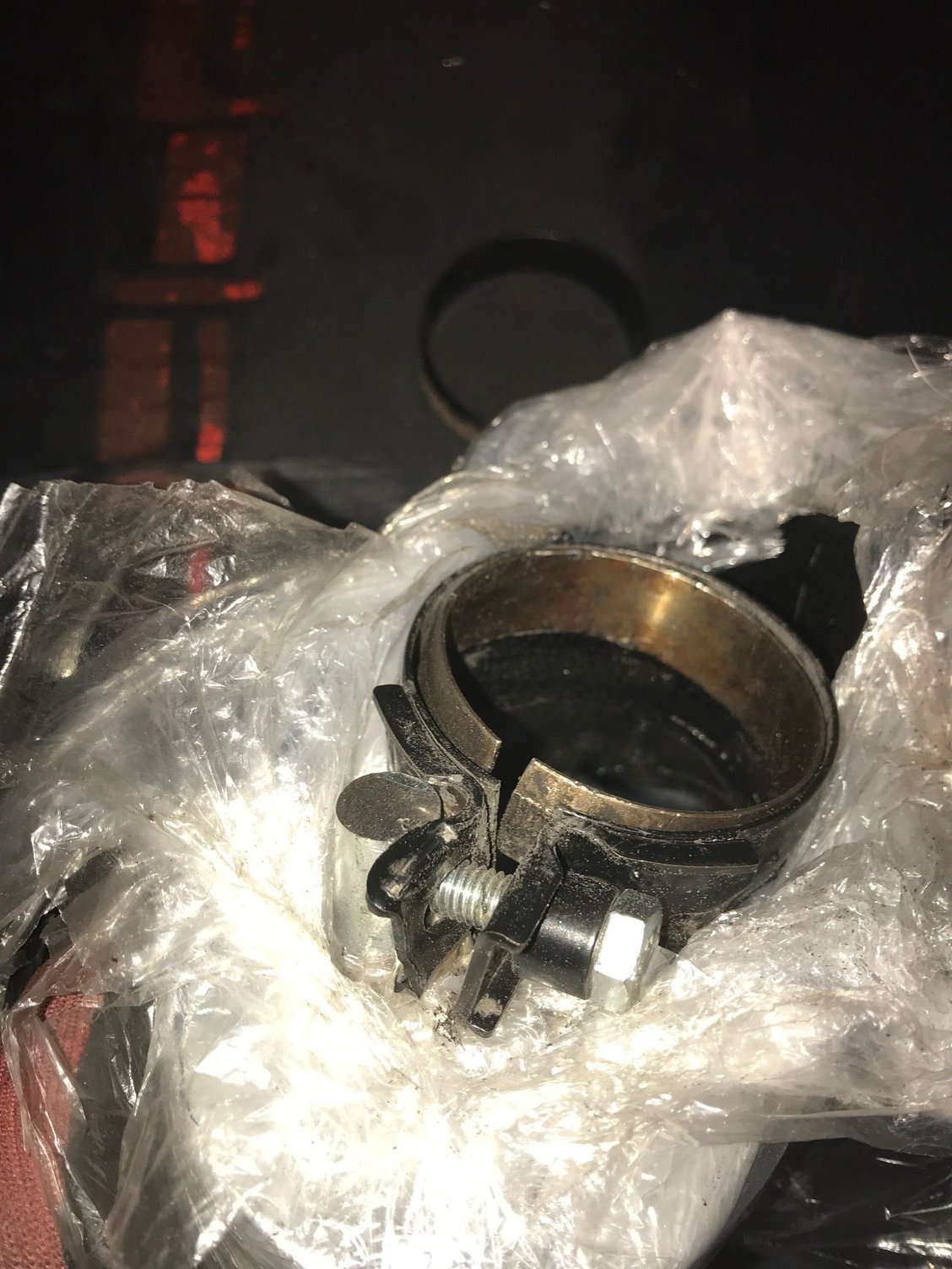

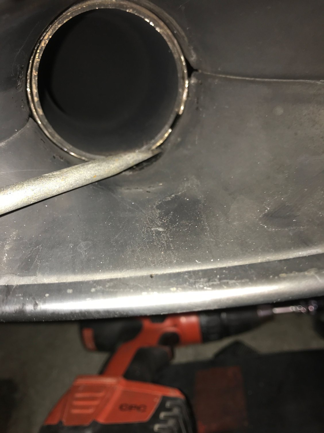

Tips exhaust 997 S on 991 c2/c4
Hello from FRANCE
I have long sought on the forum
I have my own experience
here are the details
-tipp from 997 C2S ref : 99711135204 / 99711135104
black paint SATIN 30% powder EPOXY
loosen the torx bolt at the back
it is necessary to push the ring to exit the exhaust
remove the ring on the tips 997S and insert those of 991C2
and admire
mounting with stainless steel bolts (M8 X40mm) and copper grease
risk of tracing when the grease heats

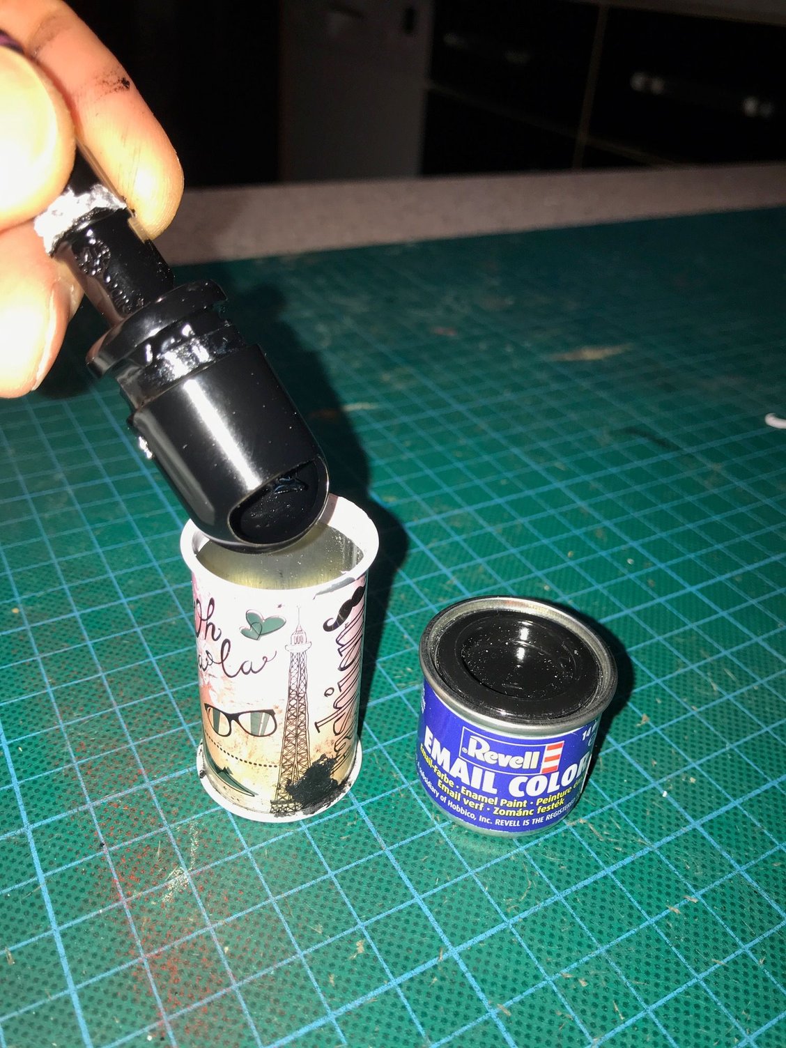

nozzle head washer 997/991 black paint
pull the chrome cap
with the house tool
personally I ordered
two new home porsche
to make my cool try
ref: 99762826300
sand with 800 and 1000
to degrease with IPA
putting a bomb primer
special plastic a thin layer
mix the paint well
REVELL EMAIL COLOR
BRIGHT COVER
ref: 32107 RAL 9005
dip into container and turn to drain and dry for 4/5 days
the paint sticks the support
take a scalpel to liberate it
the shine is incredible and the hardness incredible
on the picture the brilliant is not terrible
but I guarantee a mirror piano
