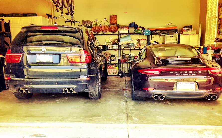

Here's a quick picture - I promise better ones soon (pardon the mess in the garage too):
