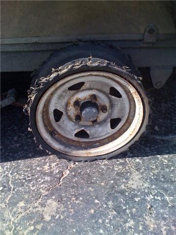

Here is a pic of a blown tire and another one at the north rim of the grand canyon.
