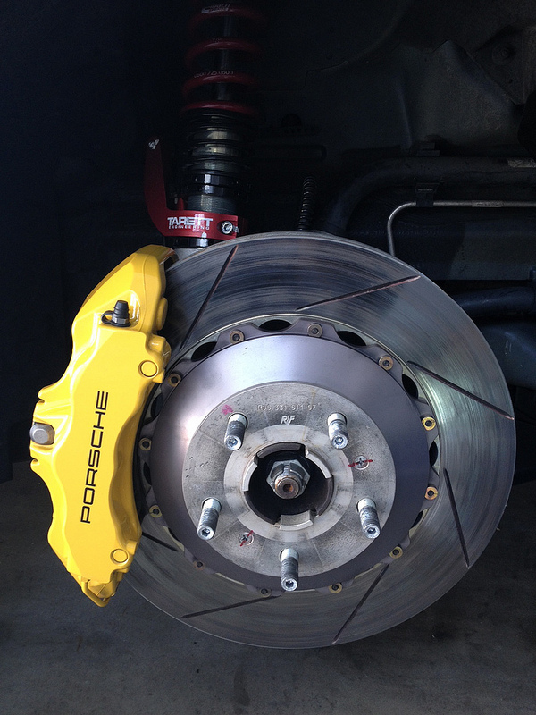

It's no secret that when you go to the larger 997TT/GT3/2 rear calipers you will end up with a softer brake pedal than stock as you are having to more more fluid with the larger pistons. The stock front 4 pot calipers 996tt and a 996GT3 6 pot calipers have virtually identical piston volume so pedal feel will not change if you just swap out the fronts. It's a different story when you change the rears as the 997TT/GT3/2 rears have almost 50% greater piston area than the 996tt rears. You will end up with a softer mushier pedal after the change. No way around it, it's simple math...

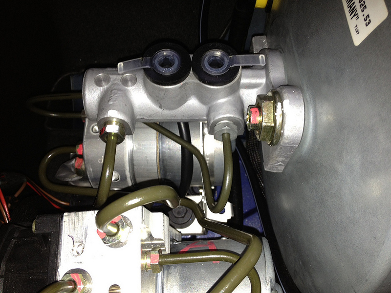

FYI, the 997TT PCCB 6 pot calipers designed for the 380 rotors have a 5% smaller piston volume than the 996GT3 calipers and the 997GT3/2 PCCB front 6 pots again have about 10% smaller piston volume than the 997TT PCCB calipers, or 15% less than the 996GT3/2 calipers or 996TT 4 pots. Still with me? Lol! In addition the 997tt/GT3 brake master has a 12% larger piston area than the 996tt brake master. That is why the 997 GT3 cars have such a firm brick like brake pedal.
I run the 2011 GT3 RS PCCB 380/350 brakes including the 997 GT3 brake master on my 996 Rturbo. The brakes feel identical to my friend's 997GT3 that has the same brakes. We both use steel floating rotors instead of the PCCB discs. It feels like you are stepping on a brick. It's a huge difference compared to the stock set up or even the 996GT3 350mm set up I had previously which felt mushy in comparison. Drive a 996TT and a 997GT3 with the PCCBs back to back and you will see what a huge difference it is.
The 997 brake master should be a part of the conversion to the larger rear 997tt calipers if you want a firm brake pedal. The difference is very noticeable. It's a simple swap as you can see in this thread...

997.2 PCCB w steel 380mm rotors on 996TT by pwdrhound1, on Flickr
997 GT3 brake master on 996TT by pwdrhound1, on Flickr
