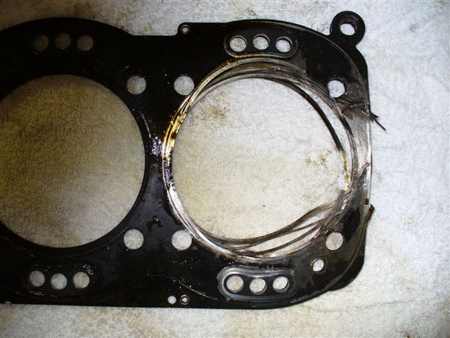

Sorry I missed your call, I was at a dinner party. Ill call you tommorrow. I have a set of liner, we can talk about a price tommorrow.
Jag
PS...I want to see pics of the HG. Pics of mine are on my thread.

Originally Posted by dgreen78
And I know it sounds unlikely that the gasket would leak with no coolant loss but the fact is it did. I have built several motors myself and have never seen this before either.
A little history for those that aren't aware, but a couple of years ago ARP had released a bad batch of head studs to the market. Looks like Don unfortunately had them on his car.
In a related story, Protomotive ended up unknowingly using a set of those bad studs on my buddy's 3.8L build. After he got the car home, he blew his head gasket at only 1.2 BAR. Guess what? No coolant leaks. Dry as a f'ing bone. But the sound was obvious, as was his power loss. Proto repaired his motor at thier expense for something that wasn't even their fault. Different studs were installed and now 2+ years later, the car is 100% rock solid at 900+ rwhp. It's driven 4-5 times per week.
Anyway, as Kevin said earlier, yes...these cars can and do blow head gaskets without leaking any coolant. I've seen it with my own eyes.

Oops! Sorry about that! Got him confused with another guy on the forum...
My primary point was that these cars can blow headgaskets without leaking any coolant. This is the second car I've seen/heard of this happening to.
Thank you for the correction, Jags.
No problem Scott. When my HG blew the second time it was like a coolant hose had blown - coolant just pouring out

I would have done a leak down before pulling the motor Don, its not that hard. Sorry to hear!
