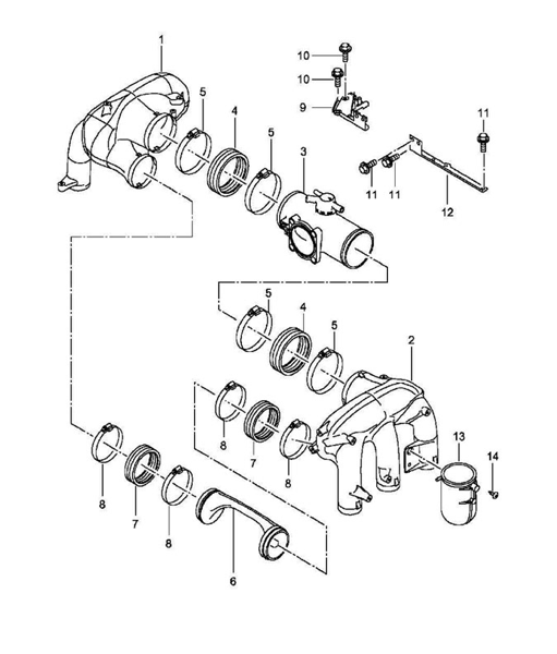

Sounds difficult to diagnose especially over the net....I would at least clean the TB. There is no valve in the TB TMK, but there is an intake distributor with a flap. Wastegates operate with boost, so this is not likely an issue, but perhaps there is a small leak somewhere?

Where is this "intake distributor with a flap"? This is what my tech was referring to, but again, when I look at the pics of a stock splitter, all I see is a hollow tube on the back end with the TB on the front.

I am trying to see something mechanical after the throttle body and nothing as per parts cat.

here is a pic. I guess depending on which book I look at it is called differently. From the PET it is TB (#1)

isn't it the throttle body Wross?
