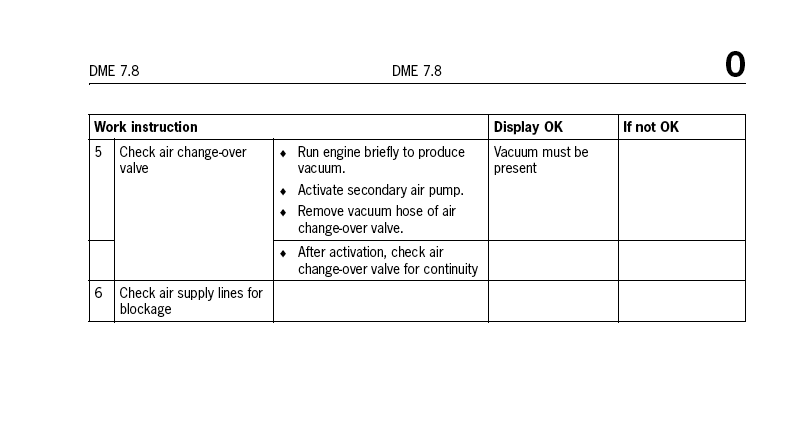

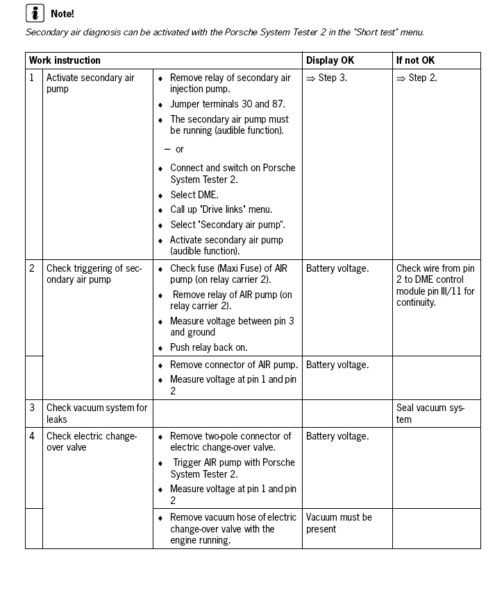

Apr 25, 2010 | 09:14 AM
See the attached information

Apr 25, 2010 | 09:15 AM
Can be related to your secondary air pump which normally start for about 30 seconds to send air into your catalytic converter for immediate efficiency. You should hear it starting... If it is working this code can be associated to a leak. See pictures....

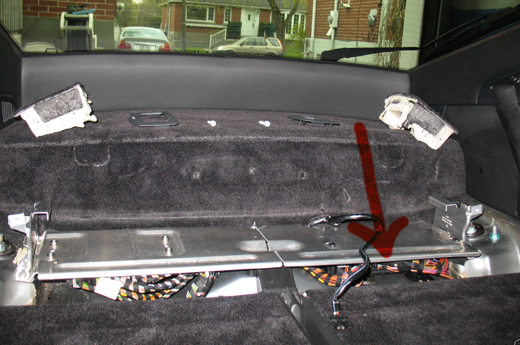

Apr 25, 2010 | 09:29 AM
location
Right side in front of oil "in"

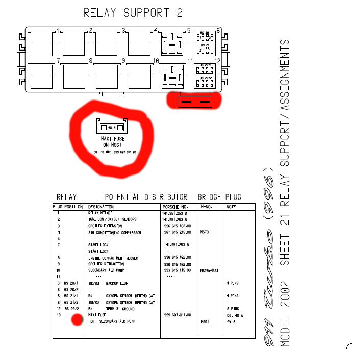

Apr 25, 2010 | 09:44 AM
If the pump is not starting it can be a fuse and this fuse is located on the relay support #2 which is located beside the ecu behind left rear passenger seat..... May be I'm overdoing it but it is always good to know....
