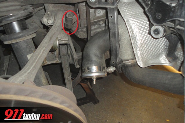

Just started doing this today and didn't get very far
It won't hold air at all. As I believe with a previous poster air is leaking freely from the hose circled in Markski's pic. It also smells of fuel.

There's a black plastic line on the drivers side intake right before the turbo. Disconnect it and do a pressure Test and if that hose is blowing air it's the check valve up on top in back of motor as usual. But this does not mean that the only leak. Good luck

Oh that's all it is. Thanks Markski. Does anybody know how one gets to that little bugger?
