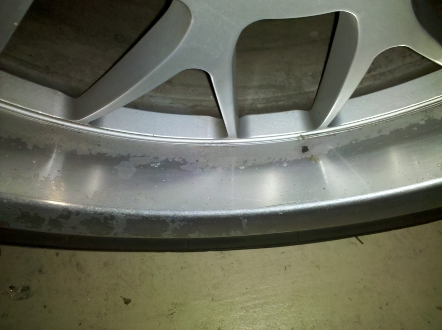

Well, here is a picture of the rear wheel. As you can see the clear coat is coming off, but the centers are perfect and no clear coat issues.
I wanted to actually strip the clear coat and polish them to a shine and leave them un-coated, but was not sure how much of a pain they would be to keep shiny. I don't mind trying to re-clear coat them, but have limited places to get a good clear-coat here in Hawaii. I tried to order some Wurth high clear gloss lacquer, but they won't ship it here to Hawaii through the online vendors since it comes in an aerosol can.

I'm not suprised the centres are still ok
Since the rims are polished they're very smooth, meaning the clear coat has very little to adhere to - The surface is too 'slippery' for the paint to grip to it
As your wheels are mono piece (not split rims) I'd say just polish them and leave them bare - mono piece wheels are easy to look after
If they do begin to oxidize it'll happen very slowly and it'll be easy to polish them up again, it's not like they go from looking amazing to looking pitted and corroded over night - Just make sure you look after them
As far as sanding them - don't bother
Just spend some time taping the wheels up and carefully apply paint stripper to them, then polish them up
DO NOT GET PAINT STRIPPER NEAR THE CENTRES!!!
If you do you'll **** them up
