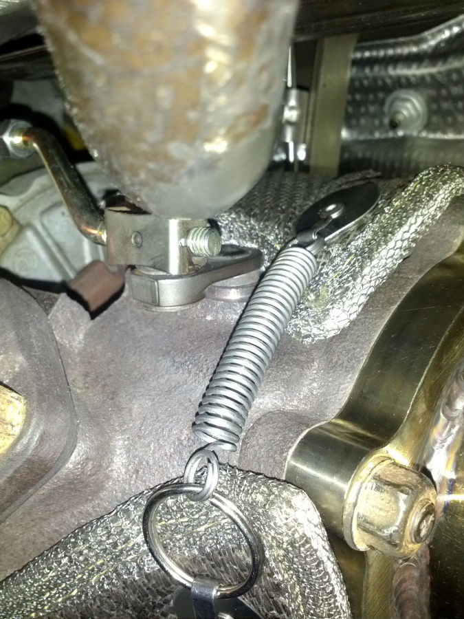

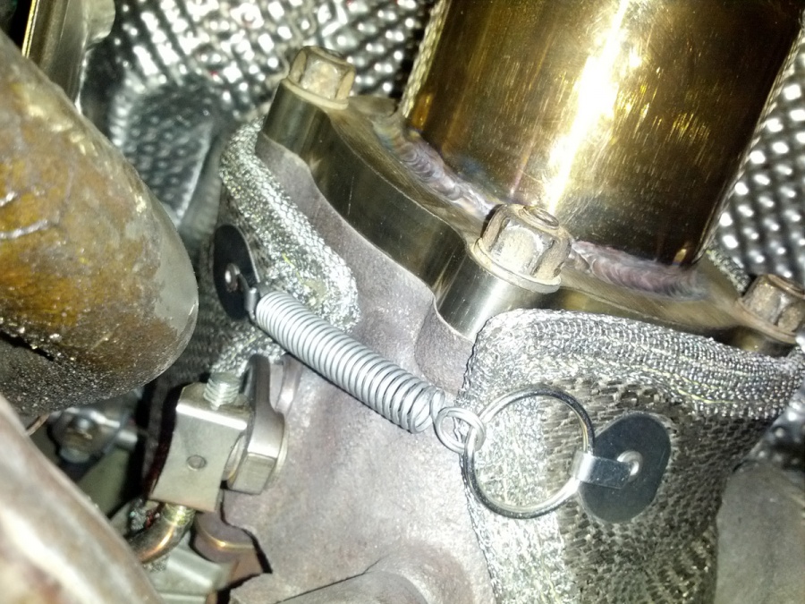

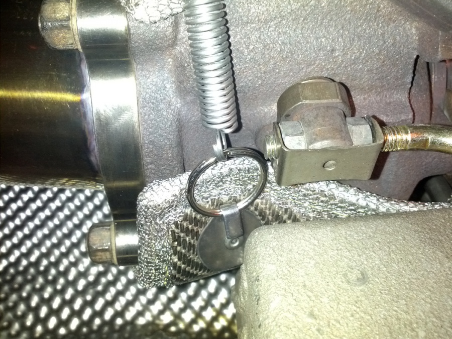

Does anyone have pictures of these installed on either the K24 or K16 turbos?
Any assistance on the proper way they go on would be most helpful.

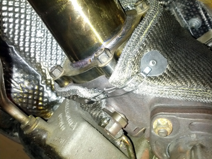

I played around with them for about an hour, and the only way they seem to fit puts the connecting spring in the path of the wastegate flap. Perhaps it is something simple I am overlooking.

Here are some pics. I put on the header blankets too. If you call Greg or Mike on Mon, I bet service will be good.

I finally hooked up with Mike this past week. He said I had the blankets on correctly and the wastegates open with enough force that the springs should not restrict them, but he suggested if I still had concern, I could replace the springs with safey wire for better clearance. That is what I decided to do.
I have put about 50 miles on the car after installing them this way, and no issues so far with the wastegates getting hung up.
As far as the product itself, when the car is warmed up, there is a slight improvement in spool and overall turbo response. Cetainly nothing dramatic, but every little bit helps on K24s.
Thank you to Mike@IPD for getting it all sorted out.
